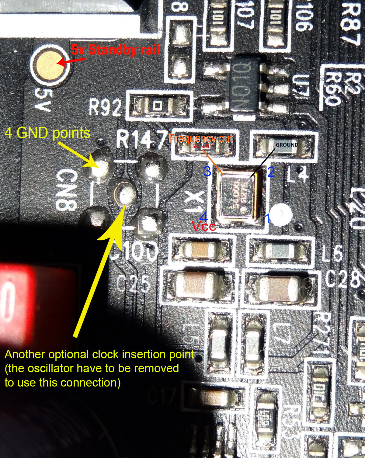

Well, I may say there is a little bit mistake about the instruction in this picture. I will use the opportunity now to correct it.
There is not necessary to remove the oscillator to use that clock inserting point. It is enough to remove the R147 and R92, which are actually 0 ohm components.
With R 92 in place the clock signal it is send to the multi-channel board too. R147 it cut the output signal from original oscillator. Removing both 0 ohm devices, the marked inserting point become fully isolated from the rest of the circuits, and it can be used for inserting the new clock signal.
Please keep in mind that doing like described here, the oscillator it still be powered and it output HF signal. To power the oscillator off it is enough to remove the L4 ferrite bead.
It is a clue to keep the original oscillator on board, for undo purposes, if something goes wrong while experimenting. For a definitive tweak in this area, one can safely remove the original oscillator. However, the R92 it have also be removed if the multi-channel stage is not used, and for a full isolation of the indicated inserting point, from the rest of the circuits.
Cutting the trace in between R92 and the inserting point (CN8), one can keep in function the original oscillator, to clock the multi-channel stage, while inserting into CN8 a new clock signal for stereo DAC...
