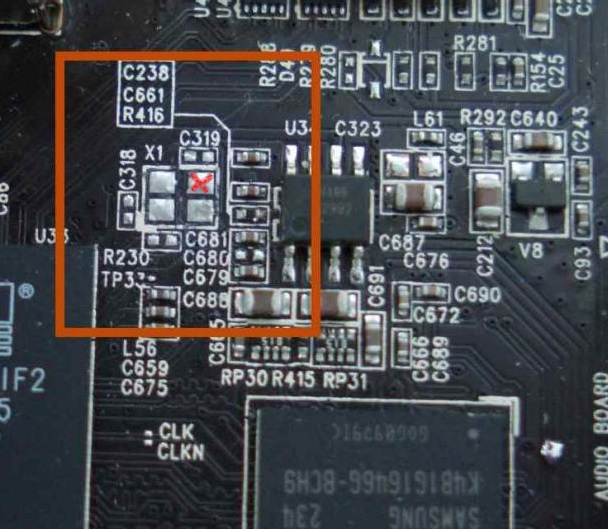

Okay, I have gotten the clocks almost replaced, but I pulled off the clock in pad on the 20mhz X1 :mad:. Where else can I use for the clock in?
Joined 2009

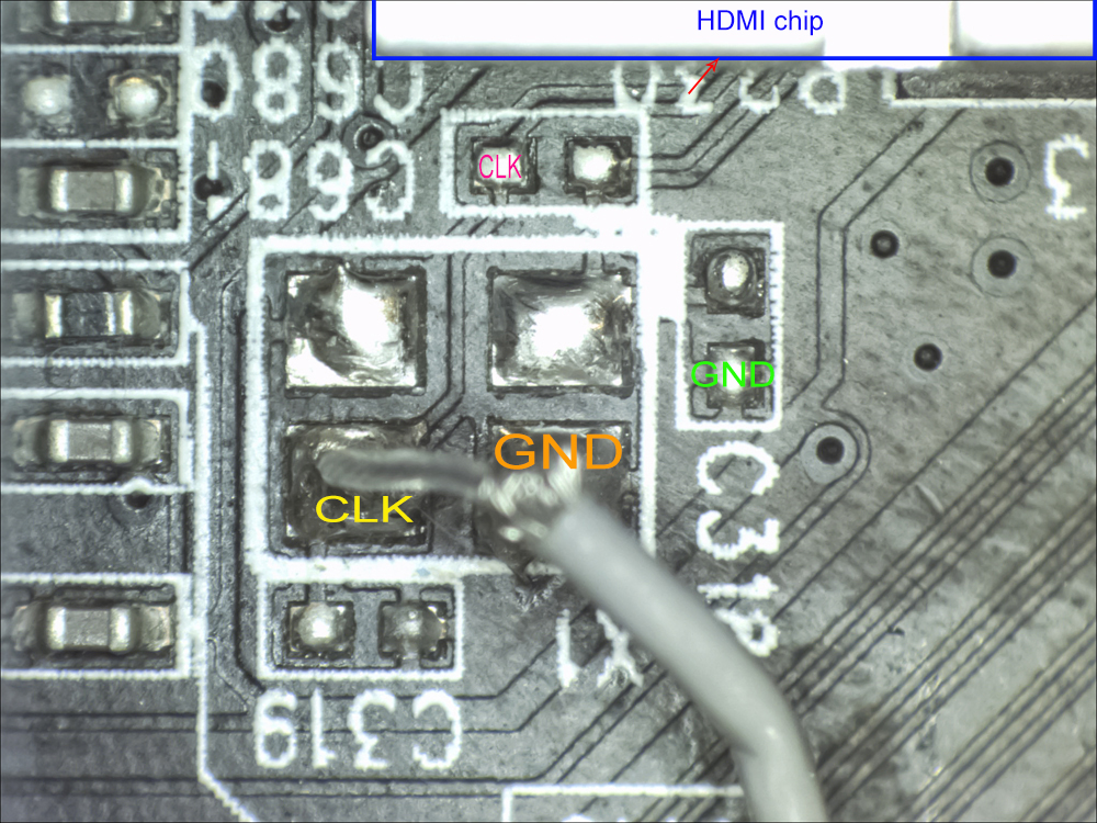

Well, a such component replacing is not just a risk free operation... At least, replacing the original resonator with a oscillator, it involve some other changes on the PCB clock area, as some other risks, if a such modification is not well prepared, all points of view...
I will use the opportunity here, to remind to others who may proceed to this mod, that the easiest way to remove the original resonator, is to put the soldering iron right on the resonator (it will be of course destroyed, but who cares...), wait until the solder it melt under it, and then remove it at once from the place on a side (in same plane with the board), but not lifting it right up. The copper pads on this type of PCB are very fragile, and very easy to disclose it. The PCB is not meant for rework purposes...
Together with the old resonator, one should also remove the caps and resistor around it, as seen on the picture here. The two clock traces going into the chip, should not have any component connected to it, before injecting the clock signal from a oscillator, in one of that traces.
For safety and more protection for the HDMI chip, I will suggest to AC couple the oscillator to the clock input pin of the chip. This it mean to inject the clock signal through a (SMD) cap, and separate the eventual DC level of the oscillator output, from the clock input pin of the chip. So, only the clock frequency it will goes into the chip.
When the mod is done so as you did, it is quite difficult to introduce a so small cap in between, in the signal path. However, such protection is strongly recommended, as one do not know the details about how tolerant this clock input it may be. Mainly this input pin is meant and designed to have a resonator on it...
I assume the picture here is clear enough to well show the PCB details. The clock area should look like in the picture, before installing the new oscillator in place, or connecting the coax for clock signal.

I assume your idea is (or it was) to solder somehow the oscillator on the board, using the old resonator`s useful pads. This it could be a good idea, but in your case, doing this only once, and not knowing for sure how it will works finally, I will suggest you to solder somehow the oscillator in a vertical position (on its longer side) on one of the GND pads available. This it may not be a just right position for the component, but it will give the possibility to experiment, and/or it will allow a make easier the rest of the connections around. A very short and very thin solid wire from oscillator`s output to the clk input of the chip, it may be one needed connection. Then a wire from the Vcc tab of the oscillator to its power device, it may be the second one. This wire should be quite flexible, thin and it must be well glued on the board very near to the "construction". It is also better to insert a (at least 1k) ferrite bead on the Vcc line of the oscillator, right on the connection point to the oscillator. You may not forget a necessary (also very small cap) between Vcc pad and GND pad of the oscillator (right on the pads).
I will suggest to introduce a small SMD cap (ceramic 1n) in between the oscillator output and the clk chip input point. Definitely it should not be used byger components here (cap or ferrite bead), but the smallest possible for you to manage with, and solder it.
If after all is finished successfully, and no picture on the screen, then do not despair. The output level of your oscillator it may not match with the input level for the clk pin of the chip... If such (unhappy) moment occur, then you should try to find the right clock signal level to make the chip to work as it should. In such case you should have some measurement devices to know quite precisely what about you may have there, appreciating how to adjust it for best fit...
Let`s hope it may not be actual a such scenario, in your case...
