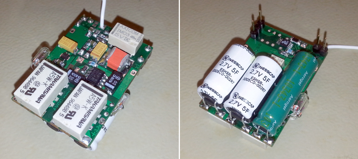

The second version of my AVCC PSU (large decoupling/filtering caps).
It have now visual signalizing for power good (AVCC ready) on power ON sequence. When the indicator get off then the AVCC is at its right/stable level.
The same indicator it will light at power OFF (caps discharging sequence).
Input for PSU: 4,8v - 6v (previous regulated, in this case the original AVCC rail modified for 5v out).
Outputs: 1,2v fixed (LDLN015/6F), adjustable 3,3v (ADM7151/2,5F)
The relay input of the PSU is to be connected to 5v rail for the digital stage of the device. Discharge circuits protected by resettable fuses.

In my opinion it may not be advisable to go too high in the values of these supercaps. There are some disadvantages when using too high values. First is the increasing of charging time, and also discharging time... Second it may come the too big dimensions of these Farad capacities, and then it may not be significant improvements for the PSU functionality.
Hopefully it works well to power this way the ES9018 analogue power rails, but the quite long charging/discharging time is the biggest problem when using such capacities...
When the PSU is connected into the player, the charging time is approx. 40s, and discharging time a little bit longer (around 1 min). Mainly the charging/start up time for this PSU is defined by the current limitation mechanism of the previous regulator stage.
This PSU must have a pre-regulation stage before it, only for current limitation purposes. Else its start up current pick it reach up to 1,6A...
