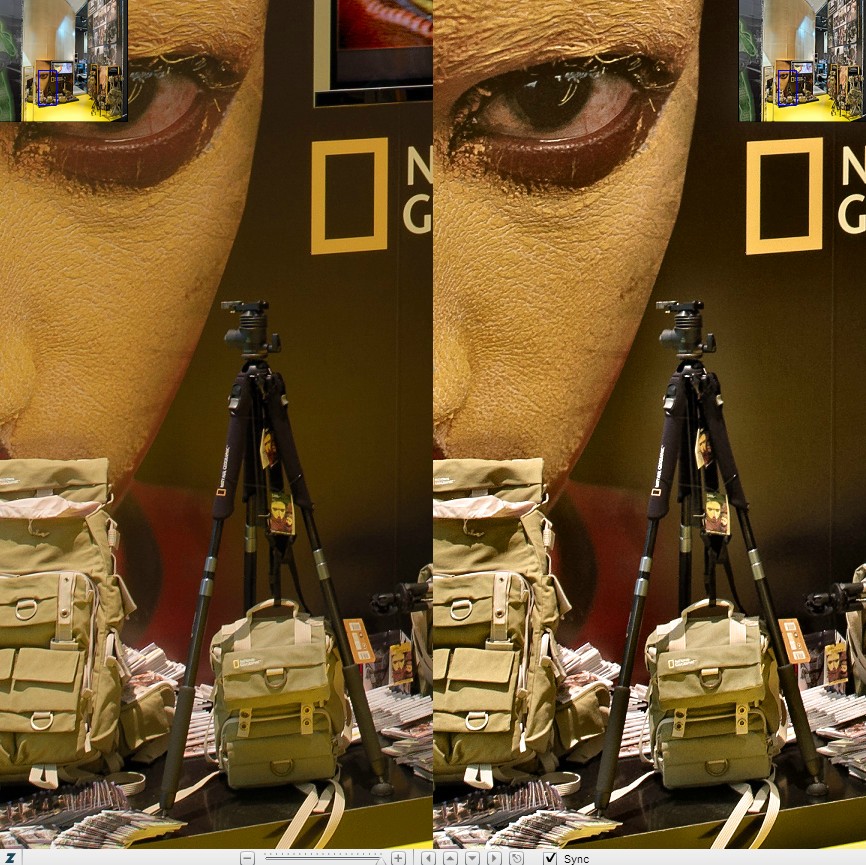

Interesting that you should say it, Darbee, works on stills as well. The 'local contrast enhancement' is a technology that has been available to digital photography post-processing.
See attachment.
Cheers, Joe
See attachment.
Cheers, Joe
Wow, that looks pretty good to my eyes.
...That still picture there, that and that only, and do we know the exact source; from a Blu-ray disc, a DVD disc, a video file, satellite, cable, etc.?
And how much post-manipulation has been applied after the fact?

There is quite strange for me that someone may appreciate such manipulated and obvious distorted still picture after a Darbee processing.
I have being myself in photo world for a good while now, and I`m enough experienced with photography processing, and so on, but I will never accept a so rough manipulated image on my displays. If is this what mean Darbee "improvements", then this will never be something for me.
In motion pictures these rough image manipulations, sharpness increasing and contrast exaggerations it does not looks for a viewer so bad, because the fast changing in picture composition, or a distributed a attention on many other fields. But on still picture this is really bad!
I will never want or pay for such...

If you know how Photoshop works, then you may not have so much trust in what you may see around as demo pictures.... specially on web, jpeg compressed, low resolution, and all that to reduce the picture digital size...
I can not pretend that I`m an expert in Adobe software, but I could for sure do a better looking "demo pictures" to be showed on Darbee web site...
But OK, this is a quite subjective subject to be discussed for ever. Everyone have his own ways to appreciate or not things, and at least this is a thread about BDP105 Oppo player.
