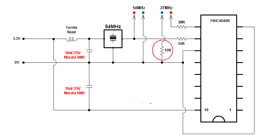

PART FOUR
SAW CLOCKING & DIVIDER:
Two clock frequencies are required and they are 54MHz for Sabre DAC (can be up to 100MHz per datasheet) and 27MHz for the "Master Clock" on the Mediatek chip. Note that they are 2:1 and that means we can use a single 54MHz SAW oscillator for direct input to Stereo DAC (and via balanced buffer drive to Multi-Channel DAC) and using a divide-by-two ship to produce the 27MHz.
Schematic:
(Note that 10R in the return for 27MHz - without it you may risk increased player freezing.)

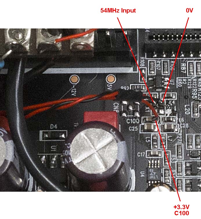

On the Oppo's Stereo Board, only the old 54MHz oscillator must be removed and three wires from above is wired to it:
As shown, we will be using the existing +3.3V clock power supply for the Sabre DAC clock after removing the existing oscillator.
How to wire the 27MHz is shown earlier on this thread.
NXP 74HC4040N (90MHz) Farnell/Element14 Part # 380-880.
Of course, Oppo could decide to use two separate SAW clocks, but they would need a decent power supply for the 27MHz and also ask Epsom Toyocom if they can make 27MHz SAWs (the lowest they have made so far is 50MHz) and if not, use 54MHz (which still has to be custom ordered like I did, but in large quantity and using two of them per player, the cost is negligible) and 2:1 divider.
Incidentally, Oppo could be attracted by the thought that we have people who say they also see an improved picture quality when using decent clocking here, rather than a cheap 27MHz Xtal. They could also order them in a smaller form factor than 7x5mm we have.
COST: The added cost, if any, is likely to be very small and possibly nil.
Next: Part Five
Schematic:
Next: Part Five

Nice work Joe! This is a real contribution, I may say...
Just after reading your material posted here, I have two comments: I (personally) do not like long connections wires, even though it is twisted...
The other comment is about the clock frequency used. Is right that 54 Mhz it fits very well to be divided to get the clock for processor. But also the 108Mhz frequency it is dividable to get the 27Mhz clock... It is very known already that ES9018 act better (asynchronously) when about a higher clock frequency. The chip work like a charm at this 108Mhz clocking... I think one may forget such frequencies as 54Mhz, or 80Mhz...
I agree, but for the sake of the exercise it was done this way. In principle (and in reality), the idea of generating a second clock frequency, this technique does work. As you have demonstrated too.
I doubt that Oppo would do it this way, I suspect they will stay with separate clocks/oscillators anyway. But they must get their act together and see that the 27MHz should be as important. The power supply improvement used in the '105 over the '95, for the Sabre DAC, should be at least duplicated for the 27MHz, and not just a cheap Xtal.
We have to look at Oppo's past practices to predict what they are most likely to do.
I believe you it works, but I can assure you, as a manufacturer, Oppo is not going to use 108MHz in a new Oppo - unless of course E.E.S. can assure Oppo it can be done. But I think that in reality 1) Oppo is not going beyond the 100MHz maximum for the Sabre DAC and 2) they will most likely want to do them separately. To bring that signal down from the Stereo board would also require a balanced line driver they use for the multi-channel board, to maybe make it work. No, I can't see them doing that - they just have to make sure they get that 27MHz right with no Xtal, decent supply and may be get Epson Toyocom to make a straight 27MHz SAW (or if not, only then a divider chip with 54MHz).
I have come across a link that indicated that some other manufacturer may go as low as 30MHz, as lot closer that the lowest listed 50MHz by Epson Toyocom. Doesn't mean a quantity carrot might not interest them.
