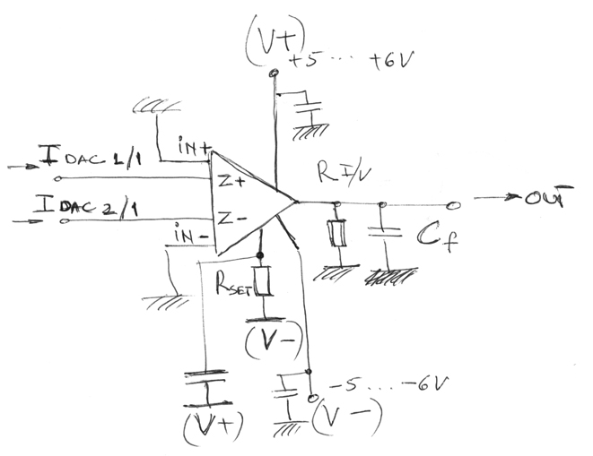

Circuit operation, where do we start?
The Input from the DAC: The internal Z of the DAC is 781R per phase. The OTA has two inputs '+" and "-" and these are asymmetrical. The "+" is very high input Z and "-" is very low Z.
If we keep R1 and R2 very low, say 10R or lower, then considering the DAC's relatively high Z output at 781R, we will definitely be operating in "current" mode.
But note that the DC offset on both of the DAC's phases are +1.65V, so the small value of R1 and R2 basically means we are grounding the DAC's outputs. This means that we will trade the +1.65V offset voltage for 2.1mA offset current.
IF A DAC HAS AN OFFSET VOLTAGE - NEVER GROUND IT LIKE THIS - ONLY THE SABRE DAC !!!
If we could get R1 and R2 symmetrical (this requires work to sort out), then in theory the DC on the final output would be zero Volt. But the Elna Silmic coupling capacitor will need to be retained for simplified manufacturing purposes and for the safety issues that made Oppo use them in the 105.
But for us: We can eliminate the C4 Silmic cap manually later. The good news is that the DC will be able to be nulled by us DIY guys and those who work on other people's players. The solution should prove the simple addition of a trimpot. But such a solution is simply not practical with the stock player. We can make ours completely DC coupled throughout!
Now please note R3 - this is where the OTA's current is dumped, so the gain is set by this value. The signal that appears across R3 is now buffered to the main outputs.
It is clear that the balance of R1, R2 and R3 is what will set the output level to 2.2V approx. It is expected that R3 will be in the range of 22K.
The output of the buffer stage is current limited by R4, a suitable value should be 220R. The buffer can swing 8V p/p into 220R safely. Please note that the Mute shortens the output, but of course the DAC also goes into Mute, so this is a double-safe device.
The final R5 is just a grounding resistor, value not critical and 47K seems to be commonly used here.
Now for C1, C2 and C3. These are of course used for passive filtering. The C1 should be the dominant pole. That means it is the lowest frequency. This C1 does indeed affect the sound and its value should be chosen after careful listening. Something like 0.33uF is in the ball-park.
The next C2 is a pole that is somewhat higher, but likely value is 33pF or 47pF.
The final C3 may well be optional. Together with R4 (220R) this forms what I call a "Ben Duncan" filter, since he was the first one that I saw use it. Typical value may be 470pF.
The only value not discussed is R(i) which sets the current in the OTA, the likely value is 180K-270K range.

I think the idea Joe shows here is interesting, and it deserve a closer look. Why not try it?
LM13700 is a chip which it may do this job... I chosen it only as example of such circuit types. I do not mean that one may use exactly this one...
I personally can not find something wrong with Joe`s didactic way to explain the concept. But I could notice the suspense aspect of the coming "news"...

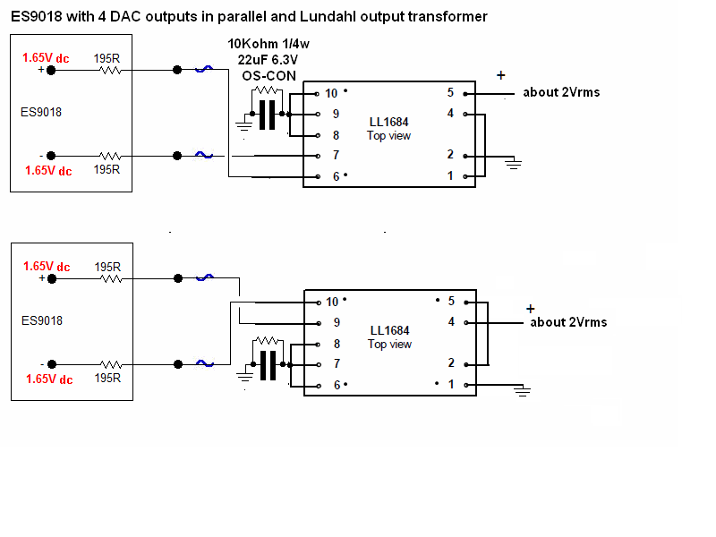

Using transformers, see Buffalo II & Transformers - I have no financial gain to make for contributing on a forum that promotes Russell White's Twisted Pear Buffalo DACs, zero gain.
If you are using the ES9018, then try this and this the result one user had.
But have you had any experience with Sabre DACs at all?
If you do, note that it's high output Z makes it less than ideal with transformers, and paralleling up all four phases is a must and when dual-mono Sabre DACs are used, then at least (with 8 phases) you can get the source Z into the Primary below 100 Ohm. Indeed, a number of people I know don't like the Sabre DAC they heard, and when we investigated it, they had voltage mode in common. The comments were "glary" and "tonally light and bright" - and my suggestion of pulling the DAC to ground can only be done with the Sabre DAC, and then it sounds rather differently. Among other things, the BASS now appears in balance. Body and fullness that was missing in voltage mode.
BTW, in the Oppo 105 and like future designs, we have only a single phase - 781 Ohm. That is per phase and totals 1562 Ohm into the Primary of a transformer. Now, you can see WHY Oppo will never opt for transformers.
You seem to think that I am against transformers, but that is not the case. I have used post-DAC transformers for 15 years, I have even had some custom made. Like you I have also used AD811 as I/V Converter, and that was TWENTY years ago with Philips 1543A DACs... yes, I have been around for a while... maybe too long...

The main advantage of an OTA is it's programmable transconductance, and that's about it. An OTA is basically less accurate, less linear and also exposing a temperature drift that can not be compensated for. The circuit will sound inferior to simple, natural presentation obtained from either the transformer based stage (with SABRE), or with AD811 (with 1704's). The most annoying problem was the change in sound character as the DAC enclosure warmed up. The change is subtle, but it is detectable.
The transformer solution you are suggesting does not take in to account the reflected impedance of the interconnects / pre amp on to the primary impedance “connected” in parallel with 2 X 330 ohms resistors.

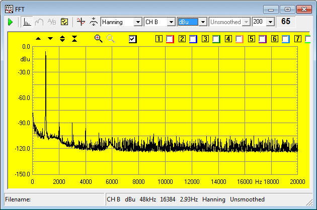

BTW, I don't want to pick a fight with you, but you have said elsewhere that OTA produces 1% distortion, specifically the AD844.
I can happily verify that it does not - with an actual measurement, see attachment.
THD 0.08% and THD+N 0.028% - this is from a test disk -20dBFS.
No feedback at all.
Please also look closely at the proposed schematic and the accompanying text where proposed values were shown (which I suspect are going to be very close in the real-world). So really did lay it ALL on the line.
I was surprised nobody has guessed the active device, OPA860 (alas the 660 would have been preferred), as there were a number of clues. By the next post, ALL that I know has been revealed.
I hope Coris will also build this - so EVERYTHING will be on the table. It may never even get into an Oppo player (other than mine here), but so be it.
Cheers, Joe
PS: Note the change in my Signature below, never desired to offend anybody.
PPS: Please note, this may all turn out to be a monumental failure and not work out at all, and what has been posted is there to stay - so I will have to wear it. But sometimes you have to be brave.
I also was a little surprised that no-one guessed what the active device was, as there were quite a few hints, that I was referring to an 8 pin SOIC, readily available (I just bought 10 from our old friends in Chester Hill) and nexpensive, that it was a major American chip manufacturer, in fact Texas Instruments.
I thought it would have been guessed by now.
It can swing 8V p/p from 5V rails and hence can supply the same output as the ES-9018 with some additional headroom. Need to aim for 2.2V RMS.
The device is indeed OPA860 - descendant of OPA660 - and yes, it is not as good on paper, as Charlie Hansen has pointed out re the Buffer section. But the OTA I understand is fine. The Buffer is the question mark? It is closed-loop where the 660 was not. But limiting the bandwidth on its input will help - so it is a compromise, but I think it should be tried. The wide bandwidth of the Buffer (4000V/us) indicates current feedback - a la AD811 - and then maybe not bad at all. But it is what we have got and the OTA will still be zero feedback.
(Note 220R limiter on the output as discussed earlier, so swing up -1V of the rails is a given.)
Since we know that the ES9018 operates of 5V (in two phases) to give about 6.3V output, we can match that and with some headroom with 5V rails used in the OPA860 (just wish we could have 660 in SOIC).
