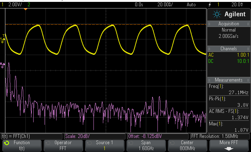

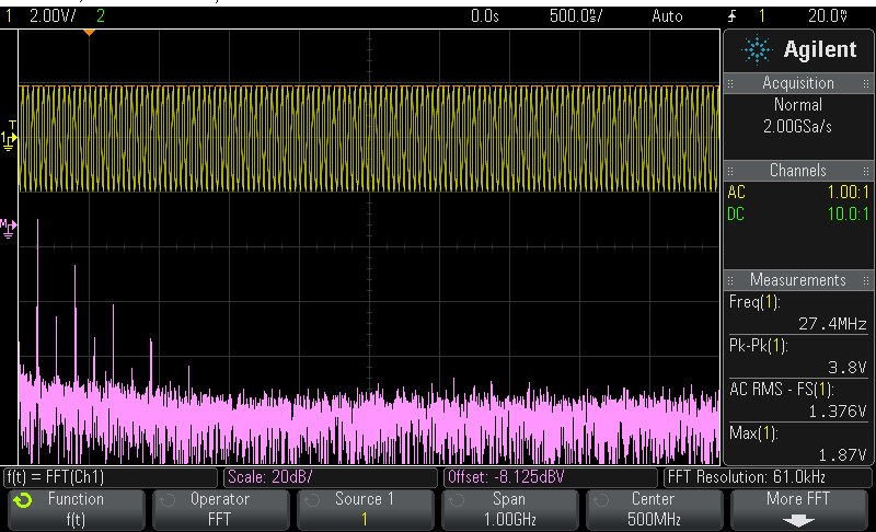

Joe: I'm curious if you are planning to try your level 3 Mod on the 103 as well.
I can understand that question.
The 103 only has one clock, So Level 3 (double-clock) doesn't really apply. but you can SAW the Master Clock (single-clock). Only the 95 and 105 has an additional clock on the DAC.
So...
That 27MHz in the 103 can now be done with a single SAW - so that makes it Level 2, I suppose..
There is not a huge difference between the 93 and the 103. Just over a week
ago, a client his back to get the 25/50MHz SAW fitted. It certainly took quite a jump in performance. It gave it some real wow factor.
I know I may be preaching and most are not listening, but I am convinced that SAW clocking is the way to go. In Malaysia there are some who have been listening and tried it with the Buffalo DACs as an alternative to the Crystek 957 oscillator. But the more you listen, the Crystek is soft and diffuse, whereas (and even more listening just confirms it) has a certain "rightness" - it just is so solid. Certainly the Bass is better and so is the sense of involvement you get.
Cheers, Joe
