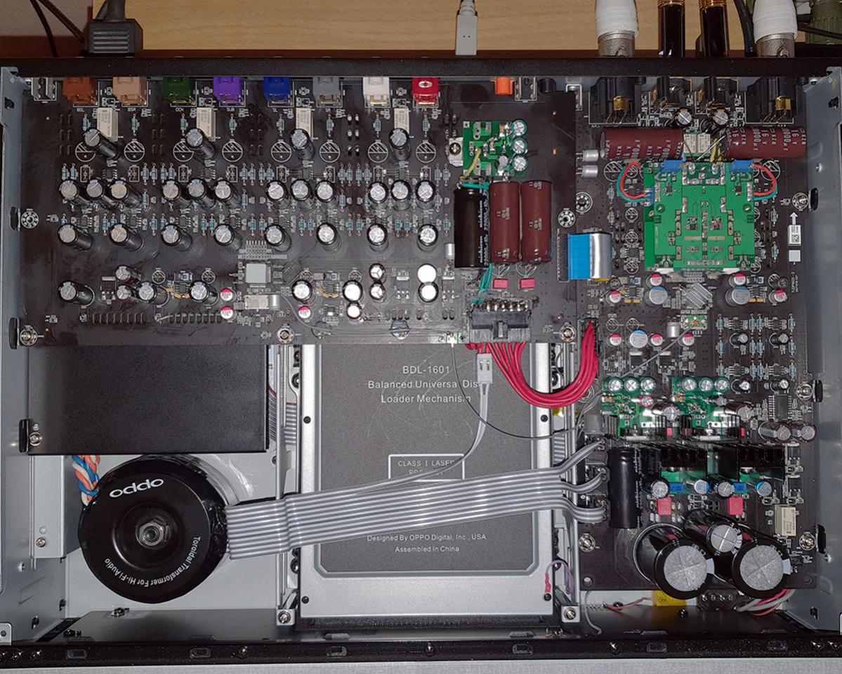

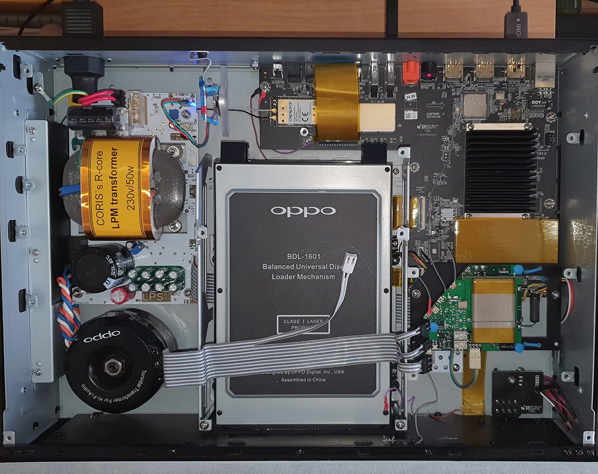

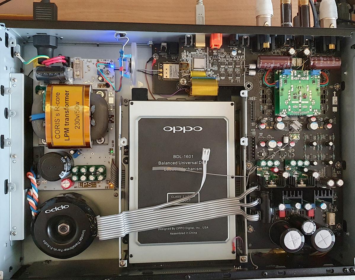

My last version full upgrade for UDP 205...

Yes, I had similar impressions as well.
The main issue of this device is the power system, for both digital and analogue sections. First of all, one should replace the original SMPS for digital section, with an LPS. This is the first step and most important to lift up the overall quality of the outputted signals, for both sound and picture. Then the analogue power system it need to be corrected quite much to improve the sound. The third step is improving the clock system of the device, which it add more quality improvement. Last step is eventually replacing of the components/opamps in post DAC signal processing stage. Even with the original components in analogue stage (after DAC), the player it sound quite good, with the rest of the upgrades in place.
These are the main directions, but the full upgrade in detail is a quite laborious work...

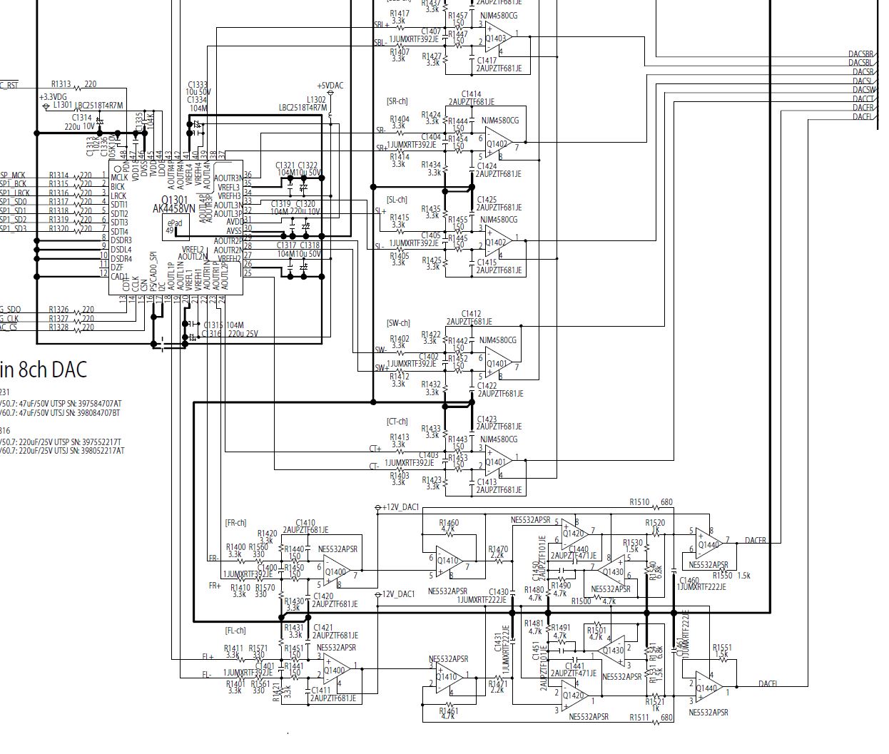

I read with interest the post by Coris on 11 Jan 2020 concerning the DAC Board 203. I had found it interesting that there are AC coupling caps between the AK4458 DAC and the OpAmp stage, this is interesting because the RZ900 also uses the AK4458 DAC but it does not use AC coupling caps (see image of the RZ900 DAC and OpAmp stage below).

When about post DAC opamp stage in these two devices (Oppo 203 and RZ900), please note that are some design differences. Oppo have chosen a more simple way to treat the 2,5v DC offset at the AKM chip outputs, by using AC coupling caps. RZ900 it use another way. Also another (better) way is using a fully balanced opamp connected directly to the DAC output. I use this solution for my balanced (XLR) stereo added module.
As the original Oppo design of 203 audio board is, the AC coupling in between DAC outputs and the further opamp stage, is necessary. There is no any service manual or schematics for any Oppo devices available out there...
OPA1612 it may be a good choice for replacing the original opamps on 203 audio board. Easy and good results... Well, the rest of the improvements on board may be necessary as well, for an overall audio quality lifting.
Also please note that the use of transistors mute circuits on audio 203 board, it make necessary the use of a second AC coupling stage at the opamps outputs. I appreciate this double AC coupling approach as unfortunate...
