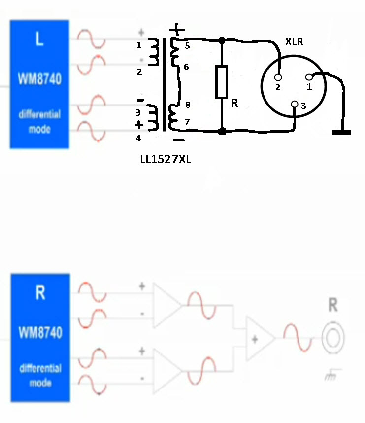

Amended photo
Hi everyone, this an updated photo of the PCB. I have corrected some of the labels and added an idea for a modification.
Amended parts list
Hopefully I have corrected my mistakes :eek:

Idea for modification
I don’t use the USB input and could probably use a third 24/96 bit input on the DACMagic. The 16 bit USB suffers from jitter and would need a lot of work to approach the quality of the other 2 inputs. As an alternative why not split the optical and coax input for digital input 1, so optical 1 replaces the USB input? This gives an extra 24 bit input?
In theory (I haven't tried it myself!) the modification would be along the following lines. Cut the underside PCB track from U23 pin pin 8 to U7 pin 5. Cut the track joining optical 1’s R16/C201 to U7 pin 3, connect this to pin 5 instead. Then connect U7 pin 3 to ground. I think these changes separate OPT 1 and COAX 1 so both can be connected.
The photo I posted today shows the basic idea in red. Optical 1* replaces the USB input. If it works, the three switchable inputs become OPT1, COAX1, and OPT2 or COAX2 depending which is connected.
* I think the schematic labelling of inputs 1 and 2 may be the wrong way around. U5 is optical 2 and goes to U7's 1-IN2, similarly for coax in 2 going to 2-IN2.
Yes.
Ok, except I would connect U7 pin 3 to ground through a 100 Ohm resistor, to prevent parasitic oscillations. The mod should work, AFAICT.

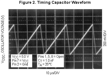

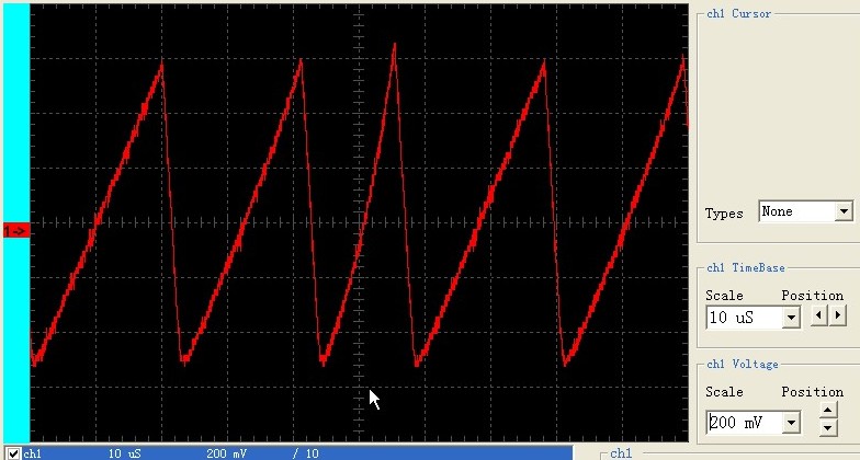

Get rid of noisy DC-DC switcher inside, make new regulator for clock supply, right now there are ripples over 100mV there :(

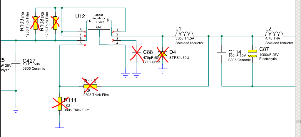

I assume you're talking about the switching regulator labeled U12 that supplies +5V to the clock and the DSP regs. Is it worth replacing it with a linear regulator? I've got a spare SOIC-8 Browndog just for the occasion...
On an unrelated note, I've installed Dexa regulators in the analogue supply and replaced remaining Xunda electrolytics with Panasonic FC/FM. The result is a major improvement in clarity, and perhaps the soundstage is a bit wider.
@gtx580m
Look at MC34063 datasheet. What is output ripple with optional filter?
Yes, "only" 40 mV in datasheet, but in real world there is over 100 mV ripple at clock and DAC chips.
You can play games with timing capacitor value & change frequency, but noise from MC34063 will be everywere. If your ears are good enough, you can hear L1 whistling with high tone :eek:

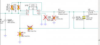

Alright, a newbie question. Will this work (see attached pic)? Crossed out elements are to be desoldered; U12 pins 1, 3, 5, 7 and 8 are left open.
If it was so simply CA has made so ;). But thermal emissions in that case make approximately 0.190 A x (16.5 - 5) V=2.185 W. To be necessary enough big heat sink for the linear regulator and where you will put it? And all it will be heated nevertheless.
Yes, Mihaylov, you are right. Whole power supply is a mess :D

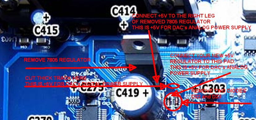

Bellow is picture how to connect two new +5V regulators for WM8740 digital & analog part.

Ideally we would have separately regulated supplies to the crystal/masterclock, the DSP, and the digital sections of each DAC. Plus separate low noise regulated supplies to each DAC's analogue circuits. So six 5V supplies and separate low noise regulated +/- 15V for each channel's op amps. It's a small warm box now and an external box would be needed for the supply circuits, as suggested on the previous page.
The existing power supplies are a compromise between space, heat and parts count/cost. Comparing to the power supply schematics for the CA740C and CA640C, shows what's been left out! But to be fair the DACMagic works reasonably well.
Retrofitting the extra supplies means a fair bit of PCB track cutting would be needed to split the connections to the different IC's. And some strain relief on the cables to an external PSU box.
We could make a smaller scale modification to the power supplies. There is dedicated 5V supply for the USB circuits with a 7805 regulator. If we disconnect the USB and put a heatsink on this 7805, could it be used for some of the digital circuits instead of the DC-DC convertor and its whistling inductor?
