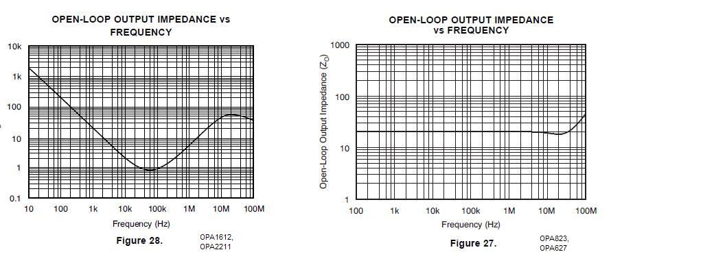

On another note, the decision to opamp selection should be based on the operational compatibility to the differential filter output stage (XLR out).
Hence I would be interested to understand what are the key spec requirements that we should be looking to match. Recommendations are most welcomed.
Also, by looking at the attached output impedances which one would be best suited for the XLR out stage ? shouldn't those different response curves be audible ?
