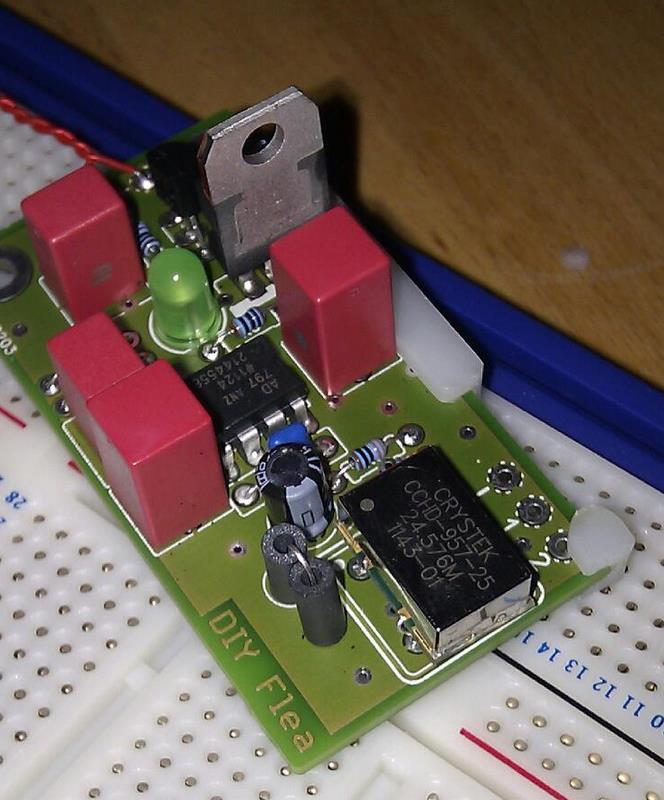

*Goal*: factory clock upgrade to flea clock
*Status*: Fuse blown , waiting for fuse parts
Not sure what I did wrong which caused the 2A fuse to blow hence I would appreciate some advise on how to proceed.

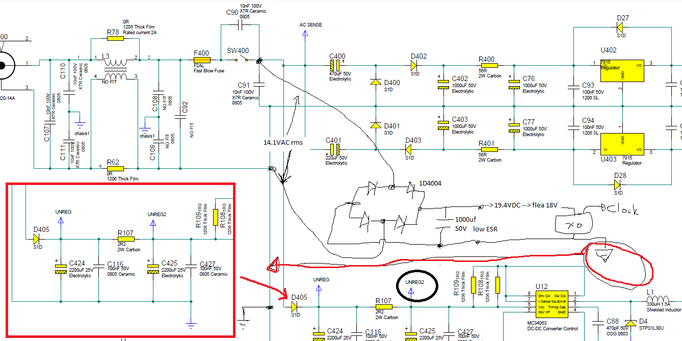

1) Following on Matiasro's steps I assembled the Flea board with the clock; tested the board with a 20V laptop PSU and all voltages were as they should (3.3V, 24.576MHz)
2) Decided to feed the flea from the 12VAC rail (14V RMS) and used a full rectifier which gives me +19.8VDC which is enough to feed flea's 18V min.
Tested rectifier + flea board and confirmed expected output (3.3V, 24.576Mhz)

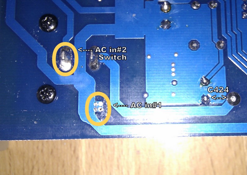

3) Opened DACMagic and looked for the 12AVC rail to feed the rectifier. I measured 14.4VAC between Switch and Ground rail (see picture AC#1/AC#2)
BTW I measured the factory Clock Vcc @ 4.8V, that is between FB5 and ground.

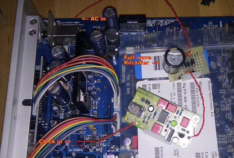

4) Removed "Interquip" oscillator and pluged Flea + Rectifier onto the board, with rectifier taking its VAC as per step (3) above.
Check connectivity and confirmed cable polarity between a) rectifier + flea and b) flea + DAC clock base
5) Powered up.... flea LED light came up followed, nealy instantly, by the FUSE blow up
Any advise on my approach especially from where to get the VAC for the rectifier.

I figured out the full-wave rectifier I introduced short-circuits 12VAC rails when connected the Flea XO GND to the digital GND, hence !!
I guess I should either a) isolate the Flea_GND from Digital_GND or b) just take the flea voltage from UNREG2/C425
re (a) any ideas ? would this work http://www.farnell.com/datasheets/11701.pdf assuming won't pollute clock with jitter/noise ?

For the Flea, I recommend that you feed from the input of U402 (7815).
That way you'll be fine.
