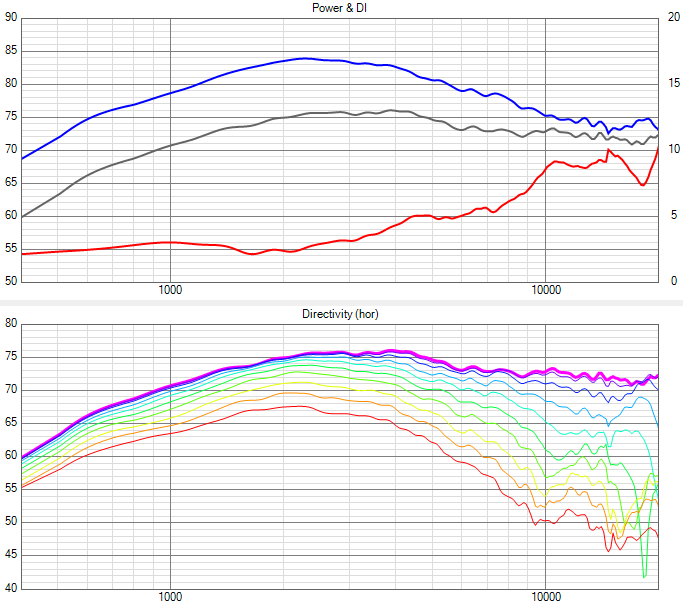

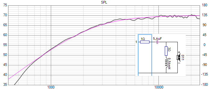

SS7000 RR in WG148R measurement in attachment, no crossover. Only series capacitor ~2uF is needed to achieve LR2 slope at 2500Hz.

I would expect at least ~93dB/2.83V/1m at 10kHz. Sensitivity usually does not change much above 10kHz with/without WG.
Update: I have to correct #186, I had wrong impedance file = > it is needed standard 2.order crossover configuration to achieve LR2 slope.
