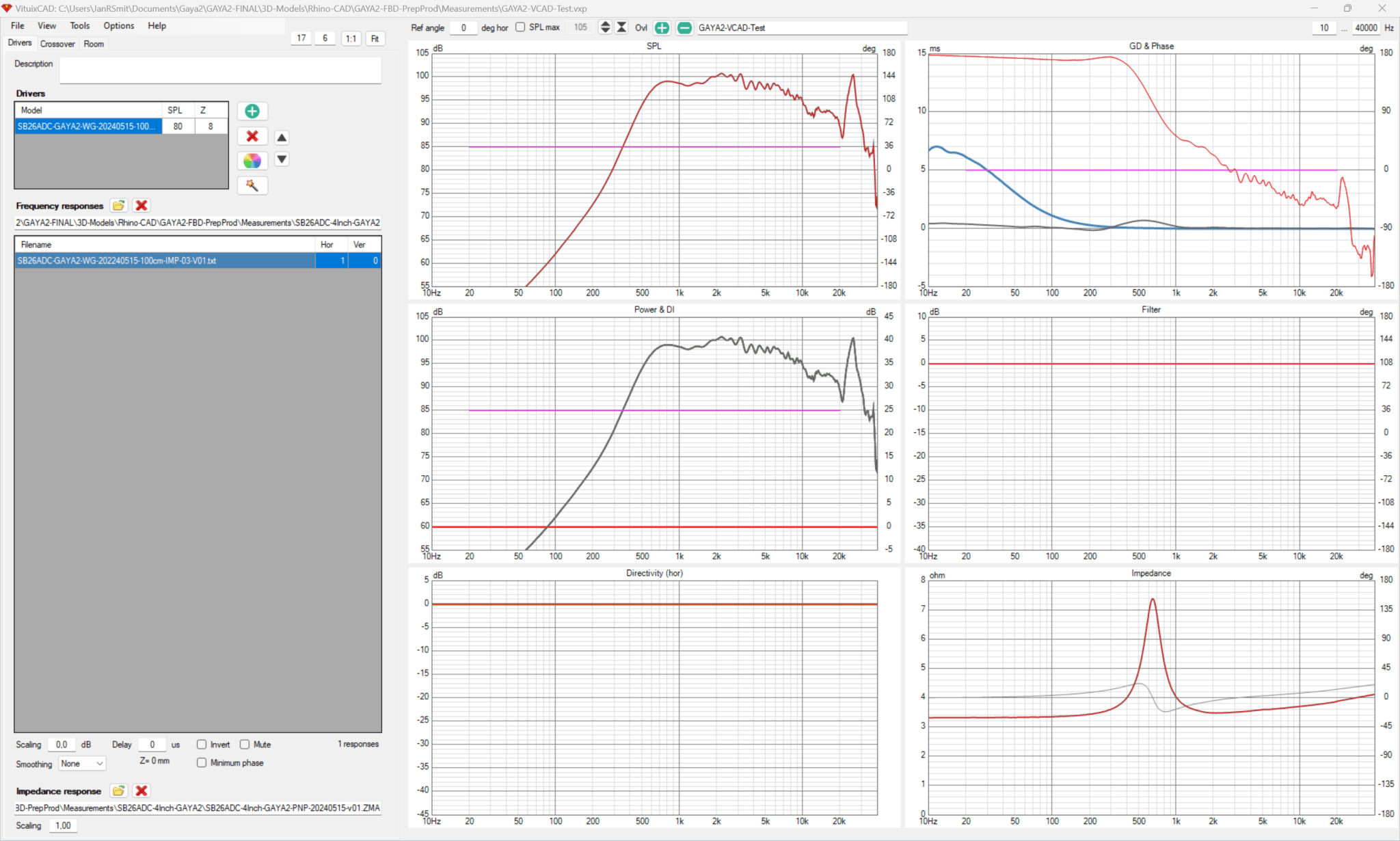

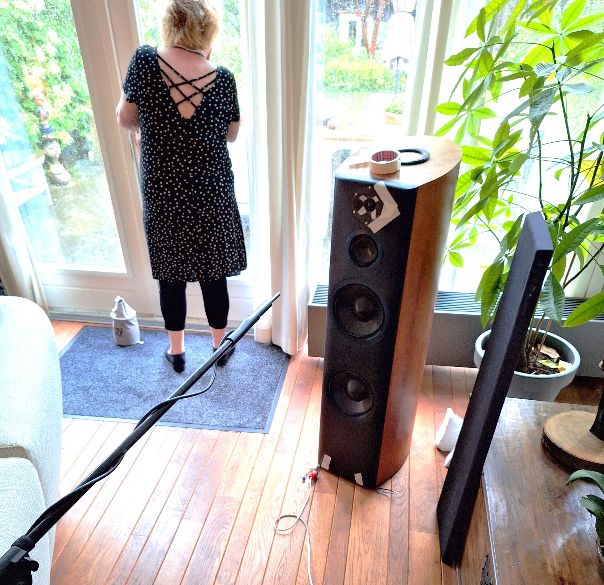

This afternoon a measurement session possible, primarely to check if driver mounting went ok.
Tweeter at 100cm, with mounting holes and edge covered with tape:
Serious spike at 28kHz, hump at res-frequency. But else ok.

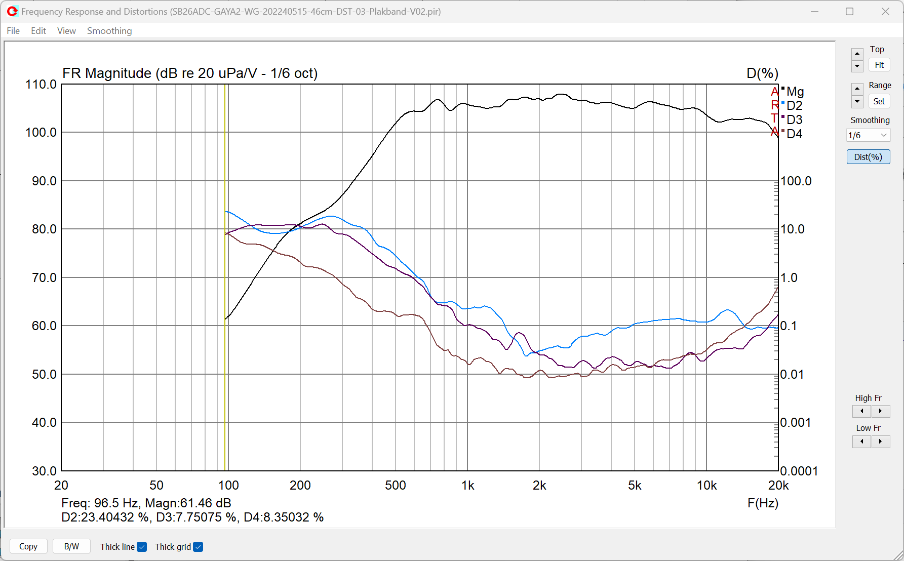

Distortion via ARTA at 46cm en 2,84Vrms:
Not bad ;-)

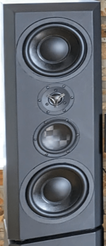

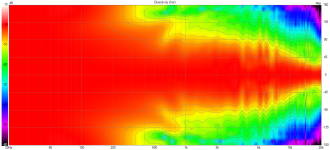

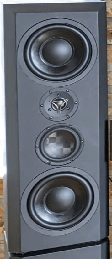

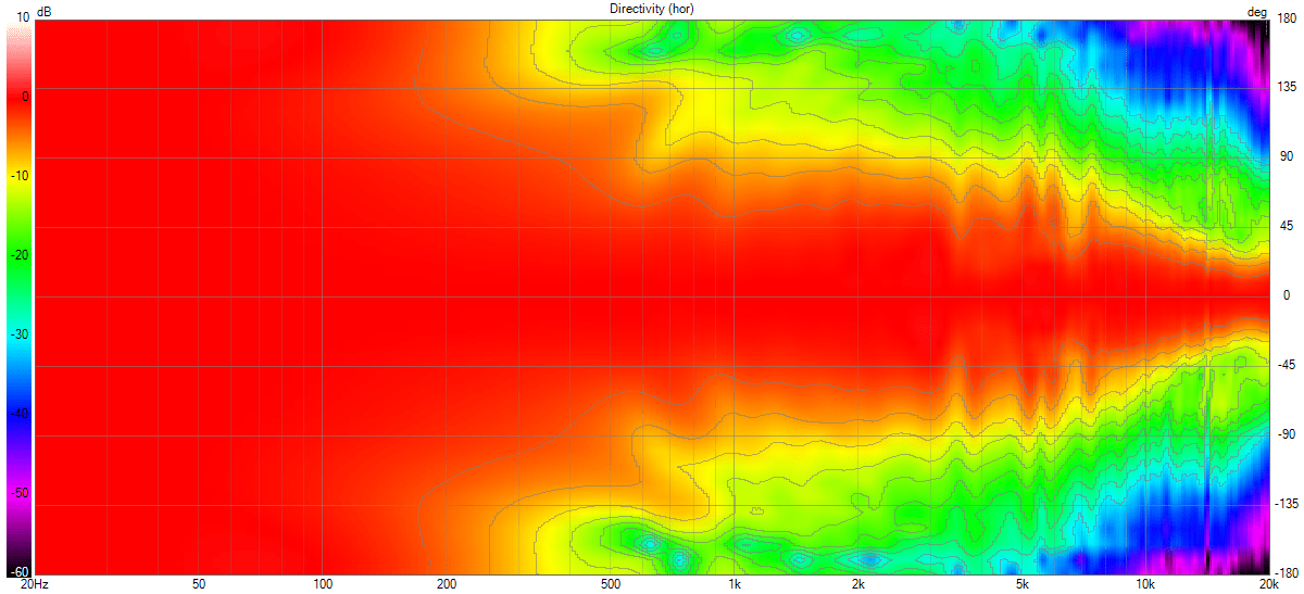

I built some active speakers a while ago and I wonder about the benefit of added the 4" elliptic with phase shield waveguide (4x.65 vB 82 ps) on my Satori TW29TXN tweeter. The 4" is the largest I could retrofit. My goal would be to have constant directivity up to ~15khz (instead of the ~7khz I get right now).
Could I reach my goal using this waveguide?
If yes, I am worried about damaging the dome while installing the waveguide, are there any special precautions to take? Sorry if this was previously answered.
Thanks again.
Speaker: TW29TXN, MW13TX, 2xPeerless 830667, Hypex FA253. See pictures for current baffle and current directivity measurement.
augerpro: I meant routing a new cutout in the actual baffle to fit the waveguide. The stock tw29tx is a 103.8mm circle, the 4" elliptic waveguide is 103.1mm high (121.4mm wide) so it would fit height wise between the mid and the top woofer. If I do this I will rework the crossover to match directivity at the mid/tweeter crossover point, I was wondering if I could improve the top end dispersion (above 5khz) with a waveguide that has a phase shield.
fluid: By eyeballing the hificompass compared to the somasonus measurements I thought the version with the phase shield would help a bit but it seems I should go with a different tweeter instead. I would eventually like to get a horizontal dispersion result in the top end similar to the Revel PerformaBe series.
Thank you both for your input, my understanding is that a waveguide will not help me get what I am looking for.

Waveshaping devices in front of the tweeter can help to widen the directivity at high frequencies but it needs to be quite heroic to undo the beaming that comes from the Satori drivers intrinsic shape. Lots of trial and error or relatively sophisticated simulation is needed to get the right geometry. The simpler solution is to use a tall dome in the right kind of waveguide. There aren't a lot of options that fit and some like the Bliesma T25A are difficult to get right in a waveguide. The T34A can be very wide and even almost all the way to 20K but the waveguide has to be quite large.

Having constant directivity is more about the driver and waveguide shape in the <10KHz range. Above 10KHz the phase shield can help. For example circular profile waveguides have a more gradual roll off as frequency rises while oblate-spheroid profiles have more of a shelf shape to the roll off. The big surround is the main issue I suspect, more than the fact the dome is shallow. IME shallow domes work well in waveguides, while highly convex or inverted domes are more tricky to play with a waveguide.

Constant directivity seems to mean many different things to different people. I would say that the flatter the DI the more constant the directivity is. Dome tweeters in waveguides don't often lend themselves to producing a flat DI naturally. This is of course a simplification and there are always exceptions and options.
A big surround does make harder as it increases the effective radiation diameter which is one factor. The old idea that a bigger dome beams more does have some truth in it, but there are other factors that can come into play to negate it. Tall domes are tricky in waveguides because they require a specific geometry to work which is often not where anyone starts. All of these things are quite easy to see in simulation.

The T25B is an easy driver to use in a waveguide. The small inverted surround and overall narrower diameter help to push the natural beaming behaviour up higher than occurs in the Satori domes without any extra effort. The dimensions lend themselves to a slighty rising DI in the waveguide being happy at +/-60 degrees nominal wall angle. To push the high frequency dispersion wider then it is waveshaping or the right shaped tall dome like the T34A.
