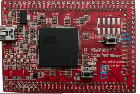

What I'm trying to do here is to simplify the test procedure for the AB-1.2 manufacturing and make sure both crystals do what they are supposed to. So today I created two wav files at 44.1 and 48 using Octave. They both play 1s 1kHz left, then 1s 2kHz right. So the two should sound the same to the test guys but play using different oscillators. That worked well with XP and UAC1.
Børge
A switch is PROGRAM?
B switch is RESET?
correct?

Juanito,
Here are some questions which may help to sort things out:
- Are you using an updated firmware version?
- Are you using UAC1 (green front light) or UAC2 (red)?
- If you open up the case, how do the red and green LEDs on the module behave?
I had similar problems a long time ago on previous firmware. In that case the module LEDs started acting up a little while before the audio imperfections started.
Børge
About the lights behavior: when I plug the mini USB to the DAC, first comes the red light then the red one. In 5 seconds or so the turn off in the same order, first red then green. Noise is still there.
