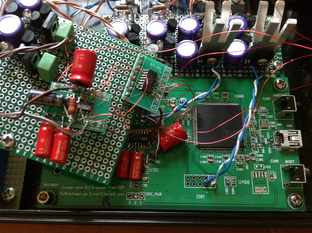

Please keep us posted and take some pictures of what you do. Also I for one am very interested in the effects of your capacitor changes, how would you describe the effects on the sound?
Thank you ElEsido. I ended cutting the USB cable since i read your message too late but is working fine so far.
I made a external source with lt1086 , some Mundorf caps and i can tell you , changing the original os-cons got me a lot of details in sound + bass extension, but now after external source a whole new world has opened full of micro-details, texture and flavor.
