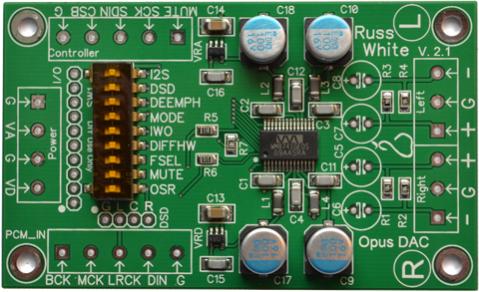

I've got 2 Opus DAC from Twisted Pear, one with WM8740 the oher with WM8741.
They are both working well 😉
So no PSU troubles or others.
My only goal is to fed them with I2S.

Hio Borges
Digging the WM8741 specs...
There is no clock, only a MCLK Input on the chip.
Clock are embeded with SPDIF and/or USB modules, same clock 12Mhz/16pf (HC49).
As I understand, Opus/WM8741 is a "Slave", waiting for a MCLK input.
BTW "USB Widget" is supposed to bring it to the WM8741.
Your opinion ?
The Opus Dac seems like it is built on a different philosophy - it is as you say a DAC in slave mode, where the AB1.1 board is the active party, which "pulls out" the bit stream with its master clock.
You would need to have a "clock board" in between the USB board and the Opus DAC to make this work.
Exactly, the Opus DAC board would replace the ES9023 DAC component on AB-1.1. Plus youæll have to supply the right kind of power to it. If it runs of 3.3V that too could be fetched directly from where the ES9023 sits. In fact, it should be possible to run the two boards in parallel if the load on the MCLK line isn't too high.
My suggestion to you is to start out with AB-1.1 and USB-I2S module, then patch in the Opus board once you're familiar with the signals already on AB-1.1
If this DAC gives better quality than the ES9023 I wouldn't mind redesigning the Analog Board at some later stage.
Of course, the sales guy in me says you should get two AB-1.1s. That way you can do an A-B test of the DACs 🙂
Børge

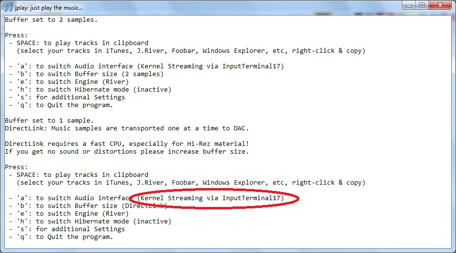

Back to KS mode again, how can we change the device description
Tried Jplay (http://jplay.eu), it's a really a killer running KS mode (with Thesycon driver)
The audio-widget appeared as InputTerminal17 (same as KS mode in Foobar), is there anyway to make it a better description (firmware)?
