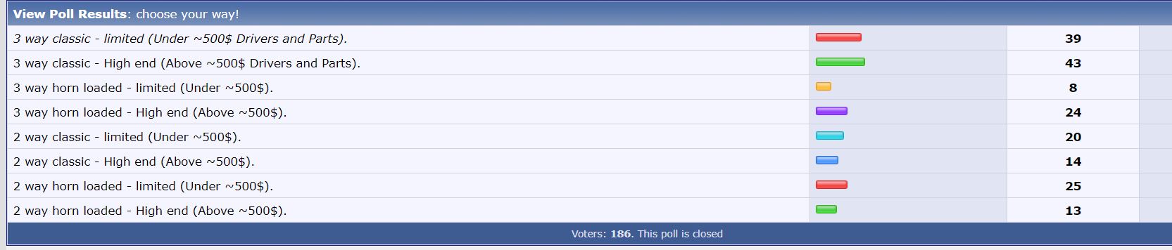

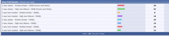

choose you way!
  • 3 way classic - limited (Under ~500$ Drivers and Parts)
    Votes: 46 27.1%
  • 3 way classic - High end (Above ~500$ Drivers and Parts)
    Votes: 50 29.4%
  • 3 way horn loaded - limited (Under ~500$)
    Votes: 11 6.5%
  • 3 way horn loaded - High end (Above ~500$)
    Votes: 28 16.5%
  • 2 way classic - limited (Under ~500$)
    Votes: 20 11.8%
  • 2 way classic - High end (Above ~500$)
    Votes: 15 8.8%
  • 2 way horn loaded - limited (Under ~500$)
    Votes: 0 0.0%
  • 2 way horn loaded - High end (Above ~500$)
    Votes: 0 0.0%
  • Total voters
    170

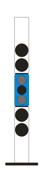

WW-MTM-WW narrow enclosure
I though this would have looked exciting in any audiophiles' home. For the woofers I had in mind the Tang Band's TB W5-1138 smf, each in a 10 litre vented cabinet could practically achieve very respectful low end performance, F3/F6/F10 in the 30 Hz zone, without any electronic aids.
