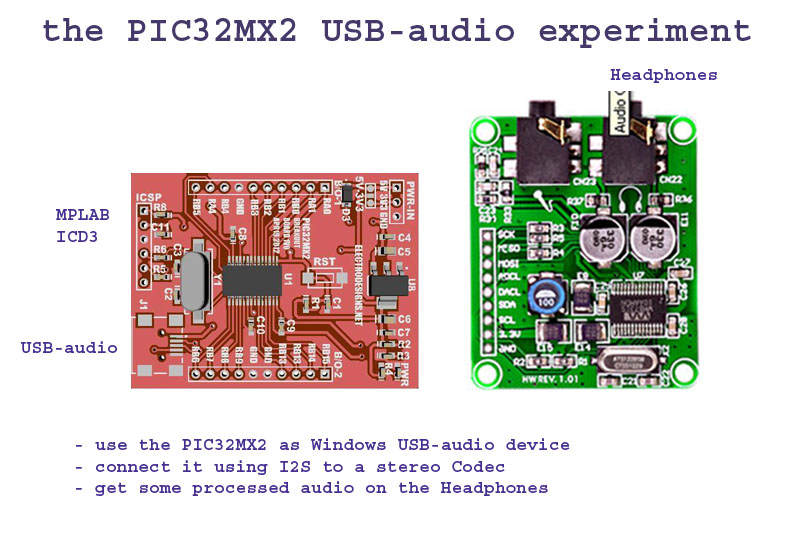

The PIC32MX1 and PIC32MX2 feature two SPI having an "audio mode" aka I2S.
Why not experimenting with them ? Using off-the-shelf boards like :
PIC32MX2 Breakout Board
Audio Codec Board - PROTO - WM8731 Development Tool - mikroElektronika

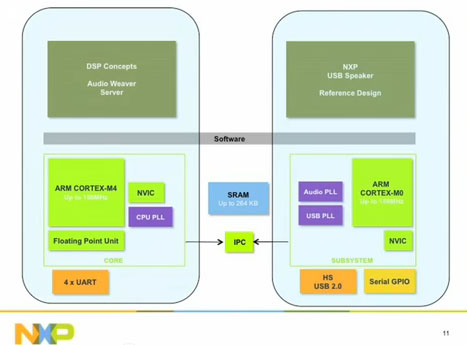

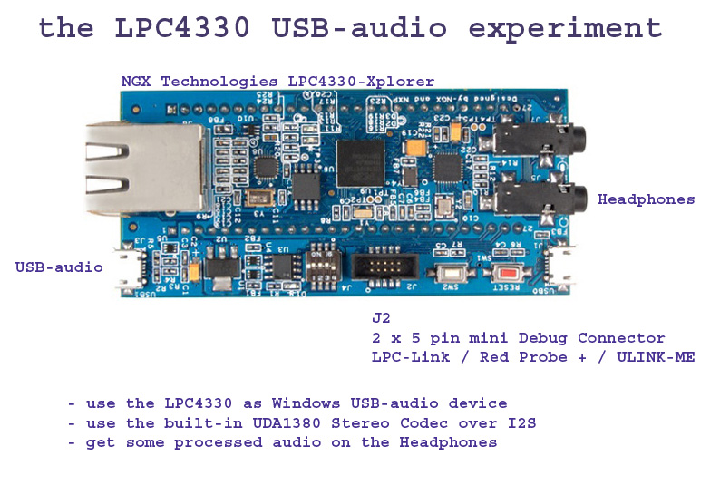

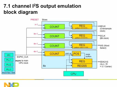

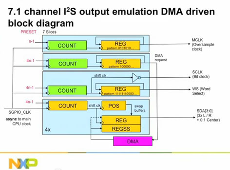

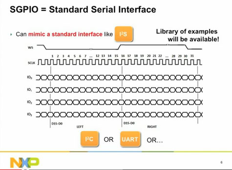

The LPC4330 features two I2S.
Why not experimenting using an off-the-shelf carrierboard like :
NGX Technologies LPC4330-Xplorer
2,500 rupies = 56.42 us dollars

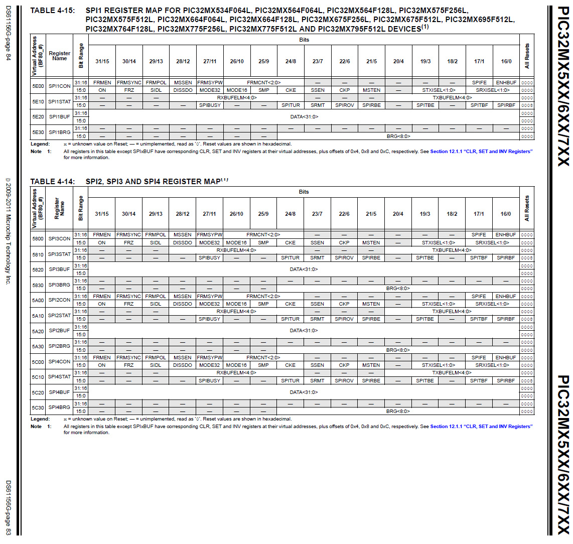

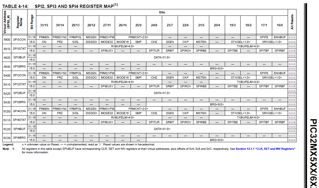

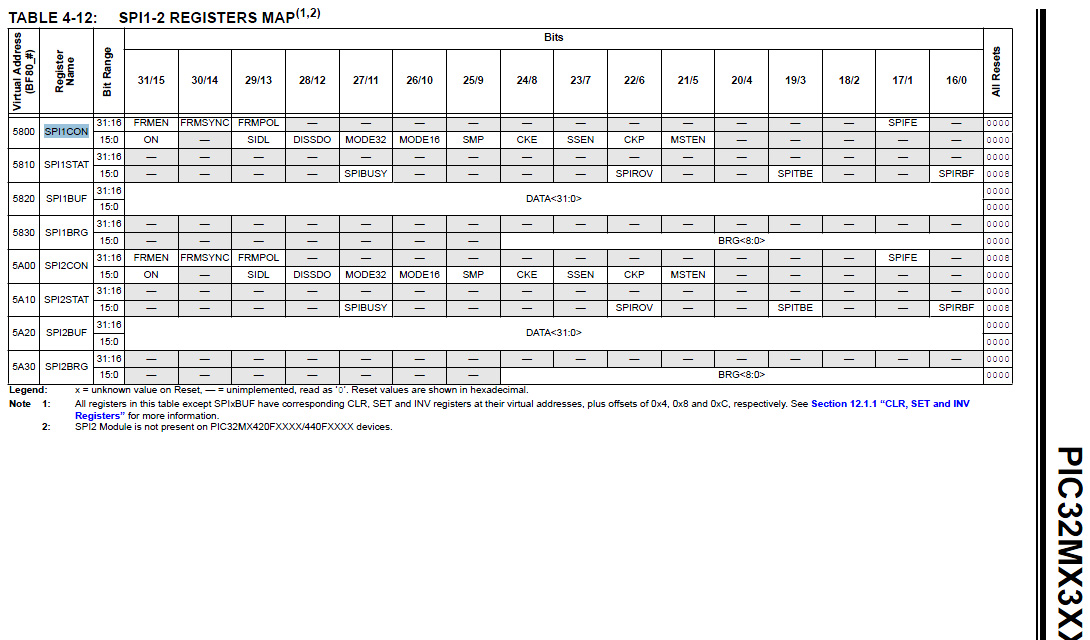

Currently within the PIC32 range, there are three chip families.
PIC32 MX 1-2 (introduced at the end of 2011)
PIC32 MX 3-4
PIC32 MX 5-6-7
Their SPI modules are all different.
Some chips combine two different kind of SPI modules.
Some are not buffered.
Some are buffered.
Some are buffered and feature the I2S compatibility (aka audio mode).
The control registers are not the same.
At the moment, only the PIC32 MX 1-2 SPI feature the I2S compatibility (aka audio mode). How long shall we wait for getting the I2S compatibility (aka audio mode) on PIC 32 MX 5-6-7 featuring up to four SPI ?
Worth reading is the Microchip document entitled DS61106G.
To be found here : http://ww1.microchip.com/downloads/en/DeviceDoc/61106G.pdf

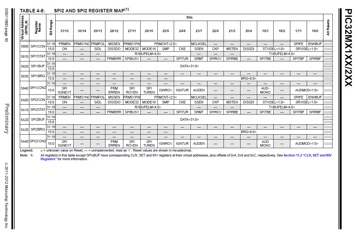

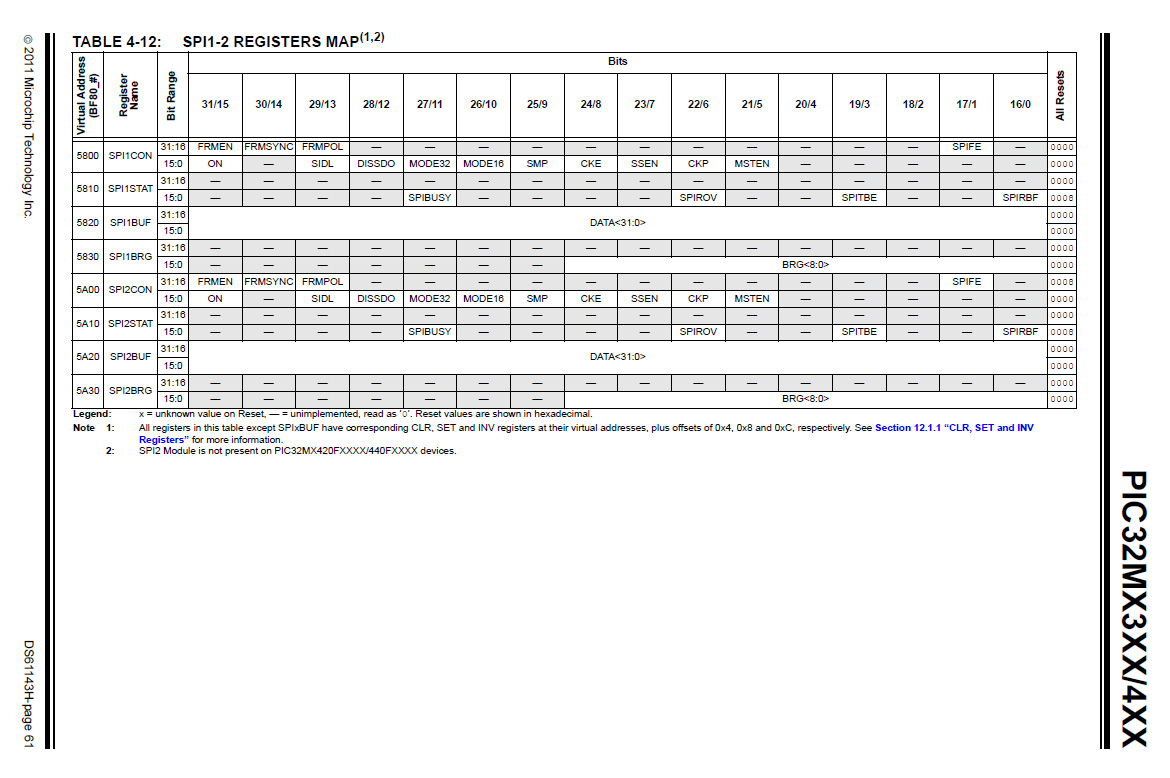

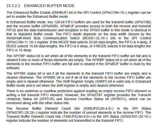

A more structured way to cover the PIC32 SPI modules :
PIC32 MX 1-2 datasheet http://ww1.microchip.com/downloads/en/DeviceDoc/61168D.pdf
PIC32 MX 3-4 datasheet http://ww1.microchip.com/downloads/en/DeviceDoc/61143G.pdf
PIC32 MX 5-6-7 datasheet http://ww1.microchip.com/downloads/en/DeviceDoc/61156F.pdf

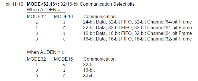

PIC32 MX 3-4 feature unbuffered, no I2S-compatible (aka audio mode) SPI. There can be one or two SPI modules. Those are the oldest chips.
The SPI registers are SPIxCON, SPIxSTAT, SPIxBUF, SPIxBRG.
PIC32 MX 5-6-7 feature buffered, no I2S-compatible (aka audio mode) SPI. There can be three or four SPI modules.
SPIxCON and SPIxSTAT remain compatible with the unbuffered SPI variants, but of course for activating the buffer feature you need to manage a few bits that remained unused in the PIC32 MX 3-4 family.

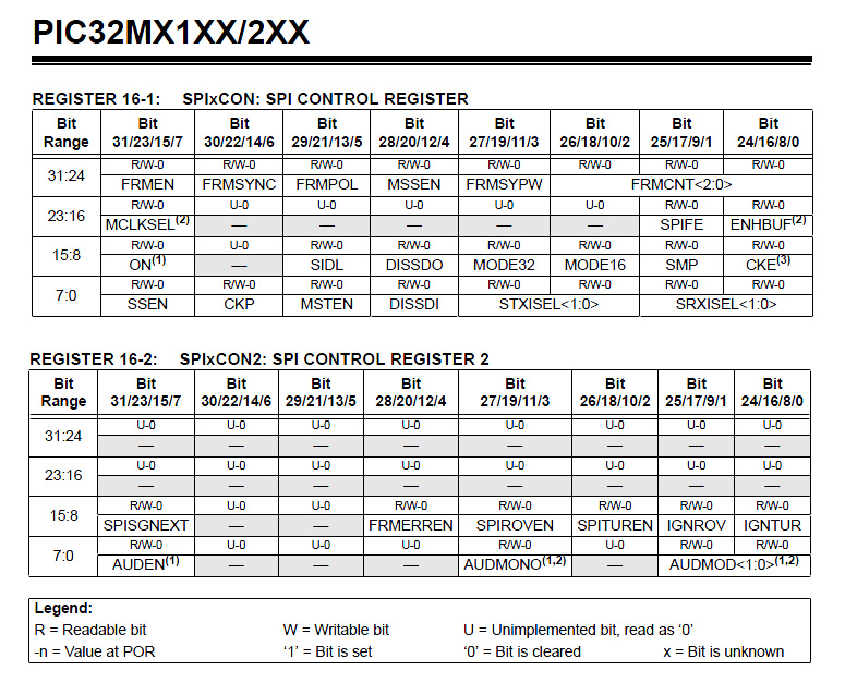

PIC MX 1-2 feature buffered, I2S-compatible (aka audio mode) SPI. There are two SPI modules. Those are the newest chips.
The SPI registers are SPIxCON, SPIxSTAT, SPIxBUF, SPIxBRG, SPIxCON2.
SPIxCON and SPIxSTAT remain compatible with the buffered SPI variants, apart from bit FRZ that's not showing anymore.
SPIxCON2 disables or enables the audio mode, and defines the audio mode modalities.
More info is available from Microchip about the I2S-compatbile mode (aka audio mode) here : http://ww1.microchip.com/downloads/en/DeviceDoc/61106G.pdf
There are a few lines dealing with 24 bit data.
There are a few lines dealing with an enhanced buffer mode.
The PIC32MX1/MX2 starter kit (DM320013) has a PIC32MX2 and a WM8731 Codec onboard. Microchip delivers it with a small audio application written in C. The PIC32 sends digital audio to the WM8731, delivered to the heaphones mini-jack. For some reason Microchip has not connected the I2S input of the WM8731. As a consequence, The PIC32 cannot read audio data from the WM8731.

Let's begin with the fundamentals. Before considering using the NXP LPC4330 SGPIO in slave mode, let's see how NXP used it in master mode in Robert Cassaro YouTube presentation, for the DSP Concepts USB Speaker Demo.NXP LPC4330 SGPIO slices still seem like the way to go for more than two way, though the clocking isn't necessarily trival when the LPC is consuming a clock rather than operating as the master.
Configurable and Virtual Peripherals SGPIO and SCT - YouTube
From What I understand, because of the 010101... pattern loaded in the recirculating register of the slice generating MCLK, you need clocking such slice at twice MCLK. Right?
There is a SGPIO_CLK in the schematic, distinct and asynchronous from the CPU clock. Say the board has two audio oscillators : the 44.1 series (11.2896MHz) and the 48 series (12.228MHz). Say the Codec needs a 256x MCLK when operating at the base frequency. This means 11.2896 MHz at 44.1 kHz and 12.288 MHz at 48 kHz. You cannot use those quartz oscillators as SGPIO_CLK. You need doubling the frequency. Right?
Is there a x2 PLL in the LPC4330, taking the quartz frequencies, multiplying them by two? What is the jitter?
At this stage, the NXP LPC4330 approach, as master, looks complicated, compared to using a multichannel Codec like WM8580 or WM8581 in Master mode.
Let's go back to the LPC4330 slice schematic. There is another device we need to deal with. We need to preset a counter, such counter acting as local SGPIO_CLK divider. It gives each slice the possibility to be individually clocked at slower rates like 1/2, 1/3, 1/4, 1/n, ... of SGPIO_CLK. This is particulary useful for generating the SCLK (48 x Fs if the frame consists of two 24-bit audio words). This is particulary useful for generating the WS (1 x Fs).
Actually for the SCLK and the WS generation, there is a degree of freedom as you can choose between dividing SGPIO_CLK by a certain number (by presetting the slice counter to a certain value), or loading slower patterns in the recirculating slice register like 110011001100... (inherent division by 2) or 111000111000111... (inherent division by 3) or 1111000011110000... (inherent division par 4), etc.
There is also a possibility to physically output the slice clock, just after the local division. This way, as single SGPIO slice can output both WS and BCLK.
There is also a possibility to define a SGPIO slice for generating a hardware DMA request.
I may have not understood a few subtelities, but at this stage, I have the nasty impression that NXP managed to complicate the whole stuff.
I don't like the idea of using the CPU as master, involving the CPU into the audio clocks generation, especially the MCLK generation.
The recirculating register trick for generating MCLK forces you to double the quartz frequency. You need a special quartz. Or you need a frequency doubler, introducing jitter. I say doubling the quartz frequency, only if the local slice divider can be persuaded to divide by 1. This is perhaps done by presetting the slice counter with a value equal to 1. Right?
After watching the NXP presentation, I had the diffuse feeling that NXP wanted to impress people, showing how the SGPIO could cope with difficult situations, like when you get forced to have the CPU acting as master, and the Codec acting as slave. I was thus thinking that for a less difficult case like using the NXP LPC4330 SGPIO as I2S slave, relieving it from the MCLK generation and other audio clocks generation, that the SGPIO would appear as simple and ideal.
And now, according to twest820, that's no the case? Using the LPC4330 SGPIO as I2S slave isn't so simple and ideal? You can't use the incoming SCLK as SGPIO_CLK, and use the WS for synchronizing the whole stuff like for triggering the data buffer swap?
Is there a NXP SGPIO library now, giving examples for building I2S slaves?
