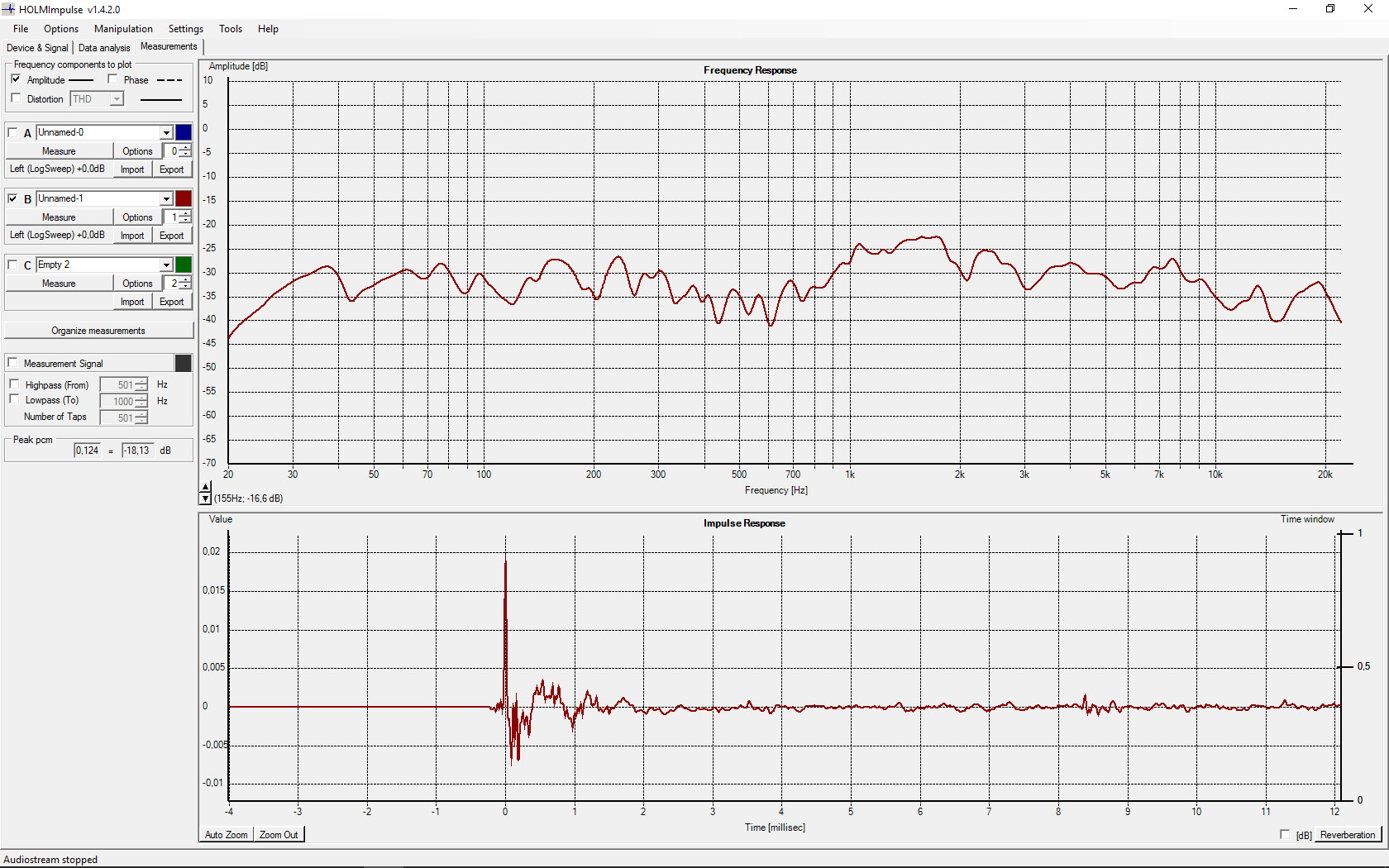

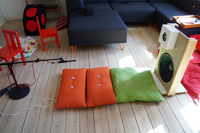

I haven't got the B2audio yet, It seems to be hard to get. While I'm wating I have bought a Gladen RS15FA (it's a free air car woofer). Little lower Fs, lighter cone and a bit higher Vas. Linear one-way Xmax is 16 mm. I'm almost done with a test baffle. Build quality for the Gladen (less than 200$) is no less than impressive for the price (no Monacor or Dayton in same price range have similar quality - at least in Denmark). It seems that you can get a lot for the money i car stereo - But just look out, because there is also a lot of junk.

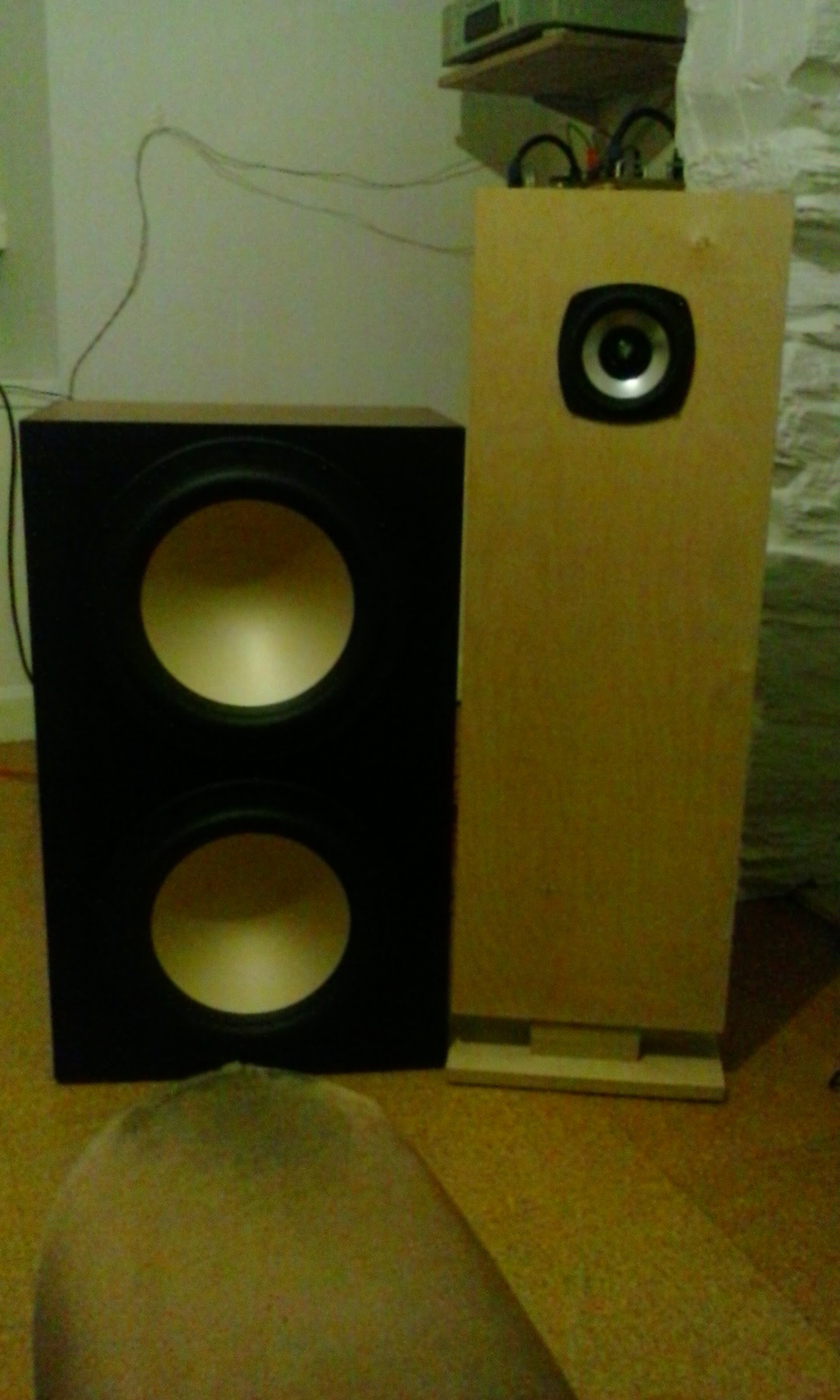

I have an unfinished 4-way OB with a 15inch Definimax 4015LF driver from Eminence for the low end (Qts just over 0.5 and Xmax 9mm). the driver was chosen solely based on the subjective impressions by people I trust on this forum (most of them present in class A amplifier threads), and with the intention of digitally EQing and bi-amping.
I am still a little uncertain how the driver's 40Hz resonance will be handled but the goal is not to go too low with the bass (down to 40ish would be Ok)?
I can now recommend the Gladen woofer. In an almost flat narrow baffle, woofer very close to floor it plays 30 Hz in room without eq. This is way better than expected and much much better than my present Vifa (four 10 inch per speaker)
