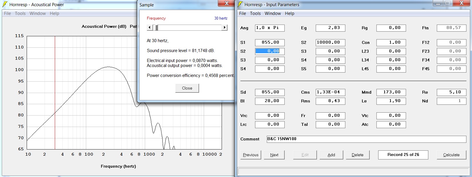

If we compare at 2.83V we can look at both the dual 8ohm with coils in parallel (green), the dual 16ohm with coils in parallel (magenta) and the 15NW100 (lt blue). In no case is the 15NW100 going to ever be more efficient down low than the Dipole15.
1 watt is not 2,83 volts over 89,3795 ohm. You keep comparing at a fixed voltage.
2,83 volts @ 30 Hz into a B&C 15NW100 is 0,087 watts. And with a small fraction of a watt you still get 81,1748 dB sound pressure from a 15NW100 in a 1 m2 open baffle according to Hornresp. If Hornresp is flawed in simulating open baffles it will at least be consistent in the flaw regardless of driver.

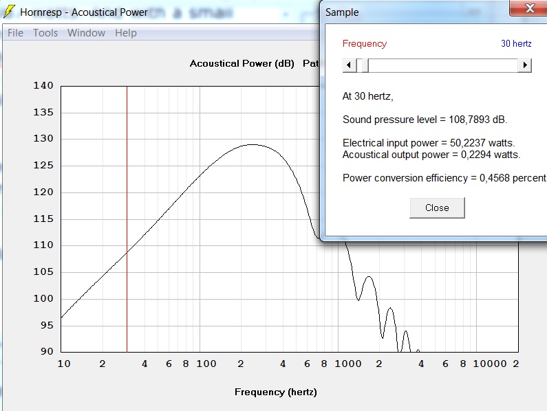

To get 95dB at 30hz then requires 50W input to the B&C
No. This is completely wrong.
50 watts @ 30 Hz into a B&C 15NW100 in an 1,0 m2 open baffle at one meter distance will give 108 dB sound pressure. t takes 68 volts over the speaker terminals to get 50 watts at 30 Hz.

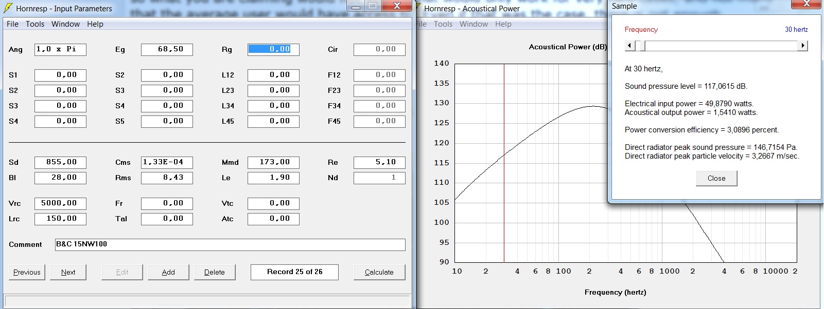

The same 50 watts into a B&C 15NW100. I choose a 5000 liter box since Hornresp does not do infinite sized boxes. Since it is many times larger then Vas, i think it is close enough.
In 1,0 pi radiating angle (against back wall and floor) it would give 117 dB spl level at 30 Hz, if it had 17,33 mm xmax. It does not, but Dipol15 does not either.
In 1,0 pi radiating angle (against back wall and floor) it would give 117 dB spl level at 30 Hz, if it had 17,33 mm xmax. It does not, but Dipol15 does not either..

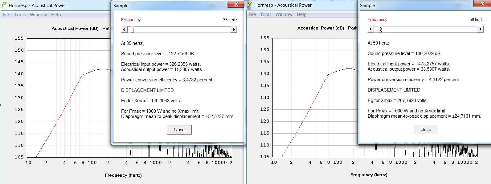

Then what is Hornresp doing? I only input voltage and hit "Calculate". The results comes from Hornresp. I don´t do anything else. I don´t correct anything. I just read. Maybe you should learn more about Hornresp? (I mean no disrespect)
Okay, what's the power draw at 35Hz?
I'd bet actual money it won't do that SPL at that power input at 35Hz.
Same sim as in previous post. 2,0 pi. 9 drivers. 2,25 m2 open baffle.

Your most-recently attached simulation shows what I'm talking about - at 50Hz you're hitting it with nearly 1.5kW, to keep the 50Hz response ~as loud as the 35Hz response.
Please look again. 1,5 kw is for maximum spl (130 dB, displacement limited). It is the power conversion efficiency that is interesting.
