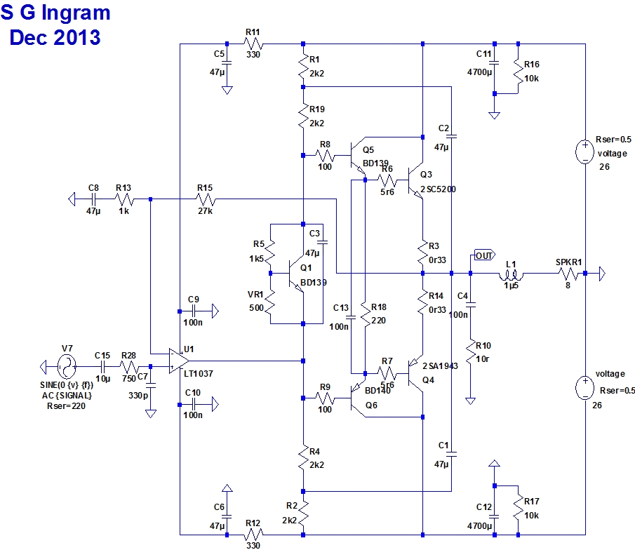

I'm used to seeing a capacitor across the Vbe multiplier - to ensure it has very low impedance at a.c. - something around 22uFmight be enough.
Why do the drivers have separate emitter resistors (they're gonna get warm) - looks like the emitter loads are therefore limited to 1k at most. If you connect the driver emitters to each other via a current limiting resistor each driver will act as a load for the other but with higher impedance than 1k - and this will increase their linearity.
Do you have rail fuses in there somewhere ?
An output inductor ?
I might also include a capacitor in the feedback shunt, i.e. in series with R8 in post #98. It's there as an option, you can always install a wire link if not wanted. Size the pads for something around 100uF Bipolar 16V.
The other change I might consider is bootstrapping the drivers. Take R13 and split it into two resistors of 4k7 each, connect a capacitor from their mid point to the output of the amplifier (e.g. 100uF 35V). Do the same for R14. It will improve the overall circuit.

Yes, you're quite right on the capacitor. I had noticed that a number of times, but each time forgot to mention it as an omission. Perhaps because it's a tricky component to know how to choose the value. Anything from 4u7 upwards would appear to be OK. I have actually never looked carefully at what effects the values have, but it also has a role in making sure the bias stays stable. In fact, that's always the role I've seen for it, rather than a free ride for AC, though the two might turn out to be complementary.
As for the drivers, I just thought this was simple and in line with the Class A potential that Mikhus wanted to have. There must be a dozen ways of doing them but I didn't have Cordell's book to hand and, from memory, the best that he has gets to be quite complicated, which is not the idea here. (Do bear in mind it was just a reply to a thread! ) Sure they'll get warm, 25 mA or nearby, I think, but they will stay at the same temp. I take your point, though I'm not sure it will increase their linearity. They are there to have sufficient quiescent to be absolutely sure of driving the bases of a paralleled output. Anyway I like things to be determined rather than left to the vagaries of transconductance - not for any particular reason, but it's nice to be able to put figures where we can. Also, not that it's especially relevant here, I tend to be naturally against active loads and that preference may have had an influence in my preferring just a resistor.

Taking a second look, that's a really interesting point on the linearity. For the moment I'll stick by it not making a difference (or only a smidgeon). 1k at 25 or 30mA should be all the linearisation one needs.
But the dominant load will, in any case, be what it sees at the base of the power transistor. And that is a reflection of the loudspeaker. It could be as little as something varying around 900 Ohms. It looks to me like a very good argument for a cfp output.
I can't see that this problem gets better with what is effectively more degeneration, but I can see why one might want to be tempted by it. If everything is lovely and benign, then it looks better, but I'm not sure we ever realise that in practice. But I'm certainly happy to turn that over to your views.

Output inductor? Yes, that would be my choice.
Cap? I was rather expecting it wouldn't be needed (and still do) though I'm sure it crossed my mind in an earlier post. I think in that post I might have asked for a place to be left for a small stopper resistor, just in case. (But that may be somewhere else.)
Sorry, now that I see you're asking to be able to short it, I realise it's not that capacitor.
So, unity limiting cap to ground. Possibly my least favourite component in an amplifier! Yup, it may be needed, but I rebel against every aspect of it. It screws up the proper transfer function of the high pass that it is supposed to be, and all those with it, because it doesn't go to zero; it is in the feedback circuit so has a direct influence on whatever comes out of the amplifier; it gives a very tenuous connection to what is supposed to be our reference ground. It's shitty all round. It may be a good idea to leave a place for it, but I do wonder why one bothers.
R13/14 are for the Vbe multiplier. I am trying to persuade Mihkus that this and the op amp input should both be regulated. Ie. a regulator just to the right of this section. I don't know that I agree that a cap pinning one half will make things better on a moving supply. The regulation here is very odd as it varies with signal (I think, I haven't thought about it recently). You are essentially relying on the voltage change across the multiplier being smallish, by comparison to what happens on the rails, but it doesn't just stay in the middle - if you follow my sloppy thinking. For an idea of my viewpoint, I tend to look at a lot of this as let's imagine that it is the rails that are being excited by 1V AC and then see what happens. A capacitor would seem to just let more through at some frequency. But, again, you say that the circuit would be better and I'd be happy to hear why. My suspicion is that you are assuming perfectly static rails.
But, thanks for your input. It's nice to be pushed into actually thinking.

Fuses are good when used in the right places - unless you have been on the Scrumpy
Do you see that R13 and R14 provide the source/sink for current into the base of the drivers ? it's not just the op-amp that is providing a drive signal. And the less the opamp has to source current, the better I believe it's performance will be.

The fuses comment was a joke. Nonetheless, this was just a knock up to help Mihkus from getting lost. He will need a fuse somewhere - though if it were my amp I'd have it regulated and current limited.
Actually I misread what you planned to do with R13/14 and was a bit puzzled why you wanted the cap connected to the rails - but you didn't. I should have been clued-in by the word 'bootstrap', but it was past midnight here, and a bottle of wine later. You obviously can't be a fan of current dumping which would allow us to get rid of that whole Vbe section and put the entire weight on the op amp - but then he wouldn't get his Class A option. (I have to switch between Mac and PC on this computer, which is a bit of a pain, but I'll have a look where the currents are going when I'm next in PC mode.)
Incidentally, do feel free to put up something that you think would be better. I only did so because no one else had done at the time and he needed a certain amount of hand-holding.

The attached circuit is what I had in mind when I posted some comments earlier on.
You can set the bias based on the size of your heatsink by adjusting VR1. For Class AB you want to set the bias so that you have enough current flowing through the output device emitter resistors to generate a voltage drop of 26mV across each resistor. If you have a large enough heatsink then you can crank it up from there, go as high as you like - although with a single pair of outputs you likely won't want more than 1.5 Amps. I bet you'll find that Class AB sounds just fine.
I don't know much about compensation of Opamps. You may need to allow for some additional components on your pcb, even if optional, so you have the flexibility to add compensation.
Class A can be easier on the power supply than Class AB, the devil is in the details.

Looks good. But read up on how to compensate the opamp you plan to use and add those parts to the pcb.
Your 3-d image doesn't show the Vbe multiplier (which would imply an odd number of devices on the heatsink in total). Some folk mount it on the main heatsink between the power devices, but I prefer that it be mounted on top of one of the power output devices, instead of onto the pcb. You can thread a single mounting bolt through both the Vbe multiplier and the power device and then into the heatsink to hold them firmly together. A small thermal pad or bit of thermal grease between the Vbe multiplier and power device keeps them in good thermal contact. Then run the wires from the Vbe multiplier back to the pcb - a couple of inches is no issue but twist them together.
Built carefully it should be reliable and I think you'll like the sound, depending on your choice of opamp and other components. I'd suggest you treat the first one as a prototype, just get one channel up and running on a naked heatsink and see what you discover along the wy before committing to the final chasis.
