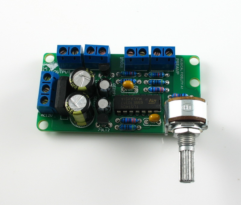

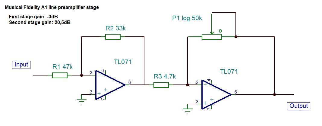

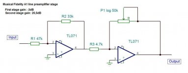

I was at first very sceptical about subjective superiority of the opamp used in inverting mode. Until I tried it! For my subjective tests I used Musical Fidelity A1 line preamp section with it's two inverting stages (making complete circuit non-inverting) and simplest form of active gain control. Even with 47k series resistor at the input of the first stage I was unable to hear any problems with inverting configuration. The sound is more relaxed, musical and involving than with non inverting topology. (Beware, even the small imperfection, dirt, etc., on the pot track this kind of active gain control will cause loud noise from loudspeakers!) I used MC33079 quad opamp for complete stereo preamp.

a lin pot in the inverting opamp feedback leg gives a good approximation to what the rotation and our ears expect to hear.
50k seems too high
That gives a gain of 50/4.7 * 33/47 = 7.5times (+17.5dB)
Would it be better to make R2 the adjustable section, Rin=24k and VR=50k and then use a switchable 1x or 2x in the second inverting stage 4k7 for both resistors? An extra 4k7 in parallel to R3 gives the 2x

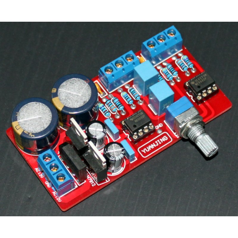

I have three versions of MF A1 line preamp stage from the schematic: a) my own rats nest perf board version: b) Chinese LJM clone kit; c) Chinese Yuan Jing clone kit.
Interesting thing is that Chinese kits deviate from the original schematic given:
1) LJM kit has 20k pot, exactly because original schematic has too much gain
2) Yuan Jing kit uses 50k lin pot (as you suggest) and 10k instead of 4k7 (again for lower overall gain)
