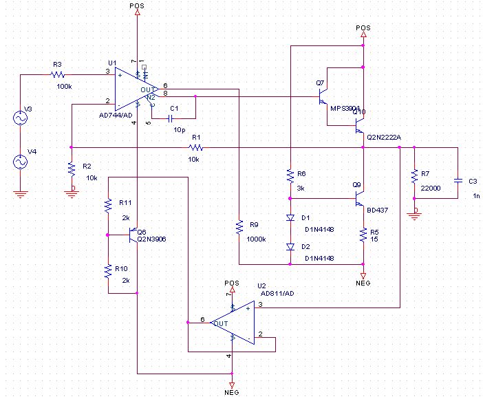

The problem you are referring to generally occurs with FET input op-amps. What you have to consider is the actual circuit implementation.
When you use an inverting configuration for an op-amp, both the inverting and non-inverting terminals are generally kept pegged a a fixed voltage level. Hence that voltage level is kept constant w.r.t. the rails. Between the input terminals and the body of the semiconductor, there is a non-linear capacitance.
With an inverting configuration, the voltage at the input terminals changes w.r.t. the body of the semi. The effect of this is a non-linear input resistance. That non-linear input resistance causes distortion and potentially bad sound quality.
One way to fix this is to use a low impedance source to drive the non-inverting configuration. That often defeats the whole purpose of using the non-inverting configuration. The other way of reducing the distortion to to vary the voltage on the supply rail.
I have attached a schematic of a circuit I whipped together from the parts bin... no smart *** comments of the 2N2222, etc. please... :) ! Notice how the output is feedback into the supply rail. This reduces the distortion by a good order of magnitude. [and this circuit actually does not sound to bad. The pin used on the AD744 is before the ClassAB output stage.]
I can't claim the idea for doing this... I am sure if you did a search on the web you would find it somewhere!

hmm, interesting. i've known about capacitance-modulation-related distortion, but did not think about how it relates to which opamp input is used. (we're assumming IC devices here, thus the common substrate.) i guess my real question is which configuration for a given circuit yields the lowest distortion, or at least exhibits distortion that is least significant to the system. in my case, the application is a simple line-level preamp, say with 20dB gain and an input impedance of at least 20kohms. which configuration would you pick? (let's forget about absolute polarity for now...)
p.s. the feedback circuit looks very clever, but i wonder if it's fixing a small distortion while introducing new ones from the additional feedback? the need for additional circuitry probably means imposing additional sonic signature on top of the basic circuit...
That was what I was thinking the whole time I was making the circuit. However, with a large input resistance, 20K would not be large or small, distortions can be higher than 0.1%.
Here is the link to the application note on the ADI web-site that covers this topic. Racked the brain and remember where I had seen this written up and where the circuit idea came from. I basically modified the circuit shown in the attached application note to use the Class-A output of the AD744 and added a class-A discreet buffer. The AD811 works well for the feedback, but I have an improved version, can't find it right now that uses an LM7171 instead. As opposed to a simple feeback circuit, I also treated the feedback loop as a "control system" and tuned it for minimum overshoot and ringing. This improved the sound quality yet a bit more.

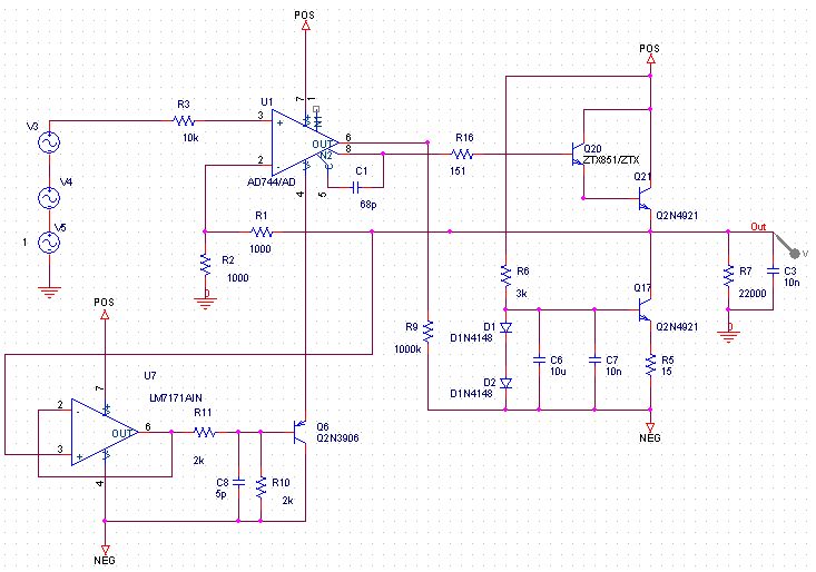

This was one of the later schematics
I have to update this circuit, but this was one of the later configurations with some better transistors on the output stage and a better tuned feedback loop. The comment above of loading the 3906 is quite valid depending on what op-amp you are using. I actually loaded the AB output of the op-amp into the negative rail which improved the quality a bit.
