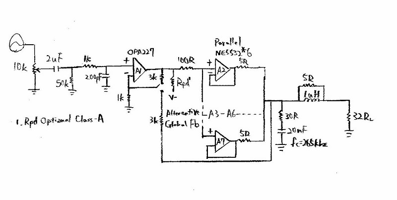

This is my first junkbox attempt at composite amps, and any feedback is greatly appreciated.
attachment.php
Pot is intentionally placed before coupling caps so that if any DC develops at the source, I'd know that there is a fault.
OPA2227 was chosen for to its automatic input bias current cancellation, relatively low GBW, and good phase margin.
I happened to have enough NE5532 to make a poweramp, so naturally this is the buffer of choise. With 4x gain at the global feedback loop, it should slow the effective bandwidth at OPA2227 down to 2Mhz, although I am not certain whether a 2Mhz - 10Mhz difference is a good enough safety margin.
Likewise, I've considered parallel OPA2604 on the output, being 20Mhz GBW these should make a good candidate but at increased cost. Douglas Self wasn't too thrilled about these, but I have a few lying around and they shouldn't be too bad inside the feedback loop. If all else fails, OPA2227 will have to operate on local feedback.
Current sharing resistors are at 5 ohms, but these could probably go down to 1 ohm in practice.
Now a couple of questions.
Is a single 100 Ohm resistor be good enough at isolating the gain stage & buffers? I recall seeing a design utilizing isolating resistors before every buffer, another without but using a defined input impedance with a resistor to ground, or perhaps it wouldn't be necessary in the first place?
Another question would be towards the output network.
I picked 30R + 20nF zobel values based on headphone impedance, but couldn't find any specific guidelines on how "heavy" the high frequency load should look like, and 1uH || 5 Ohms was used to isolate the cable capacitance.
I believe there was a specific composite headphone amp sample circuit by Walt Jung that that had only 5uH || 50 ohms on the output without any zobel shunt, would there be any reason not to use a zobel? I find it strange why it's not more often seen in practice on headphone amps, even though everyone recommends them on gainclones.

You most probably wouldn't need any kind of compensation for the "local feedback" configuration. '5532s are unity gain stable and all, and the 5 ohms would keep off some capacitive loading already.
As for the "global feedback" config, consider using a configuration à la Apheared-47 but with inequal current sharing resistors (your 5532 array already has them, the OPA2227 might get 47 to 100 ohms). In any case I'd simulate the affair in order to make sure it's stable.
The A47 topology looks like a form of feedforward to me, please correct me if I am wrong. What is the advantage of this other than that some of opa2227's current drive can also be utilized?

According to this app note, the A47 style would have some delay between the 2 opamps, and I would think this might introduce phase shift and result in less stability?

I gave it a bit more thought, it seems like the A47 topology which allows direct drive should avoid the outer opamp from going nuts if the output array somehow drops dead (ex. thermal shutdown, not that 5532 has this feature), but this can be useful if the power stage was a OPA541.

Actually, paralleling opamp buffers is said to reduce output noise, due to random cancellations. Noise with two parallel opamp buffers is reportedly about 3 dB lower than one opamp and four in parallel decreases noise further but is about the practical limit.
output device noise is irrelevant inside another feedback loop - it is the noise of the input/global loop op amp that matters
just do the input referred noise calc with the loop gain of the input amp at audio frequencies
and the TPA6120, or discrete Q buffers are really input low noise compared to 5534
The OP's concept could run the output buffers both inside and outside global feedback, so their noise would be relevant in the latter case (similar to O2).
There is one problem with paralleling output buffers, each one sees a source impedance that multiplies accordingly, which ultimately worsens distortion. The importance of voltage noise vs. current noise also shifts IMO.
The TPA6120A2 has one issue, it has to be used with a series resistor of at least 10 ohms to avoid oscillation with capacitive loading. For some types of phones, that still is too much. These chips are like racecars, fast but fussy. There always is a tradeoff between stability and distortion, looks like things are leaning more towards the low distortion side in this case.
As far as effective input noise is concerned, with the output noise values given in the datasheet this computes to about 3.5 nV/sqrt(Hz) for the Av = 40 dB case (which is fairly but not unusually low), up to a more modest 18 nV/sqrt(Hz) for Av = 6 dB. That assumes a 20 kHz measurement bandwidth, which the DS does not bother to mention.
output isolating Z can be a inductor, or R bypassed by inductance at audio frequencies to give low signal loss, high damping/frequency response flatness
fast loops are actually easier to isolate from C load - I've discussed TPA6120 load isolation series Z parts choices before:
in audio power amps the load isolation series impedance uses an inductor to keep the audio frequency efficiency/damping ratio high while "disconnecting" the amp output from the load (mostly cable C causes stability problems) at high frequency near the loop gain intercept/corner frequency
the TPA6120 is so fast that the load isolation impedance can be lower than you normally see in audio power amps which may have only ~ 1 MHz loop gain intercept and at best 30-50 MHz output Q - requiring a few uH inductance to get load C isolation near 1 MHz and beyond
the TPA can have >50 MHz corner frequency and uses GHz Q so the ~10 Ohm series load isolation impedance doesn't have to fully develop until beyond ~10 MHz so < ~1uH inductance can be OK
