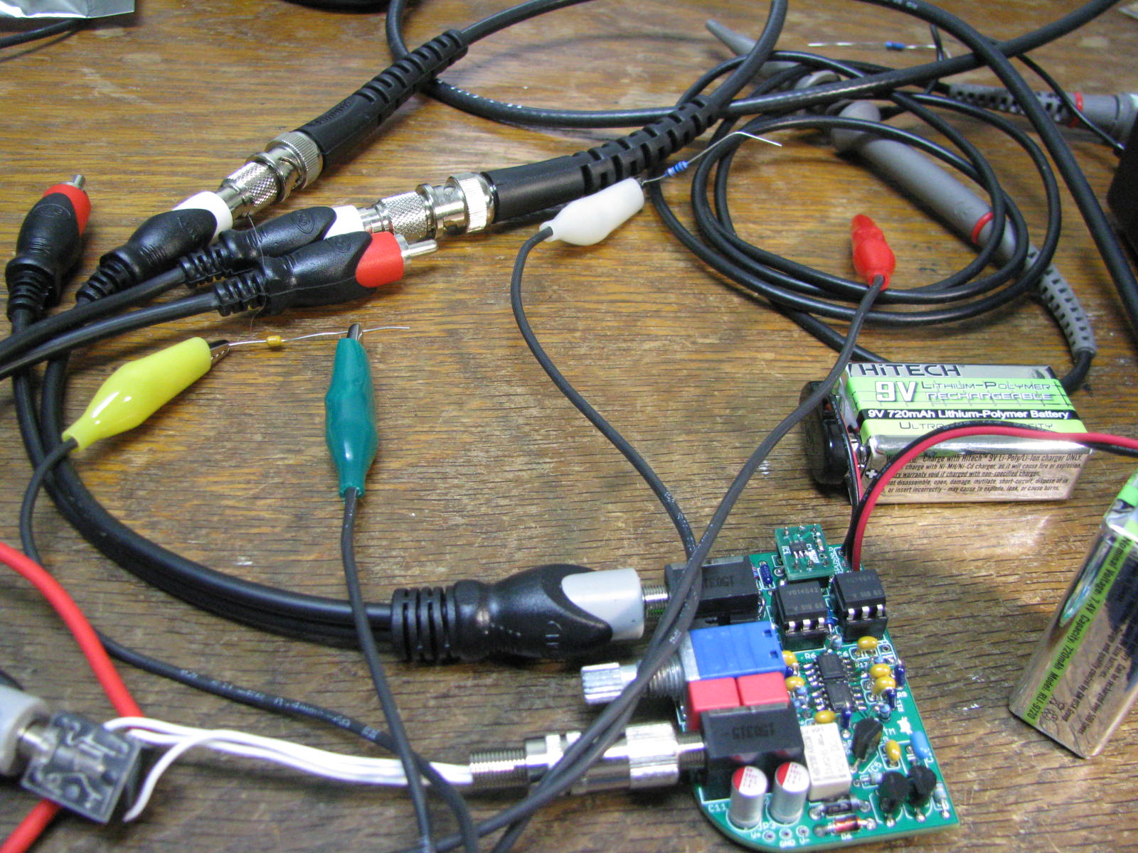

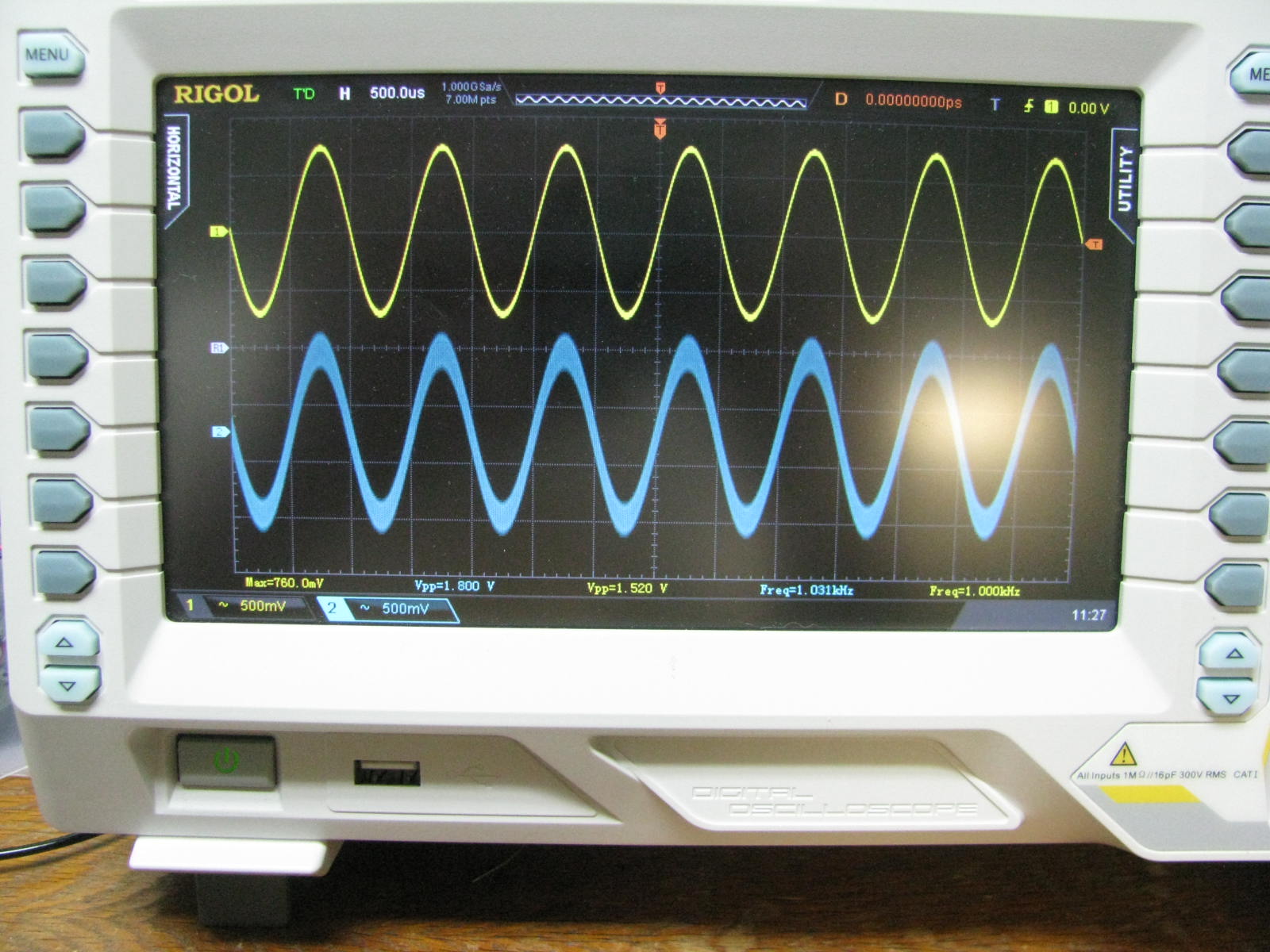

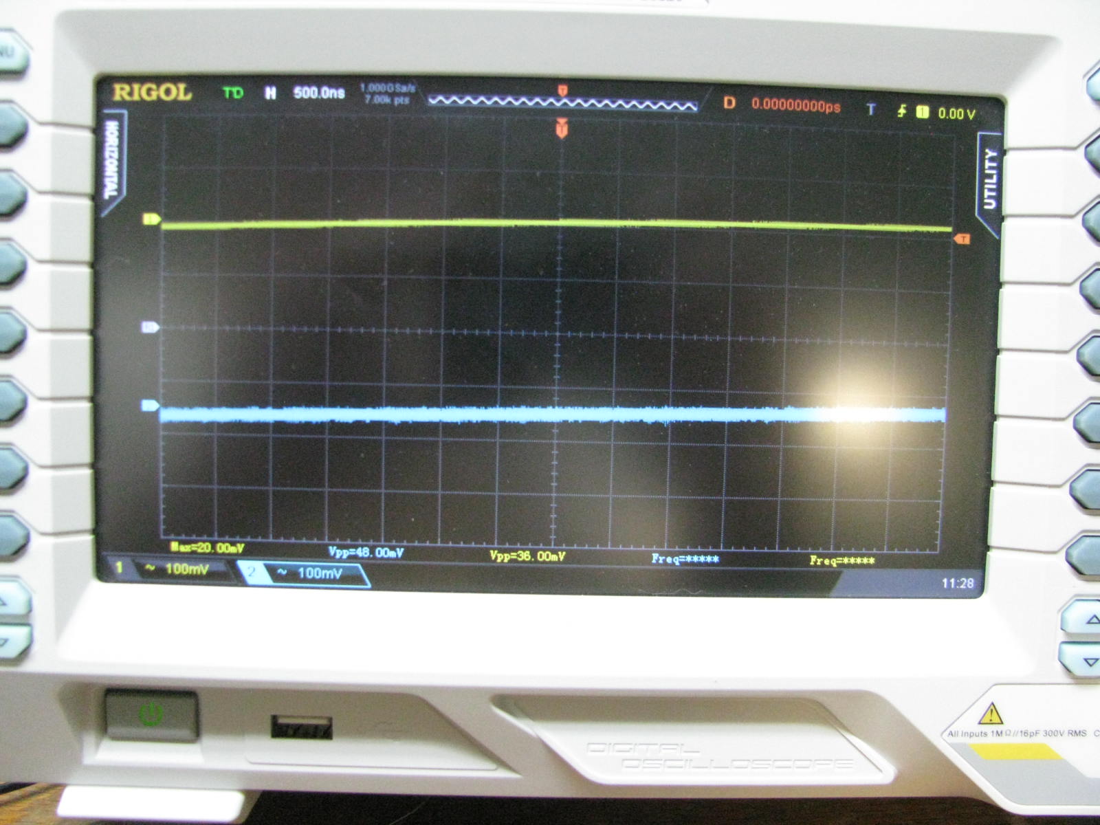

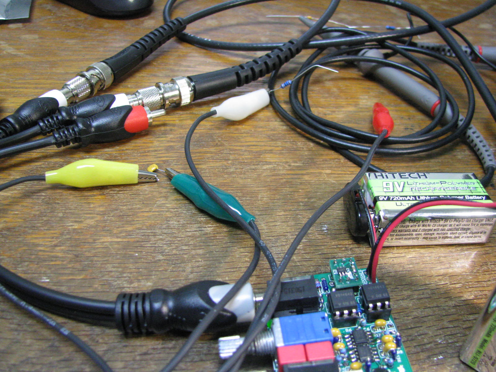

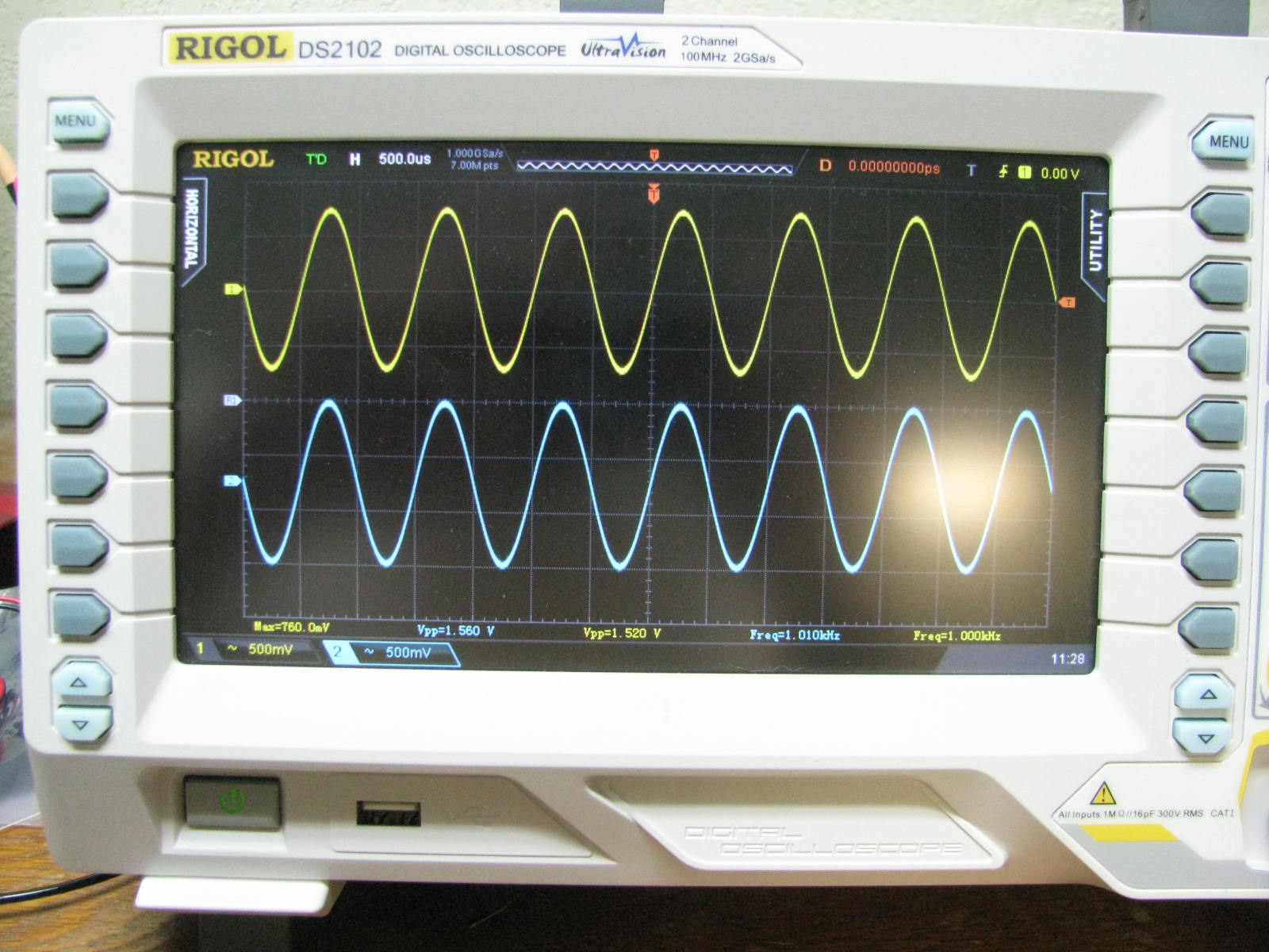

C-load testing: single and double stable with 2.2nF load! Part 3
Next up with the same purely-capacitive 2.2nF load with the double chip (parallel) amp now, verifying that is does oscillate, as it should with a large enough purely capacitive load.
* 2.2nF, no resistance (resistor unclipped), parallel amp. Oscillation, as expected, but notice it isn't as bad as with the single chip amp in part 2 under the same test conditions, also as expected. I would expect the parallel double-chip amp to have more capacitive load drive, and that does appear to be the case.
* Next is the one I got a good laugh over. I replaced the 2.2nF capacitor in the test above with a 1nF and the Parallel Super CMOY is completely stable. That is driving nothing but a 1nF capacitor, no resistor. Pretty slick! On that 3rd plot I have run the scope time base way up and increased the sensitivity on the amp output channel to 100mV/div, looking for oscillation.

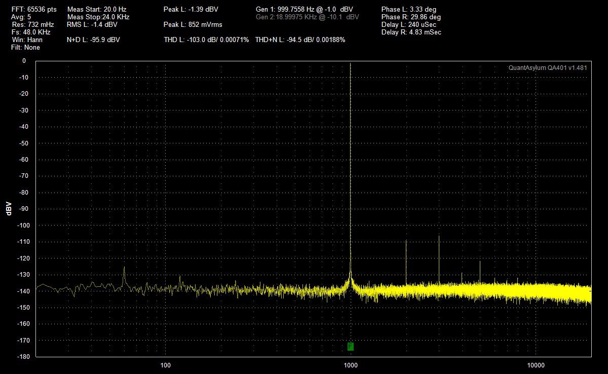

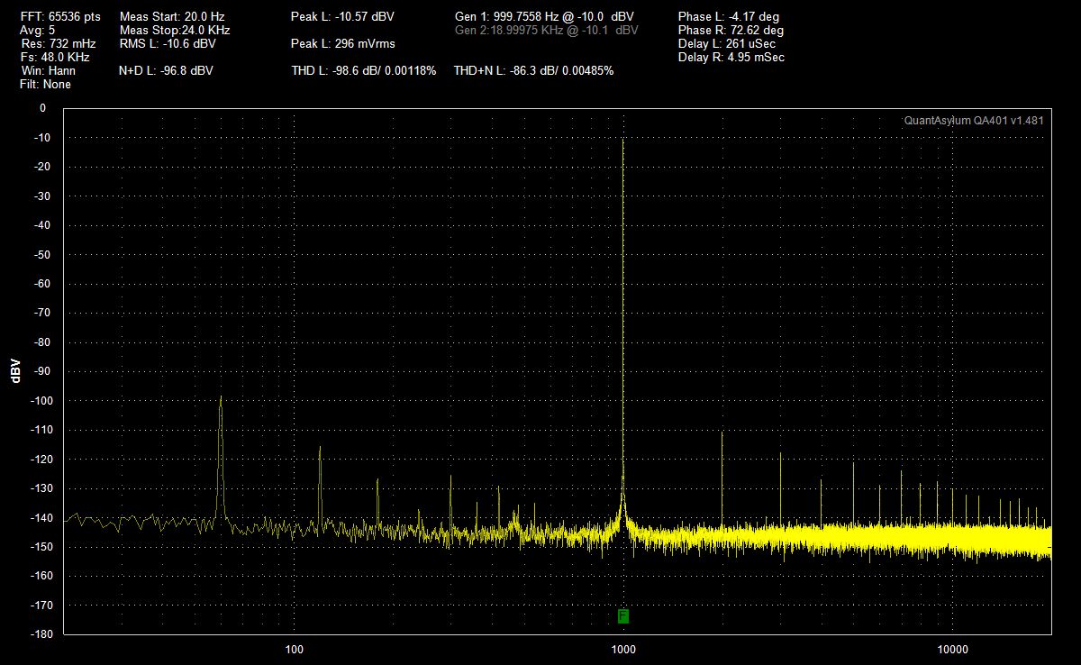

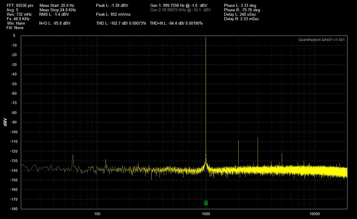

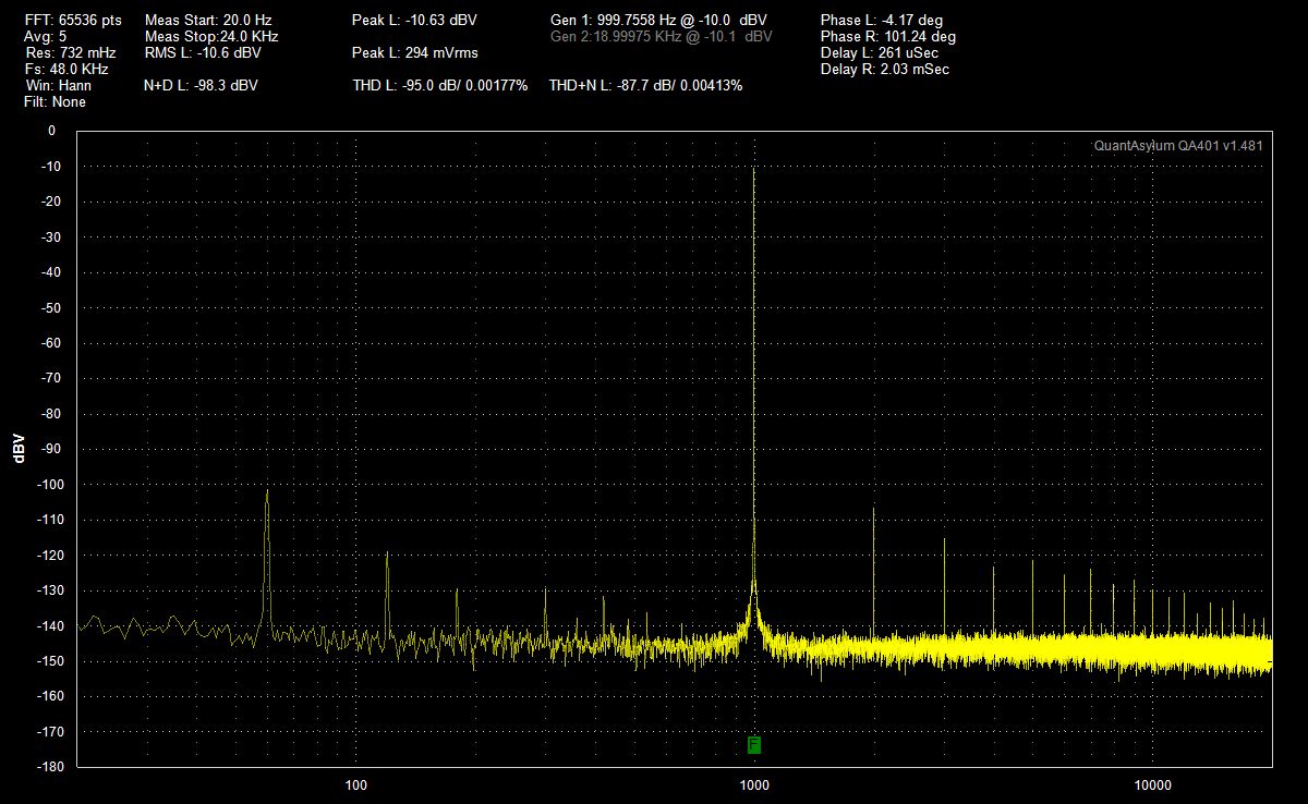

Finally I wanted to go back and do some THD+N tests with a capacitive load. I only used the 2.2nF here since we know it is stable with both the 16R and 150R from the previous tests here. I tested both the Parallel Super CMOY and the single Super CMOY. In summary, no significant change at all to THD+N by adding the 2.2nF across either the 16R o 150R loads on either amps!
I'm only showing the single chip amp here since the parallel was similar:
* 1KHz tone, 48Ksps rate, -10dBV, 16 ohm load. Again those 2nd and 3rd harmonics are largely the tester's (QA401) and not the amp.
* 1KHz tone, 48Ksps rate, -10dBV, 16 ohm + 2.2nF load
* 1KHz tone, 48Ksps rate, -1dBV, 150 ohm load
* 1KHz tone, 48Ksps rate, -1dBV, 150 ohm + 2.2nF load
I reduced the drive level for the 16R load to the -10dBV so it wouldn't over-run the output current capability of the single-chip CMOY.

Alex - thank you for the listening impressions!! I know that takes a lot of time A/B-ing with different music and the different amps.
What you've concluded there is what I would expect, that the parallel version should sound no better or worse than the single, unless a person had headphones that needed the extra current output to avoid clipping. So folks building a Super CMOY can save themselves $4 in parts and the soldering effort of one chip by just getting the single chip Super CMOY, unless musical peaks on a particular headphone in the collection will go over 75mA. I have SPL spreadsheets out at the project Google Drive link now for a number of different headphones, that show the voltage and current drive levels needed for different SPL levels.
On the other hand all this testing shows that the parallel Super CMOY doesn't seem to subtract anything, if someone prefers a parallel double chip CMOY.

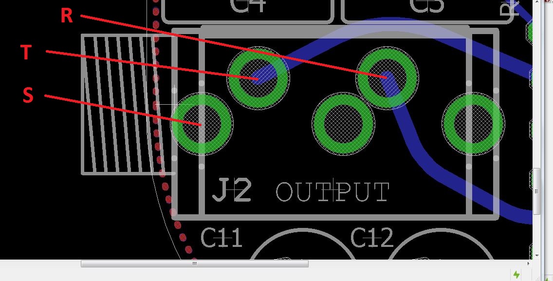

How to wire the Super CMOY to an external output jack
A question has come up about wiring an external 1/4" jack with the Super CMOY. I've created a diagram below that shows which holes the jack wiring connects to.
The "S", sleeve is the bottom part of the 1/4" plug. If you jack doesn't have an S marked ont he jack's terminals it is the jack connection that goes to that lower part of the inserted plug.
The "R", ring, is the band in the middle of the 1/4 plug, so the contact on your jack that mates up with that ring.
And the "T", tip, is the tip of the phone plug, the jack contact that mates up with that.
The extra 2 holes on the board under the output jack are not used. Those are switches which *are* used in the input jack to ground the contacts. Just to simpify the BOM (and prevent part mix-ups!) I used the same jack for output as for input.

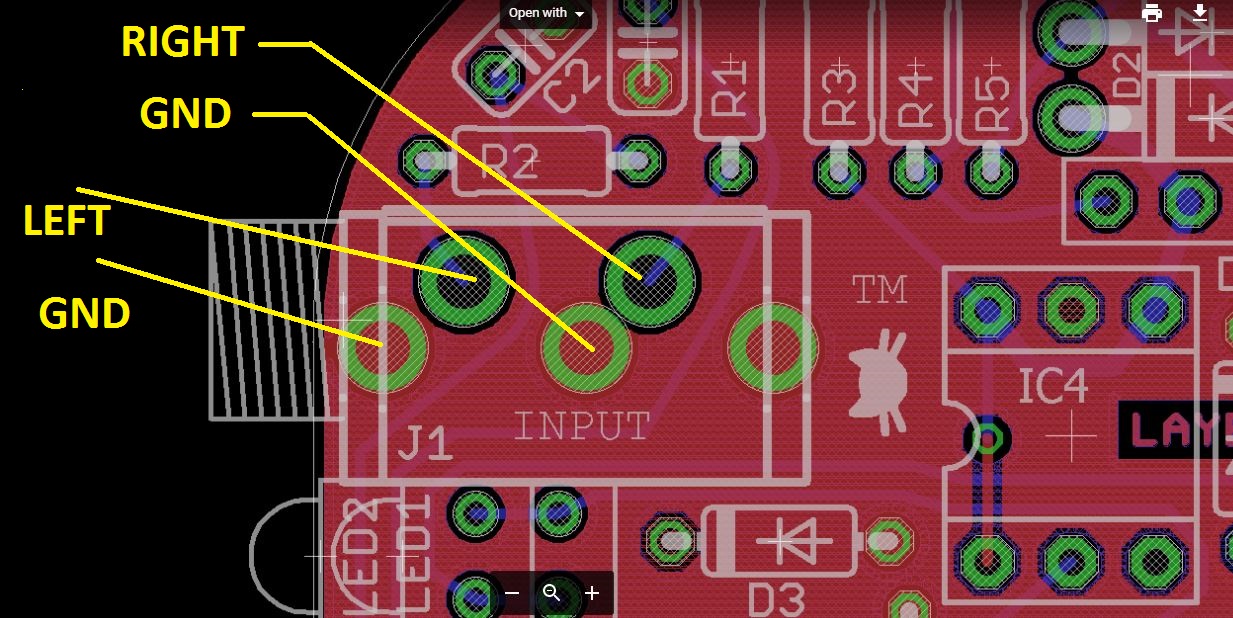

External input RCA jack wiring
Here is the companion diagram on how to wire up external RCA jacks for the input. The third hole in the middle towards the back of the input jack isn't used here, that is just another ground.
Keep in mind that with RCA jacks they won't automatically ground with nothing plugged in, so you might hear some hiss if turned all the way up with the inputs unconnected (as with any amp). The equivalent thing to use if you want to check background noise with the inputs grounded is RCA shorting plugs on both inputs.

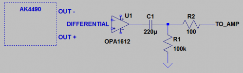

How to adjust the offset with the amp?
I am delighted with the sound! Nice work and thanks for help!
But, there was little doubt I in relation to the offset.
The signal is output from the converter with offset 2.5v.
In the amp, the capacitor C3 / C4 is already there to block DC then as it should be at the converter output? My image is correct way of thinking? Or is it not necessary? I have seen some cases where we used two capacitors on the inputs of the op amp, can explain me what better way?
Thank you for the listening impression!
The one set of DC blocking capacitors in the Super CMOY, the C3 & C4, is all you need. The DAC output will probably idle at 2.5Vdc due to 5V single rail power supplies. Setting the DC bias point at 2.5V allows the signal to swing a full volt or more in each direction above and below 2.5Vdc.
If you were sending that signal to an amplifier that did not have DC blocking capacitors already then you would need to add something similar to your diagram to move the output signal zero crossing from 2.5Vdc to 0Vdc.
But in the case of the Super CMOY you can apply the 2.5Vdc DAC "idle" output to the 10K pot in the CMOY and it will only draw 2.5V/10K = 250 microamps, which should be well within the output current capability of the DAC. The power dissipation in the pot will be 2.5^2/10K = 625 microwatts (0.625 milliwatts), again well below the 25 milliwatt rating of the pot. DC current going through the pot itself doesn't matter as long as the power dissipation (and therefore heating of the pot) is well below the maximum rating like this.
What will matter is any DC current through the pot wiper, which can cause scratchy sounds when turning the pot and wear down the pot resistive element faster, but that is blocked by the 3.3uF film coupling capacitors.
Also, as far as having capacitors in both places (output of the DAC and C3/C4 in the Super CMOY) that is OK, and probably necessary vs. just the 220uF. The problem here is that while the 220uF capacitor (in your diagram) would block the 2.5Vdc, a capacitor that large would probably be an electrolytic and would leak DC current to some extent. Especially when the amplifier is first started, electros will leak signficantly more current for the first 2 minutes than after the internal barrier has formed (the datasheets usually have a formula for it). If C3 and C4 were not there in the Super CMOY that "startup leakage current" of the 220uF electrolytic would make its way through the pot, and in turn through the pot wiper. The type of coupling capacitor in the Super CMOY (film) doesn't leak current like that on startup and leaks orders of magnitude less in steady-state.
