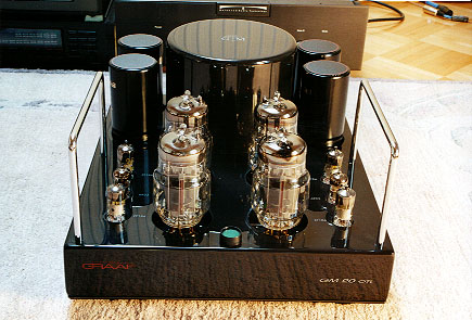

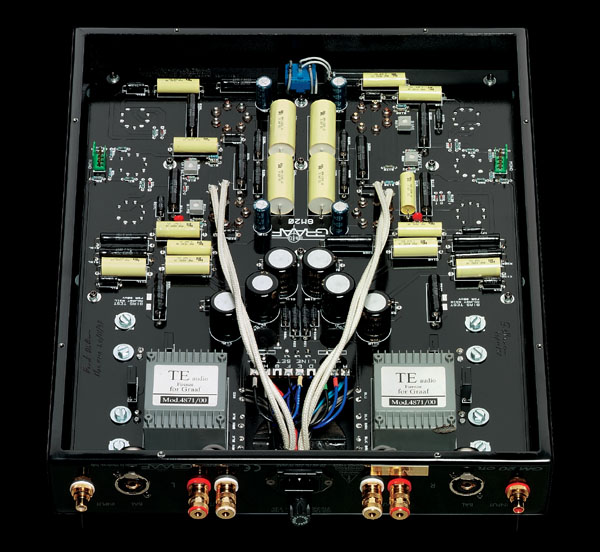

Basicly it would be easy find out by the circlotron topology (= CSPP resp. PPP) without transformer (i. e. OTL)
If you have an OTL circlotron tube power amp GM-20 (Graaf) and a finished MOSFET circlotron diy project at the same time, you can comparable both of them and tell about the results.
I have heard both of them, but unfortunately not at the same time
here a URL about MOSFET CSPP
http://www.hinocatv.ne.jp/~s_suzuki/Uni_CSPP/UHC-MOS/UHC-MOS.htm
and two jpg's and a schematic about the GM-20:
  • C_tmp_Graaf GM20_ckt.pdf
