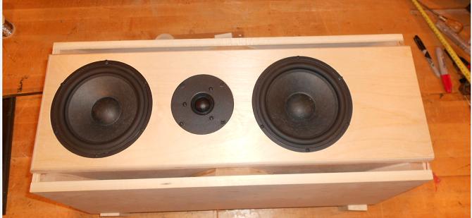

Well, guys, I decided to use Zaph's "Budget MTM" design, which uses Dayton DA-175 woofers, with which John Krutke (Zaph) is quite impressed, and the SEAS 27TBFC/G tweeter. I'll use his xover design. Those woofers take the same enclosure size and exact same cutout as the SEAS, so maybe later I'll try the SEAS woofers in the same enclosures once I come up with a suitable xover design. As a bonus, the Dayton drivers are less than a third the cost of the SEAS.

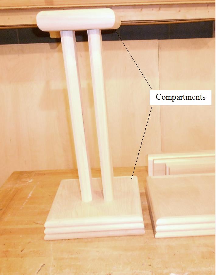

Here's a stand that I've been working on (not screwed together yet), 2 compartments top and btm.

I assumed that is what I'd end up doing. I designed the enclosure with separate compartments for the xovers, with removable backs.

Mine are 3/4" MDF, except baffle, which is 1-1/4" MDF. 1 ft3, sealed, internally braced. Applied 1st coat of glue sizing today. Plan to take them to an auto body shop for painting with high-gloss automotive enamel.

My "stands" will be a pair of SVS SB12-NSD subs (shown in photo). Will phase them in to match the MTM's natural rolloff (or maybe use the sub's hi-pass line out). The lower section of the MTM will be a separate crossover compartment.

Zaph recommends stuffing with Acousti-Stuf (for the sealed version. He also has a ported version), so I ordered some. Plan to follow his design pretty closely, except for having xovers in a separate compartment.
