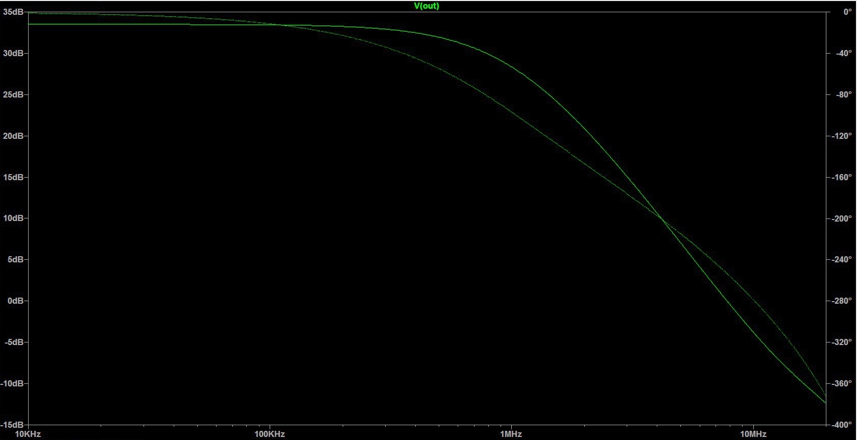

A collection of stages under NFB is liable to have 180 deg of phase shift before the loop gain comes below unity.
The VAS cap must be large enough so it is "dominant", to give a 6dB/oct slope which is a 90 deg phase shift, all the way to unity loop gain (about 20 in power amps since we have 20:1 loss in the NFB resistors).

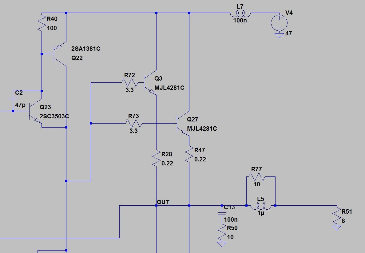

This is the output stage of my amplifier. I do not see any sign indicating any oscillation with 100nH in the wiring of the power suply source. Indeed, in a real prototype, there are 1uF plastic capacitors next to each transistor.
In my opinion, here, the problem is elsewhere, not in the output stage.

I suspect with 1uF capacitors in the real circuit oscillations might be suppressed, but I'd probably use 1uF and an electrolytic too, locally (but this may give rise to half-wave signals as Douglas Self mentioned if not careful).
The problem is as ever a combination of all stages and the gain-phase relationship. My test was only to investigate whether the complementary style format is more sensitive than a straight "triple darlington". It may or may not apply to the circuit here, I have not entered that and simulated it but one post says it works. Your simulations only show the output stage in isolation, I think.
One output stage configuration may be more sensitive (i.e. less phase margin) than another when used with different front end stages, and whether they have power supply rejection (especially at high frequencies) etc. making the front end more sensitive to power supply leads.
In my test circuit adding 10 ohm emitter resistors to the first stage transistors and 2.2 ohms to the driver emitters suppresses the oscillations with the 100nH inductors in the supply line that I see. These are nominally 10% of the next stage base resistors and should reduce the local gain to 0.9 per stage compared with the previous values. In my view this makes them more like the straight triple gain stages. Just out of interest.
Do you mean cdom? What value is optimal?
Suggest adding small capacitors (100uF?) from rails to ground if the leads to the power supply are long, preferably on the output transistor collectors or as close to as possible.
They are indeed long, more than 1m. I'll try.
What is the maximum length of PS lines for not to exceed 100nH? Does it depend on thicknes of conductor?
I simulated with 1uH in series with power supply and a nice solution to stop the oscillations it is a L//R circuit instead a base stop resistor.

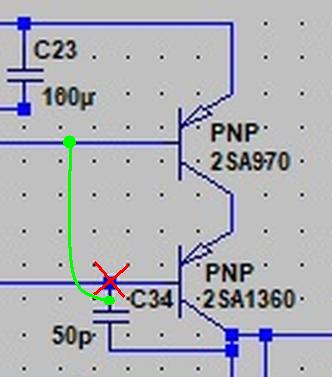

Also, C34 and C35 are connected wrong, they should be connected from cascode transistors collector to the other transistors base, see attached picture.

I tried to connect C34, C35 in a way you showed, but without a change in oscillation.

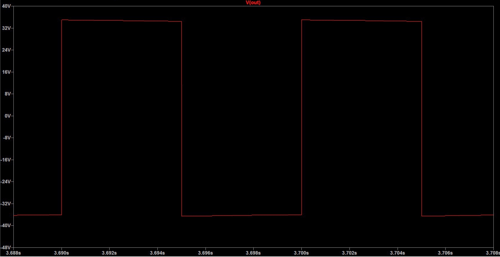

If you simulate square waves you find diferences in working beharviour
