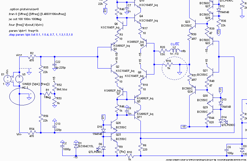

Could you show the Rush cascode(or pairs) in your post #539 schematic? I don't see it.
BR Damir
What about Q4+Q9 (likewise Q5+Q8)?

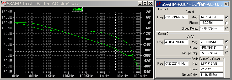

Re GM and PM. Damir found the present compensation give a 20 deg PM and changing the compensation to 100pF gave 60 deg but with 10 times THD at 20kHz. I assume you want to get the THD down to the 1ppm marks so 100pF compensation is not an option for you. Right? You cant rely on simulations to establish the compensation capacitor, you can only get ball park values to start with.
As for the Rush input stage adding more phase (reducing the PM) I did a simulation and compared it with mjona's Post 426 circuit. His PM was 16 deg or about the same as Damir's for the Rush version with the same 39 pF compensation and a 1nF load. The Rush version has about 6dB lower gain due to pairs having two b-e junctions in series which doubles THD at 20kHz (all other things staying the same).
I am happy with the Rush input stage as in Post 539 (sim4b) since it provides high input resistance for the noninverting input and a medium input resistance for the inverting input. Note the input asymmetry -- so you could get away with calling it a CFA topology. Just to explain further, my earlier versions (Post 516 sim2b) had the same medium input resistances for the inputs and that's why I said it was VFA. I slipped in this change into sim4b without mentioning it.

The attached circuit has the first buffer removed.
The AC plot shows how to measure GM and PM (this method is approximate only).
Disable the input filter (C13,C22 zero) and short cold side V3 to common for SE.
Move Cursor 1 to read -180 deg.
Move cursor 2 to 23.5dB.
Read the GM in dB and PM in deg.
Tip: It is helpful to read and write down the gain at 1kHz to compare if compensation is changed; then subtract 23.5dB (for 15k and 1k gain setting) to get net feedback dB (here 76dB). It shows how the THD at 1kHz will change with compensation changes (it's quicker than doing a .trans run to get the new THD).

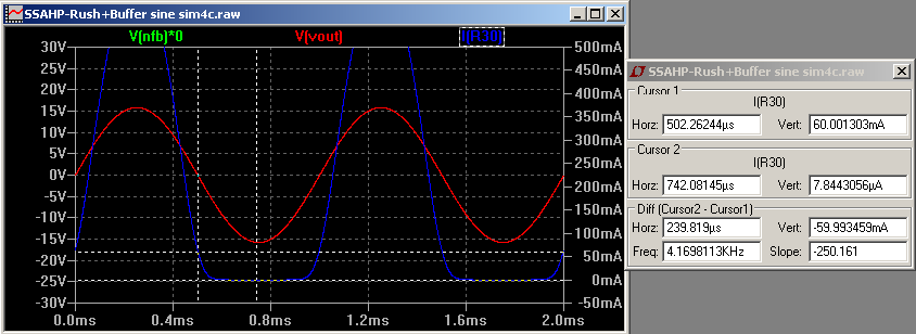

The attached circuit uses the standard triple Darlington with Laconthi 'T' resistors. I have reduced the base and emitter resistors to earlier values and biased for a higher current of 300mA to suit these resistors for minimum crossover distortion. A Darlington is known to be more stable at HF and with temperature changes than the other CFP. I also reduced the input stage current to 1.3mA to give more open loop gain.
The net open loop gain increase is about 6dB to 126dB. Then changing the compensation to 27pF to return to the same feedback at 1kHz as in earlier sims. The GM and PM are now 8dB and 25 deg, about the same as before (9dB and 22deg).
The THD at 1kHz with the buffer and inverting input shorted is the same 1ppm, or 0.08ppm without the inverting buffer. Notice most of the distortion at 1kHz is from the buffer which is outside the feedback loop.
The THD at 20kHz with the buffer and inverting input shorted is the same 2ppm, or 1.3ppm without the inverting buffer. At 20kHz most of the distortion is from the amp and not the buffer.
Overall, not much to be gained for GM and PM using this Darlington output stage over the previous CFP. I'd stay with the CFP unless you get HF oscillation problems when you make it (again).

I think 300mA is too much bias, almost nobody will use such a big heatsinks required. In Roender's FC100 amp there is the same RE but 150-180mA bias set for minimum crossover distortion.

When you do an AC run you usually set the AC source to 1 volt. This gives 0dB on the magnitude axis. The amplifier has feedback attenuation of 15k and 1k so you subtract 20*log(15) or 23.5dB from the gain read at 1kHz to get the net gain that is available for feedback. This is the amount of gain that is available to reduces the distortion of the amp (which is mainly generated by the output stage), in this case the open loop distortion is reduced by 76dB at 1kHz with 39pF compensation.Hi Ian,
What do you mean by 'subtract 23.5dB (for 15k and 1k gain setting) to get net feedback dB (here 76dB)'?
Now, if you increase the compensation capacitor, or use your shunt compensation, or use any other type of compensation, then you can immediately get an estimate of what the new distortion will be at 1kHz without needing to go back to a .trans run to get the THD at 1kHz. EG 6dB less feedback means twice the THD. So you can save time this way.
You should find that when you increase the Miller compensation capacitors you will get better phase margin but higher distortion. You trade-off PM for THD. So the only way around this effect is to use a better type of compensation.

I read in Bob Cordell's 1st Ed p91 "power amplifiers should have a gain margin of at least 6dB ... and a phase margin of at least 45 degrees". His Figure 4.10 shows a PM of 45 deg gives 3dB of peaking and 40% overshoot with a squarewave.
To get 0dB peaking the PM needs to be 58 degrees. So 60 degrees would be the ideal PM to aim for with a typical 500pF speaker cable. And the gain margin should be no less than 6dB.
The gain difference at the "hot" and "cold" inputs is normal. A similar query to previous. It is due to the action of feedback to the inverting input. It's basic to OPAMP's, these may help Opamp-1 Opamp-2 Opamp-8. With feedback the inverting input of the opamp becomes a "virtual earth" and has a low impedance. This means the new inverting input is taken before the input resistor and not the opamps inverting input. The new inverting input is now the "cold input".Hi Ian...
Why there is so much gain difference, and input impedance I guess, at hot and cold inputs: 1V vs 10mV input signals amplitude? Does it correct operation?
Do we really need L1 and L2 in the circuit? Are there a ways to further decrease components count?
For more details see Walt Jung's book here. It explains CFA's and p126 Fig.1-16 shows an early tube CFA.
Re L1 and L2. L1 is the output inductor. This has been covered previously. It is necessary to stop this amplifier oscillating when driving capacitive loads in the range of 2nF to 2uF. Commercial amps have to use it in case someone drives loads in this range (even then some commercial amps have 'smoked' when driving ESL's). DIY amps can often get away without L1 because the normal speaker cable load capacitance doesn't cause it to oscillate. You could include L1 and short it out with a wire bridge if you are comfortable enough to not use it at home. But if you drive ESL's or loan it out then be sure to break the shorting link.
L2 is not part of the amplifier -- it is a clever trick that Bob Cordell has taught us -- it's to measure the open loop gain and phase of the amp while still preserving the DC operating point. It is there as a simulation aid. When you do an AC run you set L2 to say 1G Henry so the LF roll-off is below 1Hz and doesn't appear on the AC sweep from 1Hz up. When you do a .trans run you set L2 to 1n (Henry), so it is effectively a short giving us closed loop operation.
AC runs are done open loop so we can view the GM and PM. One probe at -180 degrees requires a net gain of less than 1 or less than 0dB otherwise oscillation can occur, which usually destroys you amp in seconds. If the gain is slightly below 0dB then you get ringing; this indicates you are dangerously close to oscillation, hence the need to get closer to critical damping where ringing doesn't occur with a squarewave. PM is a better indicator of ringing and as mentioned earlier we should aim for about 60 degrees ( more than 60 deg is OK -- it indicates you have a healthy extra safety margin).

Re: settings for SE operation. See attached. The bottom of the input voltage source is connected to common with a link wire. R16 "cold side" is grounded so the buffer can't add distortion (due to it's nonlinear output resistance). That should return 0.08ppm THD at 1kHz and 15V (1Vpk in).
As mentioned earlier, you get lower THD sims at 1kHz without the buffer enabled.
For balanced inputs the buffer is used and the input source is floating.

Re: 300mA bias. You may be looking at sim5a where I reduced Re's to 0.1 ohms which needs higher current for optimum bias. Previous sims with 0.22 ohms and 10 ohm base resistors have minimum THD around 200mA.
Re CFP. It has more internal gain than the Darlington. This is because the Darlington has two b-e diode junctions in series so the internal gm is halved, now 0.5*Ic/Vt or 13mA/V at 1mA. At HF the Darlington is more stable and can have the driver charge removed faster with a Laconthi 'T' resistor (~2*Vbe's across the T resistor versus one Vbe for the CFP b-e resistor).
Also, RET power transistors, when used in Class-AB have the problem of a low FT when they turn off (near zero crossings) unless a non-switching 'stay-on' topology is used. This means more compensation for a given PM than a Class-A version or a non-switching version. EG Damir's Class-A amps give consistently high FT's so the THD can be much lower than in Class-AB apart from the higher crossover distortion.
That's why it is so...so hard to get sub-ppm's THD's at 1kHz AND good PM's with Class-AB.
