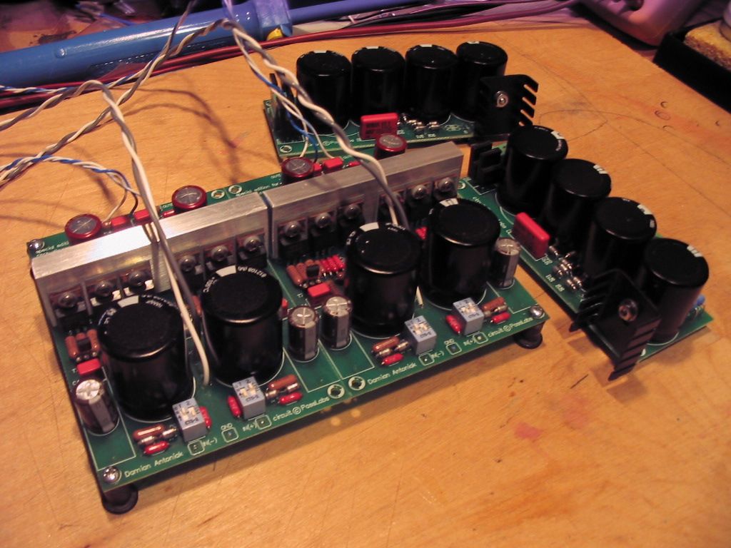

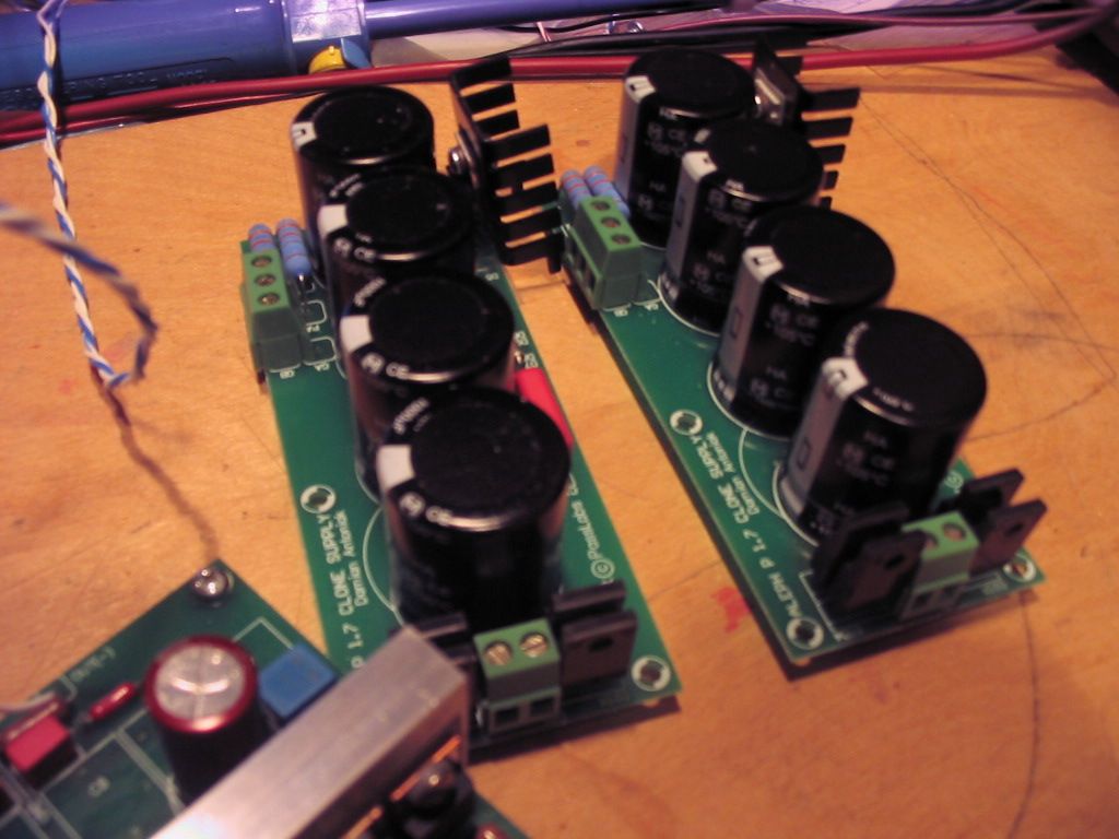

Hi there...Still have these if anyone is interested.
What is required to complete this as a pre-amp?
How much are you after for it?
This would require a transformer and your choice of input selection and volume control. At a minimum it would require a selector switch capable of handling balanced signals for up to 4 inputs, and a 4-channel pot, such as some of the Alps pots available on ebay. Plus jacks, casing, etc. PM me if interested.
I am asking $140 US plus shipping, but feel free to make an offer, as I don't need these since buying a commercial Pass Aleph P1.7.
Only premium parts used throughout. Vishay-Dale RN60/RN55 resistors, with PRPs in the signal path; Panasonic TS-HA 1000uf/100V caps for PSU filtering. FETs were from Taraesque and matched (and I have a couple of extras). Coupling caps are Elna Silmic IIs on input (10uf), Elna Cerafines on the output (47uf), both bypassed with Vishay 0.1uf MKP1837s. I also have some 47uf Elna Silmic IIs for the output that I would include. Black Gates were not easily found when I built this, and the prices were getting pretty stupid for questionable value. If anything, film caps would be better in these positions. Nelson Pass likes the Silmic IIs a lot also.
