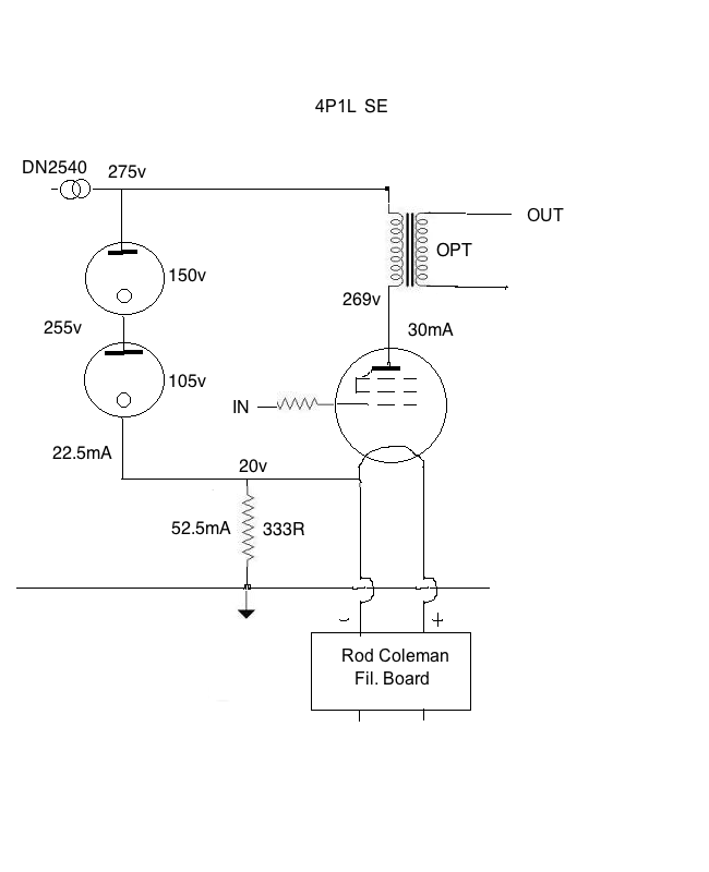

One more 4P1L SE

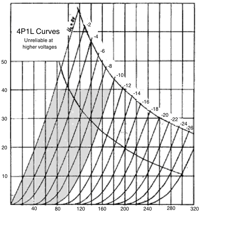

Here are some curves, but they are unreliable at higher voltages - the actual bias is about 2v out, like at 220v and 30mA it's nearer -18v than the stated -16v

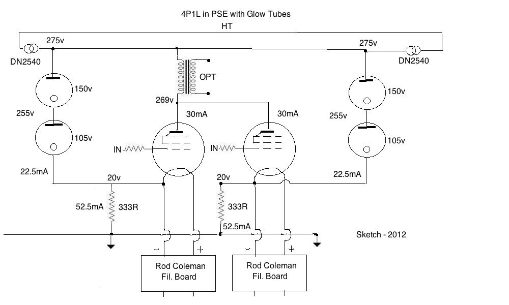

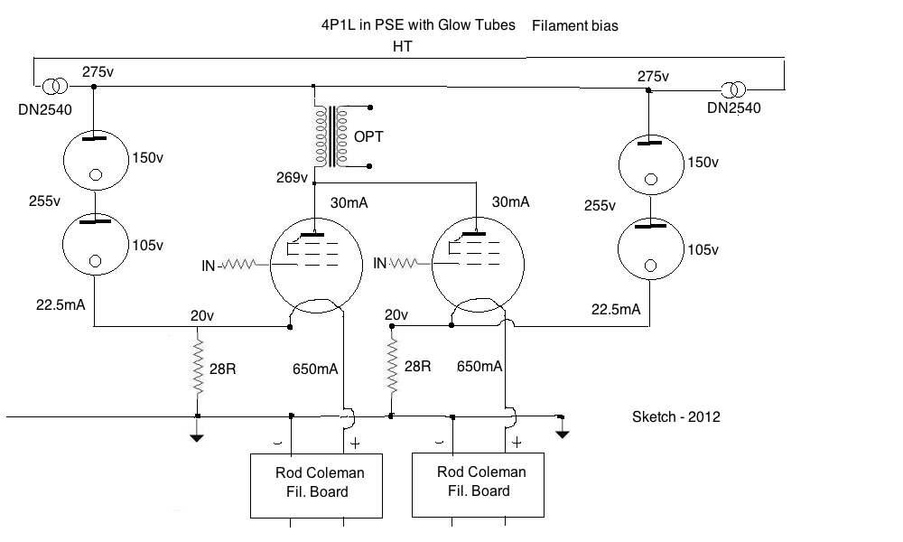

But all this ignores what for me is the BIG reason to use the 4P1L. You can use it in filament bias quite easily. What does this mean? It means tiny cathode resistor and no cathode bypass cap. If you compare PSE 4P1L with SE 6C4C, both with conventional bypassed resistor bias, then it's no better. In filament bias it IS better!
There are not many DHTs that can be used as outputs in filament bias. The 4P1L is easy. 6P21 is possible - haven't tried it. 10Y is possible but getting more difficult to implement. 6C4C and 300b are just too demanding. Scrapping the cathode bypass resistor removes a veil to the sound and is an important upgrade, but then you need a small cathode resistor and that points to filament bias. Fixed bias is another option, but then that has to be absolutely pure to sound good. I never achieved that.

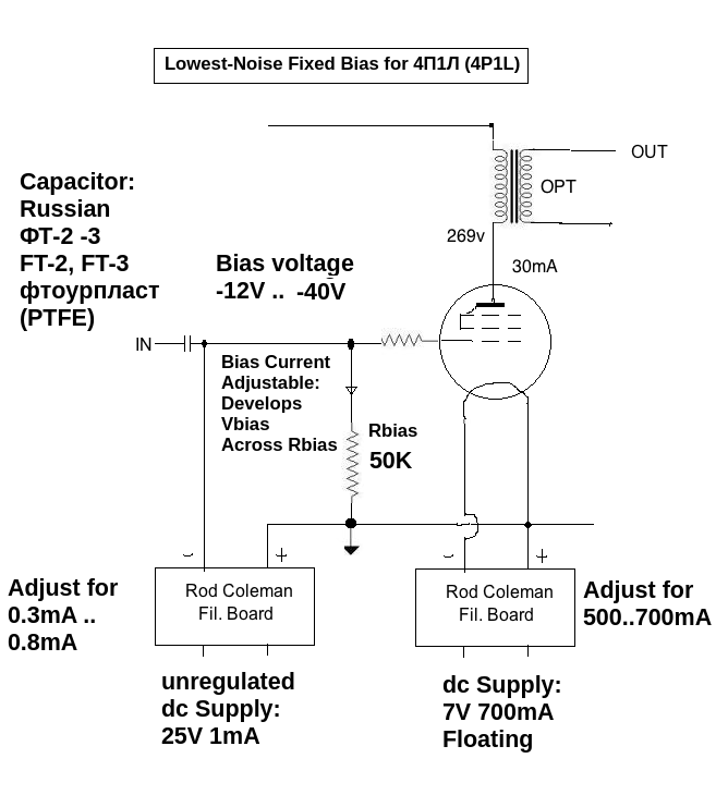

Hi Andy,
If you don't like fixed bias, it's more than likely the lack of noise rejection (passive solutions), or real noise injection (any regulator with a bandgap reference - i.e. 99% of them).
If you like the bias performance that the Filament Regulators provide, but don't want to deal with the huge power dissipation, you could try separate regulators for each.
The diagram shows the idea. The Filament is heated normally, and a second regulator provides an adjustable current that is fed into the 50K bias resistor.
0.5mA gives 25V at very low noise - probably 100x lower than typical gas tubes. In fact the noise should be lower than with filament bias, since excess-noise in resistors in often proportional to current.
Recent regulators are temperature-compensated, allowing a stable supply to be developed. Why not give it a try!
