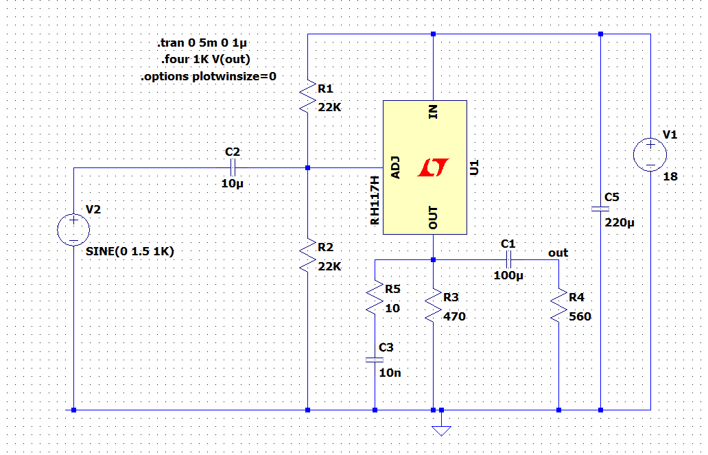

I see a diode, a Ker and an additional Elko.In the meantime, I have tested the 317 version in real life:
I understand only the Ker. Can you please describe the others / update schematic?

Here it is:I see a diode, a Ker and an additional Elko.
What you identified as a diode is simply the 10 ohm carbon composition resistor
Thanks LV
I thought it is a reverse protection diode cross the IN/Out of the regulator, but C1 is not such a big reactive load to put any problems. Besides then, the Keramik missed a resistor to make a snubber. Sorry it just looked very similar to a diode !
I wanted yesterday to ask you at which frequency the snubber should be. Now I know

LV, can you please comment?will put the FET CC instead of R4. (will this not increase the OUT noise?)
Clearly, the distortions will be lower compared to one-BJT + R4.
But Noise? What behavior should be expected?
Don't worry. A JFET current source usually produces more noise than a resistor with the same DC current and DC voltage drop, but that noise will still be negligible compared to the collector shot noise of the bipolar transistor.
By the way, parasitic oscillations could be a cause of excessive noise, as could a damaged transistor.

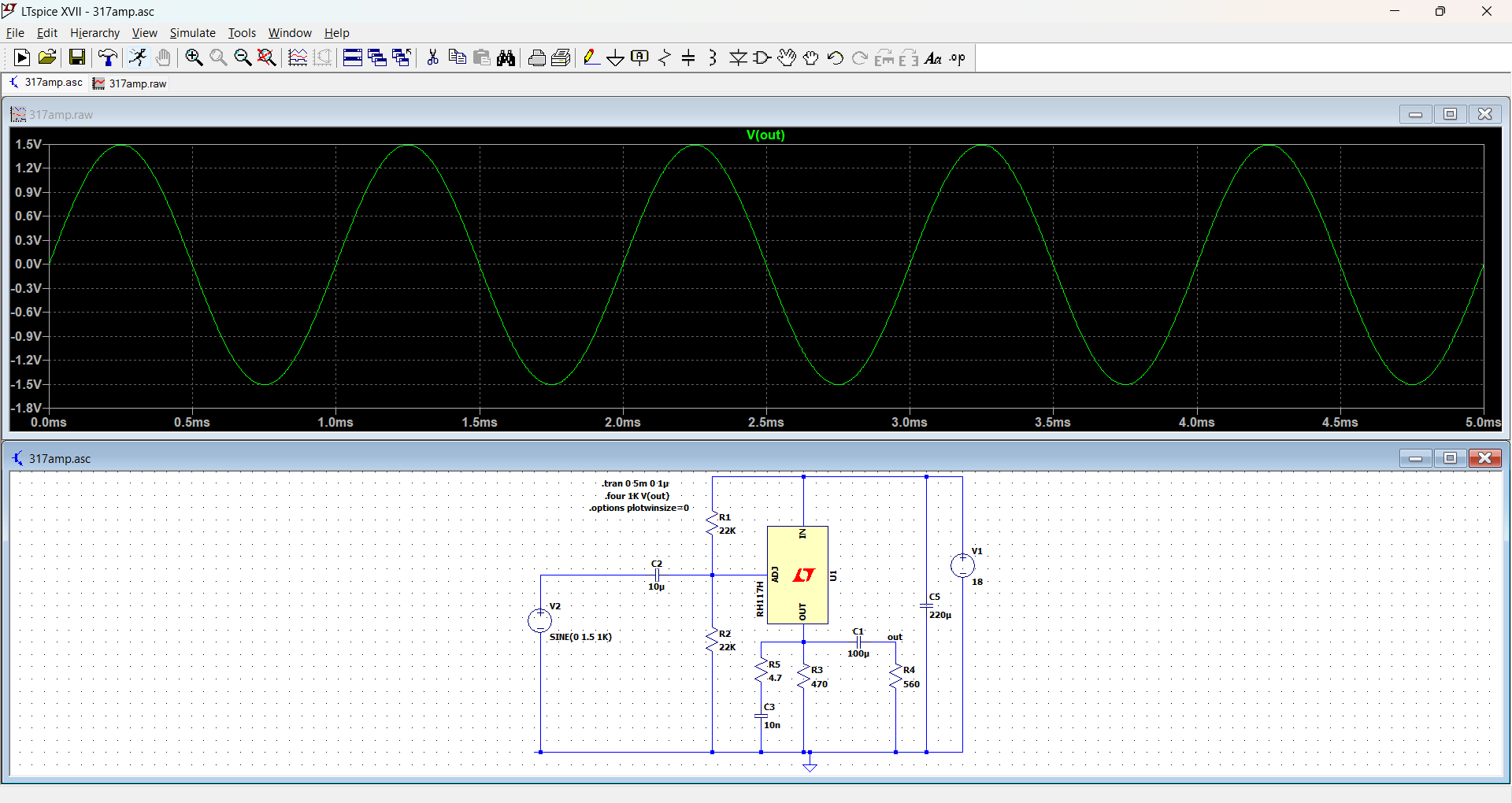

I have measured the THD of the 317 circuit (@ 1kHz, 8Vpp out, 560ohm load): it is 0.0015%, thus a smidgeon above LTspice's prediction, as expected.
In the same conditions, the full power bandwidth is ~36kHz. Not extravagant, but certainly sufficient for regular audio applications
An afterthought: the 36kHz limit is most probably caused by the reactance of the Zobel's capacitor: 10nF @36kHz is 445ohm, to be compared with the 470ohm current sink.
Lowering the 470ohm would probably extend the bandwidth, at the expense of the current consumption; however it would also increase the available output power.

Yes, it seems lowering R3 to 100 ohm makes it suitable to use 80 Ohm headphones but it needs cooling.Lowering the 470ohm would probably extend the bandwidth, at the expense of the current consumption; however it would also increase the available output power.
I have tweaked the circuit, and remeasured its performance. The optimum value for the Zobel's resistor is 4.7ohm, but 10nF for the cap remains optimal: going lower endangers the stability:
I have remeasured the THD in better conditions (better GND connections, etc.) and it is in fact half of what I measured initially: 0.0007%. Note that the 317 is a cheap Chinese one, bought from Banggood
