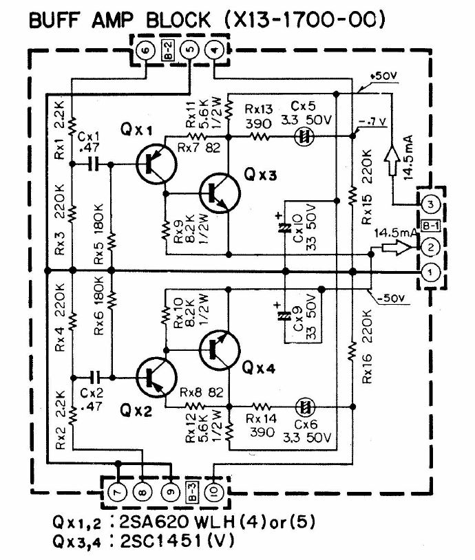

Can I replace BC556 with BC560 as drop in?
Can I replace 2SC5876 with a general purpose type as drop in?
How much impact from these changes for stability and performance wise?

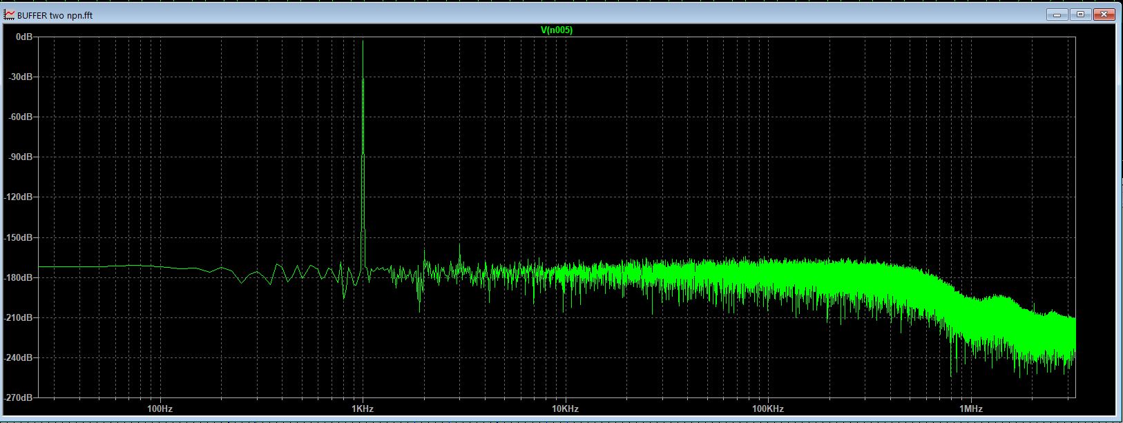

Hi to check the THD i am using LTSpice and the models available on the basic configuration I am still struggling with adding models ... i am a little retarded
Anyway i am attaching the original buffer present in the old vintage Kenwood 700c
My curiosity was originated by the very positive opinions on its line stage sound ... very clean and detailed
My principle is that an amp chain that sounds good must be formed by stages that sound good by itself
I am usually look at those stages following the volume pot and called flat amp or buffer amp or output amp to understand a little about the schematic
However i have been convinced that when really great performance are the goal nothing but better opamps
I see some very high end manufacturers switching from discrete circuitations to opamps these days
And i am talking about price of 140 kUSD o_O

I see now clearly your point Of course you are right At very least LTSpice is very useful to see what will never work
I have begun simulating commercial units that should work I see that very low THD+noise are very difficult to achieve even at simulation
I cannot imagine how hard is to get that in reality I think that LTSpice fixes the max performance obtainable in optimal conditions (perfect power supply)
I am trying to understand a little about theory using it I am afraid i have to study a little theory first

This seems similar to Input Amp and Rec Amp on Revox. The two current TCA stage amps, but maybe I am wrong.

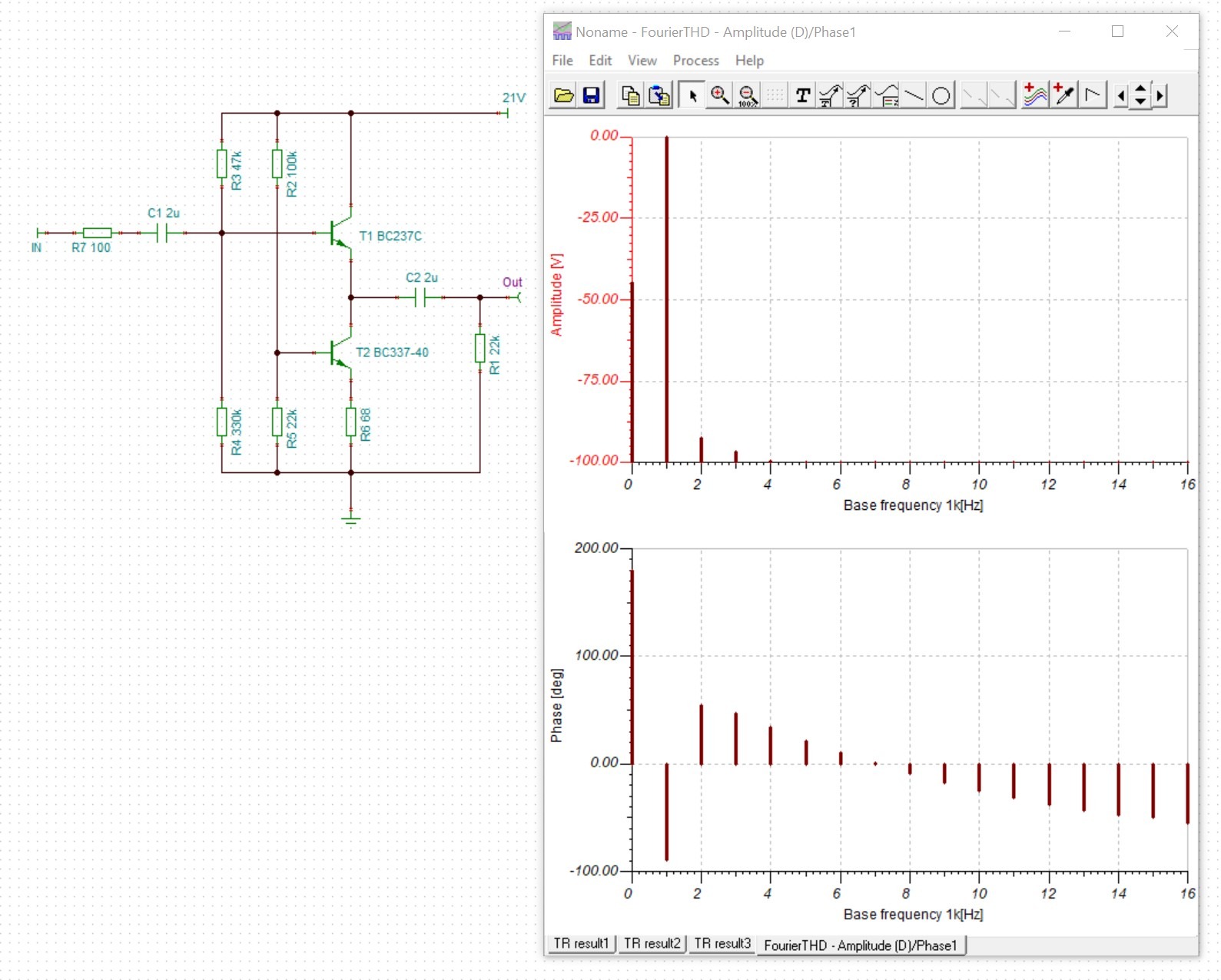

FYI, simulation on TinaTi does not show such a stellar THD.
Hi and good morning This is quite worrying because the sim runs smoothly :rolleyes:
If you will find the time could you kindly sim with TinaTi the attached circuit and see what THD comes out ?
just to run a check

With R1=22K load Tina gives this result: see below. It is slightly worse THD (0.003%) than the LM317 optimized by LV and Marcel, but let's see about the noise.
With 10KOhm loaded lines the THD will increase to 0.01% and for Headphones 600Ohms the THD will further increase to 1.8%, according to Tina. Maybe it is not optimized...
In contrast, the LM 317 performance for THD is stable also with strong loads.
Still, I will try to build it to verify and let you know.
  • Thank You

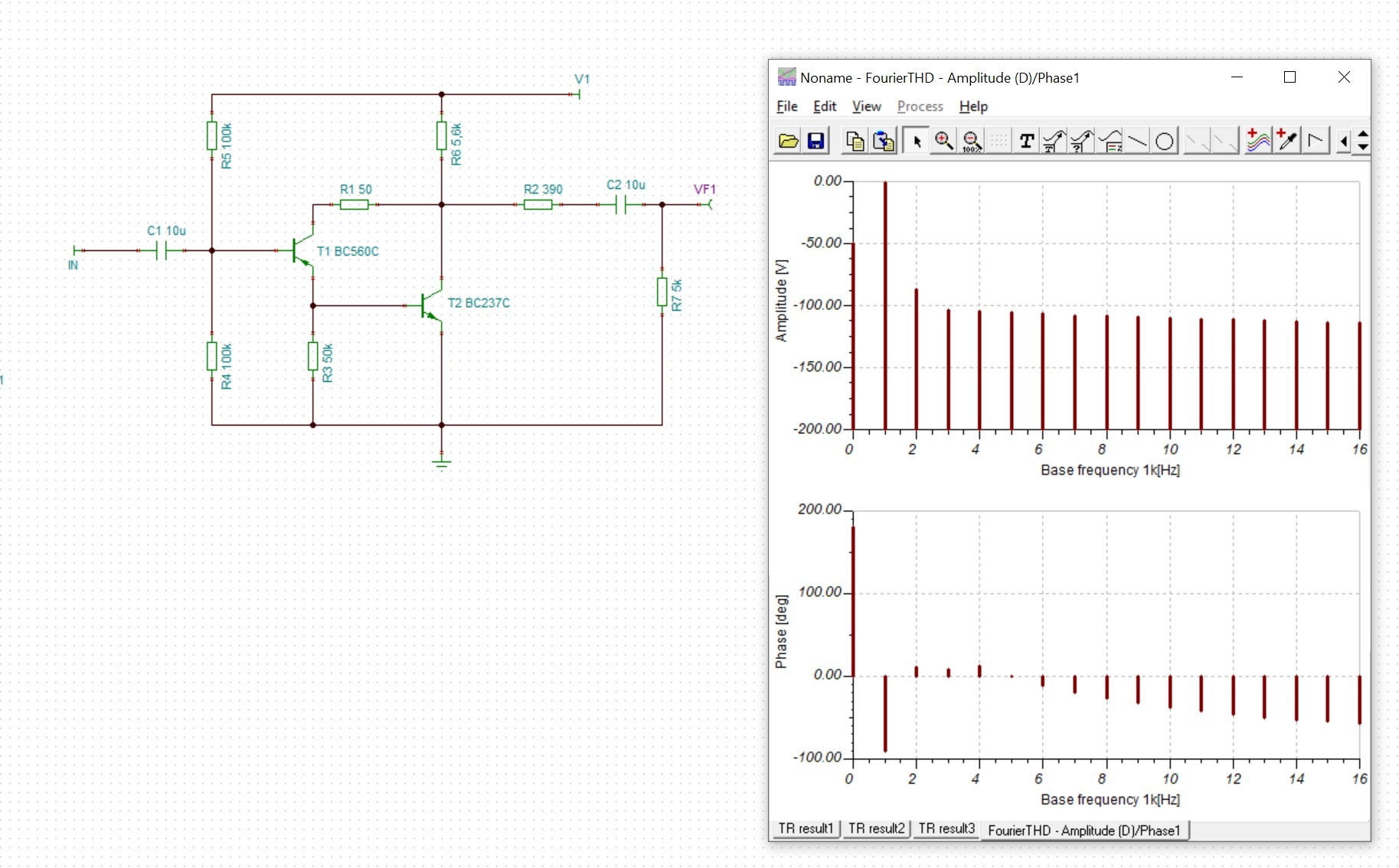

This is the Tina result (below): same H2 as above, but H3 is decreased slightly to just below 100dB. Beware of my changes to 'optimize' and make it work for 21V.
For 70V and Biased accordingly, the THD will be significantly better. Not sure about the noise.
For LM317 (using TI proprietary model) the Tina predicted almost identical as measured results.
I would be happy to spend some money for a professional version of Tina, but I would probably not do this for LTSpice. No offense to anyone.

I missed that you want to drive headphones Sorry my mistake :confused:
Instead I am looking for something driving only a power amp
The lowest Zin i have has a 5kohm/ ?pF input I have read to add 1nF of capacitance in parallel to the resistance I have to do that
Again i am sorry I missed your requirements
I am a beginner and i think that is wise to start from a line stage Then if i get something we say appetite comes with eating
Your Kenwood proposition will also be built.
As you see, the results above are for 5K load and almost as good as LM317.
The 10K or 22K simulations are slightly better. Many thanks!
It will worth my time to try to build it for measurements (without headphones), but at the end of the day it will be hard to implement it in my PCB without cutting at least one trace.
