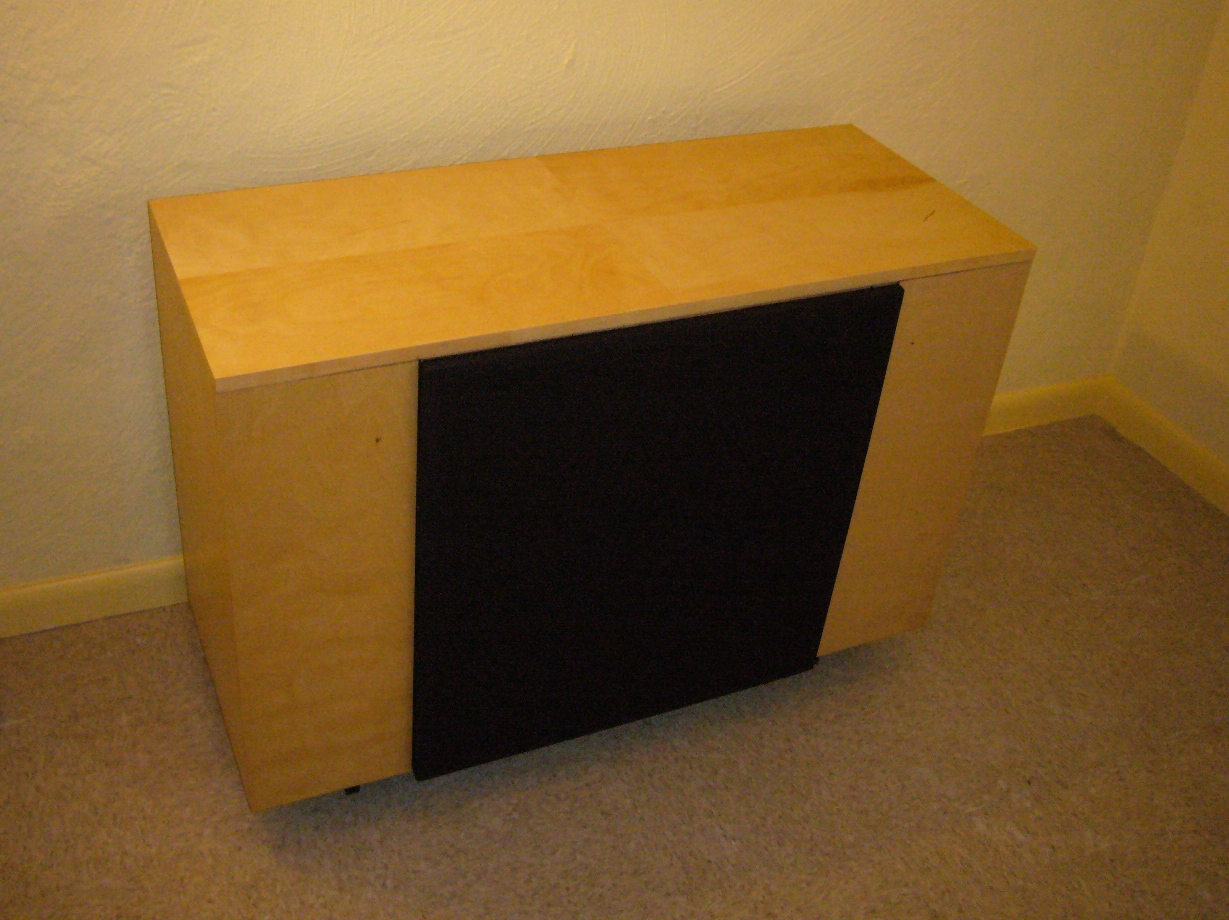

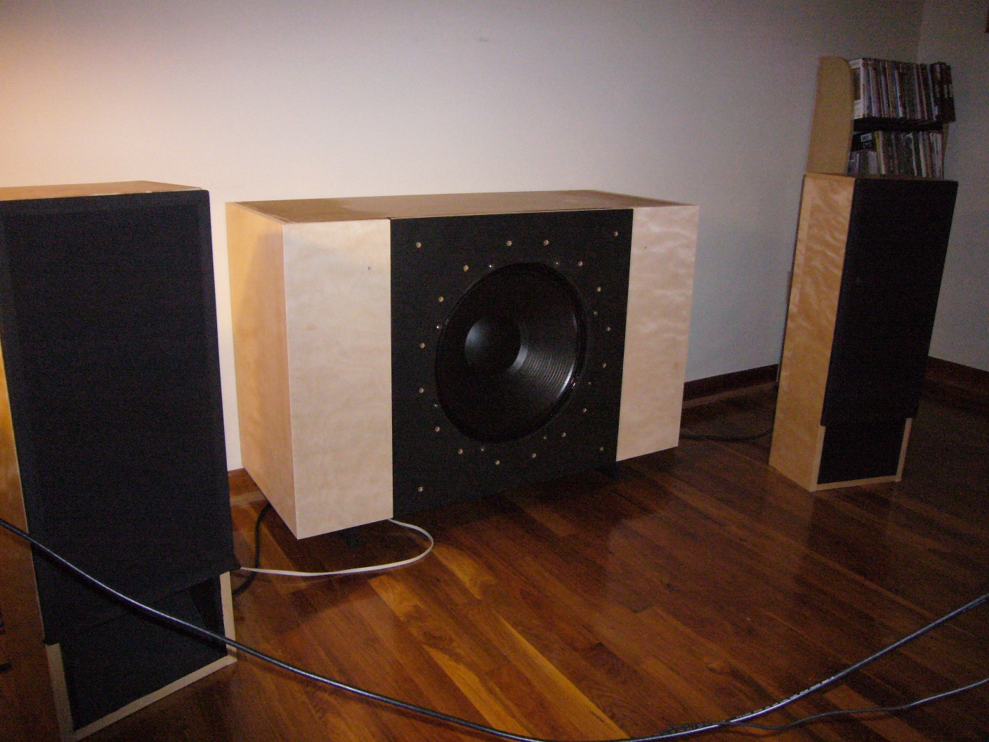

Personally i like to use pairs in push-push so as to get active vibration cancelation, and reduce the load going into the box.
Can you give a broad example (pic)...... Push-pull also uses 2 opposed woofers, but is harder to mechanically. It does indeed reduce 2nd order distortion but at the expense of 3rd order (but only if you are using "cheap" woofers out of their linear range. If the balance is tipped such that 3rd is larger than 2nd then it likely willsound worse.

would you mind to give an example of the box you are talking about for better visualization of the mechanics involved.
An early illustration of an all out assault on the idea, using a woofer specifically designed to make it possible.
toobz woofer
More practical examples can be seen in many of my FR bipole drawings, microTower and Thirlmere-R are 2 good examples.
(the 2nd set are Castle versions and don't take advantage of the push-push)
KEF were the 1st (that i know of) to introduce push-push with one of their 104s (?) -- 2 8' in a bandpass box and a connecting rod between the drivers. I had been introduced to the idea before this, but didn't take advantage until i started building subs. It has been used more and more often (by a number of vendors), and the latest incarnation is the KEF blade.
Anytime i can, i use this technic, particularily in woofers where the most can be gained -- almost for free it gives you the opportunity to remove, say, 90% of the mechanically transmitted load into the box. allowing for an easier to build, lighter box with a lower noise floor (and one that doesn't walk across the floor).
