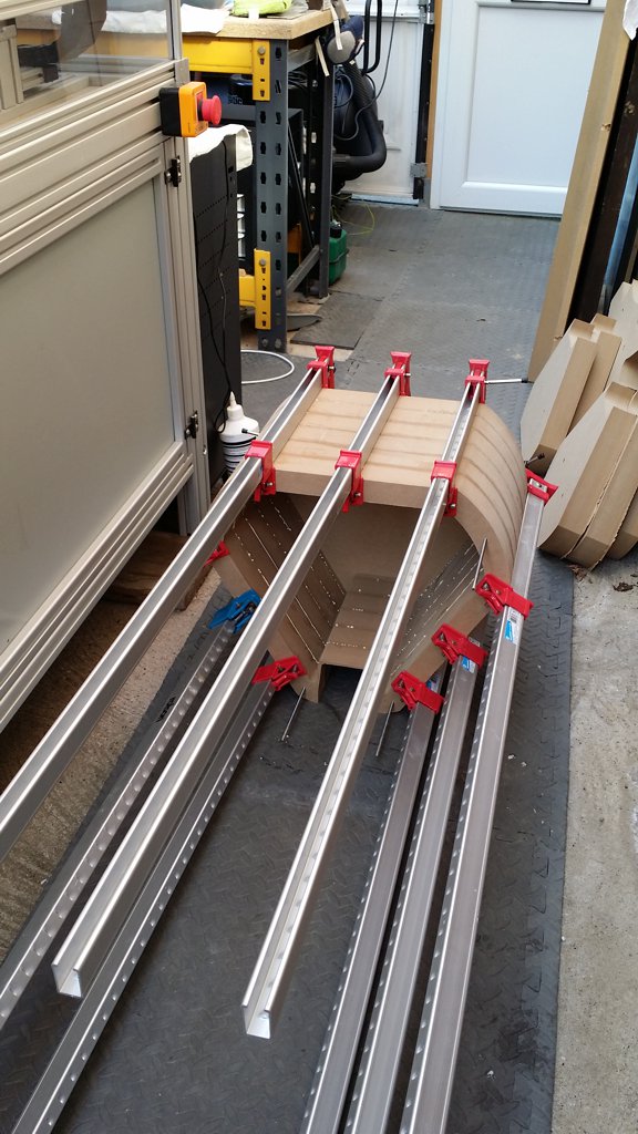

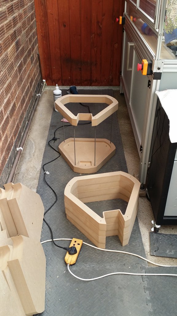

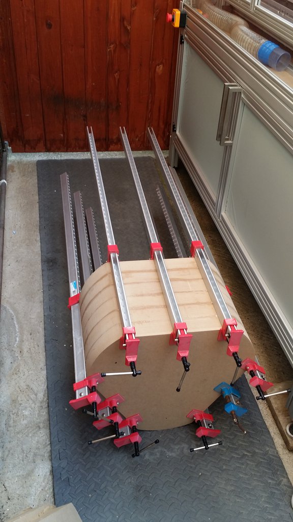

Made some progress on the subwoofer. Construction is laminated 50mm MDF with 30mm thick wall sections.

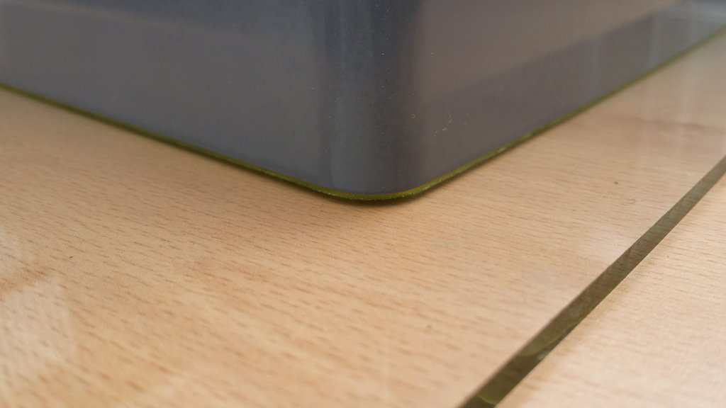

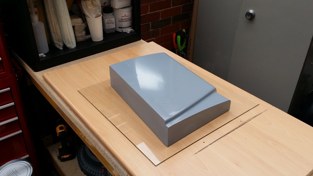

And preparing one of the sides of the standmount to create a mould. What your seeing here is the prep work. Since this is a two sided part its placed on a flat surface and what this will do is create a flange that allows the two halves of the mould to seal against and align.
This last shot shows the filleting wax used to seal around the part against the flange so the gel coat doesn't run under.

Beautiful workmanship and design, but I don't like the sub. It would work better in room as 4 separate enclosure a la Audiokinesis Swarm or as a pair of dual opposed. Depending upon how much EQ is needed to get them flat, there's potentially going to be a huge amount of heat in that enclosure.

What Brett says, having two Dual Opposed subs would be better for sonics than a single 4 device sub.
That said you'd also get better force cancellation if you got rid of the bottom firing sub driver, or placed another one on the top and had 5 inside the same cabinet. You could use passive radiators and have two real sub drivers, one mounted on top, one mounted below with three passives along the sides. For real performance though, in a dual opposed design, you want one driver with the magnet facing outwards, although making that visually attractive might be hard. If you had the bottom driver with the magnet facing outside and increased the height of the feet it sits on, or created an elevated plinth like B&W do for their 800 series, then it wouldn't look bad.
I do like the aesthetics of the sub, it's just not the best you could do for the technical performance where you ideally want as many drivers facing out as you have facing in with all the drivers firing in directions designed to cancel out all movement that would shake the cabinet.
