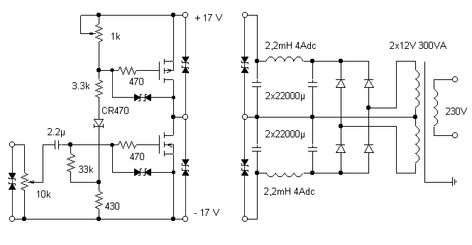

john curl said:Protection diodes are not as necessary in this design, because there is no stepup transformer.
So what if there's no step-up transformer? What difference does that make? And how does this circuit guard against damage from ESD events?
Of course the BUZ900DP has the protection diodes built-in if I'm not mistaken. But what if someone goes and uses other devices?
However, there is no gain, either.
No gain? What do you mean? The input's driving the bottom MOSFET's gate and the output's taken from it's drain. That makes it a common source amplifier no?

This may seem redundant, but I feel really foolish. I 'saw' a completely different circuit that what is presented here. I actually 'saw' a zener biased complementary mosfet follower, without source resistors, by an added connection and reversing the parts in my mental picture. It is a good lesson for me to look carefully first, before commenting. I like the pi filter power supply.
The more that I look at this design, the more that I see that I first missed, such as the CR470 'current source' I though that I saw a zener. This is sort of a Norton equivalent of the circuit that I normally would use. I hope that I have beaten SE to any other criticism of my initial remarks.

The input impedance of the amp..after the pot is 33K +430 Ohm...

I was wrong, and I did it from 'poor' memory. I am running out of paper, so I didn't print out the schematic. Then, in my mind, I saw 3.3 rather than 3.3k, the CR470 became a 4.7V zener, and an extra connection was made from the CR470 to the 2.2uf cap. It is a real lesson for me, but please disregard my first posts on this topic. I screwed up.

I see no current stabilisation resistors, wouldn't the Voffset be large
The off set will be large and without stability...and the amp will behave as a current source...without any damping in the load...
More an exercise than a really amplifier...i guess

4.70 mA according to the datasheets.
IIRC, the CR470 runs at 470 uA.

So, yes it was designed for an easy load. Doesn't mean it can't be improved.

Ideally suited for a FR speaker with low Qts or an actively filtered system.
tschrama said:Lets put a 0.5R in the source of the lower transistor to ground and a 100uF cap from the top of that resistor to the gate of the upper transistor....
