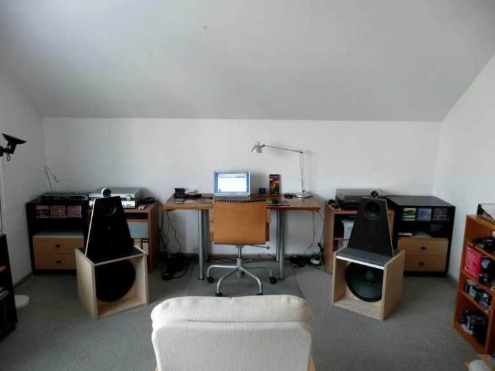

that room is somewhat my office. I would not dare to let your sharp eye look into one of my more private rooms.
Indeed you are extracting (too?) much detail from the data . The cross over from the H frame woofers to the OB mids is ~300 Hz. I have published some more information about that room and system at audio circle. The front wall (behind the speakers) is a dry wall in the lower part and wood in the pitched roof area. There is a brick wall to the right and back. Left wall is a combination of glass, brick and dry wall. Floor and ceiling are concrete.There is a cross over at 200Hz?
You may be right. But notice that there are no special acoustic treatments in the room. No absorbers, diffusors or bass traps. Just room high shelf units at the back wall, which might work as a sort of diffusor. And a dense short pile wall-to-wall carpet.You seem to have a great room! ...

I am trying to get the best possible dipole 8 pattern from my system.

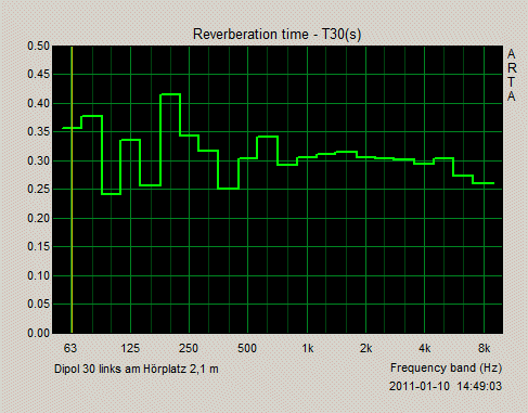

As a last detail I include the (not normalized) RT30 diagram:

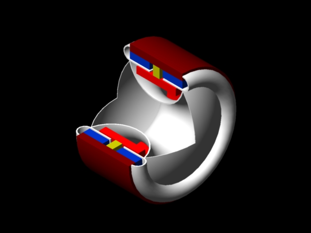

What about a special dipole-tweeter that uses one voicecoil for a backside and a frontside tweeter. That should be small and thin enough to work perfectly up to highest frequency. The problem is you can't use pole pieces in this configuration, but two rings of NdFeB should to pretty good as well
Here's a sketch (voicecoil is 25mm):

Any more thoughts on the above proposal? One obvious problem is that the inner magnet or steel circuit has to be supported somehow... I think a sort of double voice coil sleeve (inner and outer portion) with the outer being split might work. Sort of two tweeters joined back to back by an inner sleeve. Like the quick sketch below shows.
More poking around and I realize this sketch is pretty close to how some tweeters of today look, particularly the hexadym motor geometry. Well, they are half of this sketch at least. I actually think if I had the money and some time I could take two hexadym tweeters and construct a single good dipole tweeter that was effectively a dual motored tweeter... sort of like JBL's differential drive geometry on a small scale. But this is unnecessarily doubling up on some geometry.
I actually think constructing a good dipole tweeter that had minimum thickness and also minimal motor diameter is entirely possible, such that the dipole length was quite small and true dipolar behavior was maintained well into the upper midrange.

Well, if by "o'", you mean old, then I'm at least 50% qualified.
I find the idea clever, but I'm at a loss as to why you'd want to go to the trouble for a tweeter. I haven't read this thread since it was active, so I may be off-base, but here goes.
For much of its range the front and back waves of this tweeter will be decorrelated, i.e., the wavelengths are so short that it doesn't matter if you run them +/-, or +/+ (dipole vs bipole). For there to be a correlation, you have to go low enough in frequency to accomplish it (1 - 2 kHz), and I'm prejudiced against running a tweeter that low (even though millions do it ). From my perspective, your idea becomes really clever when you figure out how to do the same thing with a midbass driver. This way, you get around all of the asymmetry caused by the magnet's "shadow".
For this to be a useful idea the tweeter would certainly have to be physically small. The sketch above is of a 3/4" VC diameter. I'm not sure just how compact the motor structure could be made and maintain thermal performance, but perhaps a dipole length of 4cm or so is possible, corresponding to useful dipole behavior up to 8-9kHz. With such a small tweeter, crossing over low isn't an option, so this leads one on a trail of a significant mulitway undertaking. However, the numbers just work out. That is, if the tweeter is small, and xo point is somewhere around 3-4kHz, the next driver can be sized appropriately to maintain good dipole behavior and still be small enough to maintain close CC distance to approximate point source behavior as well. If you follow the rabbit hole, you wind up with xo points dictated by the two constraints of dipole behavior and CC spacing something like 60Hz, 250Hz, 1kHz, 4kHz, with each driver covering a reasonable 2 octave bandwidth.
OK, so constructing a 5 way dipole system wasn't really the point of this thread or my post, just a progression of answering your question.
Short answer... I think there may still be some use if one is ready to tackle a statement system design that maintains dipole behavior up to within an octave of our hearing limit. I think it can be done. I just don't have the financial resources at the moment to sacrifice a few drivers to find out.
But in that line... I know the hexadym drivers are spendy. Any thoughts on a suitable cheap sacrificial alternative that has a natural compact motor structure? I know there are a lot of small profile and small diameter car audio drivers but I know nothing of their actual motor structure.
My thoughts exactly. In fact, it probably gets easier as the driver gets larger. I guess cavity resonance between diaphragms/cones is a unique problem that would have to be addressed but I think this could actually be leveraged to make very stiff radiating surfaces (think really thick sandwich type construction). But there is no reason the motor topology once figured out can't be scaled in size. Suspension would take a little experimenting... my first thought for larger units is to replace the traditional spider with a sort of integrated spider and surround, with one on each face as is the case with the tweeter sketch. Big subs using crazy stuff like seven spiders... yeah, that might get a little tricky!From my perspective, your idea becomes really clever when you figure out how to do the same thing with a midbass driver. This way, you get around all of the asymmetry caused by the magnet's "shadow".
