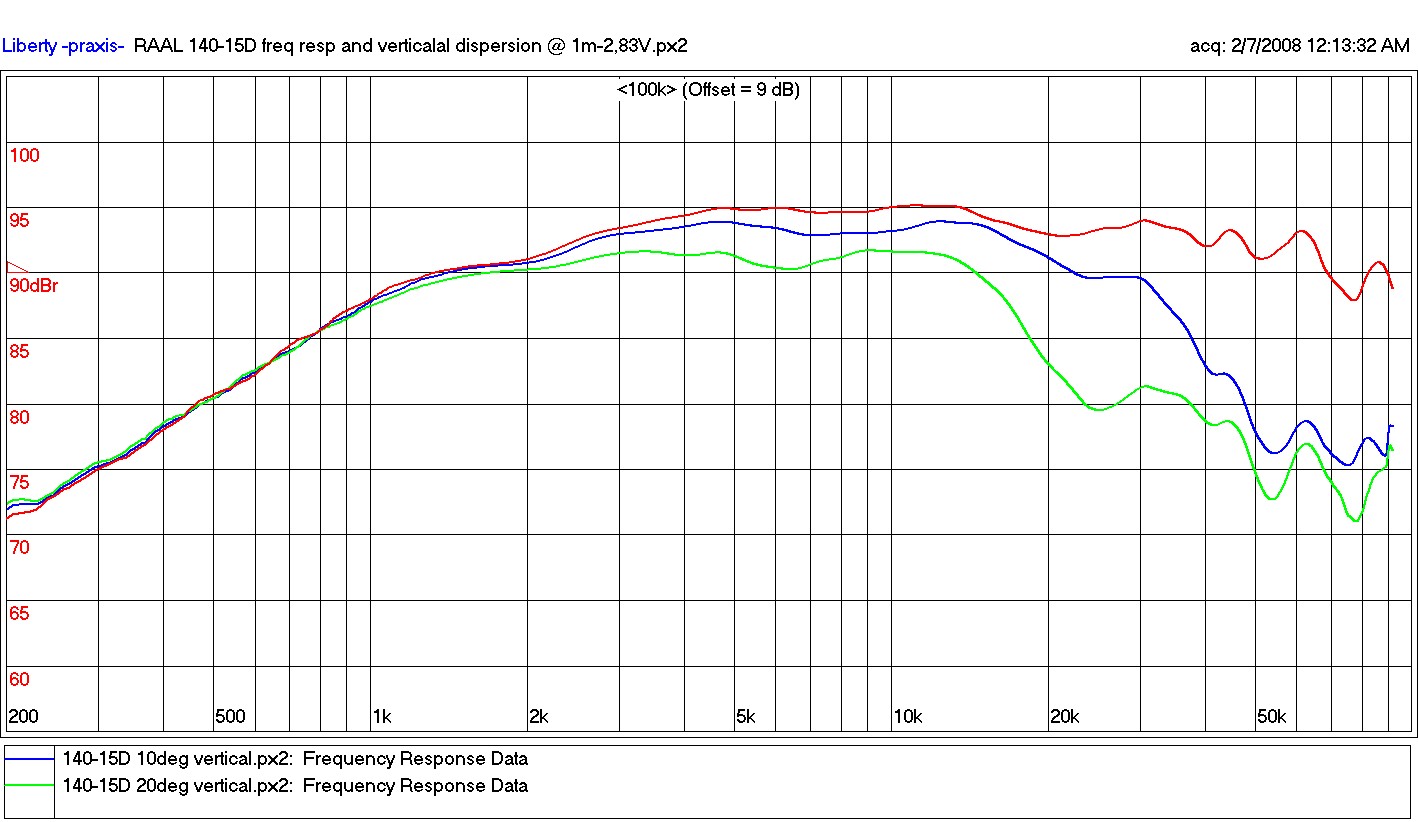

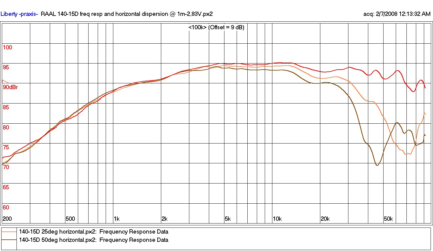

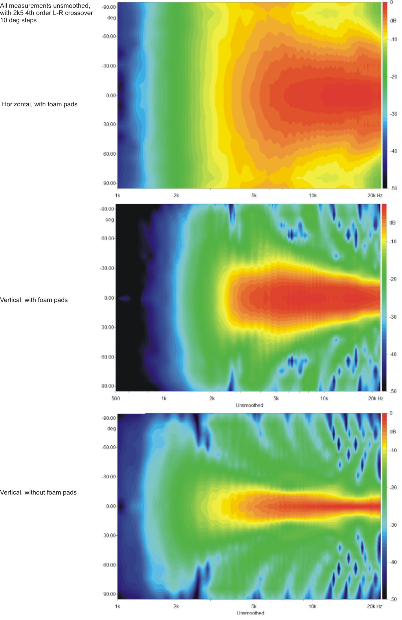

Hi guys,
a friend told me about this directivity discussion, so I thought I drop in a few facts for your understanding of what influences the directivity. I hope you won't mind as much as I did your conclusion. :rolleyes:

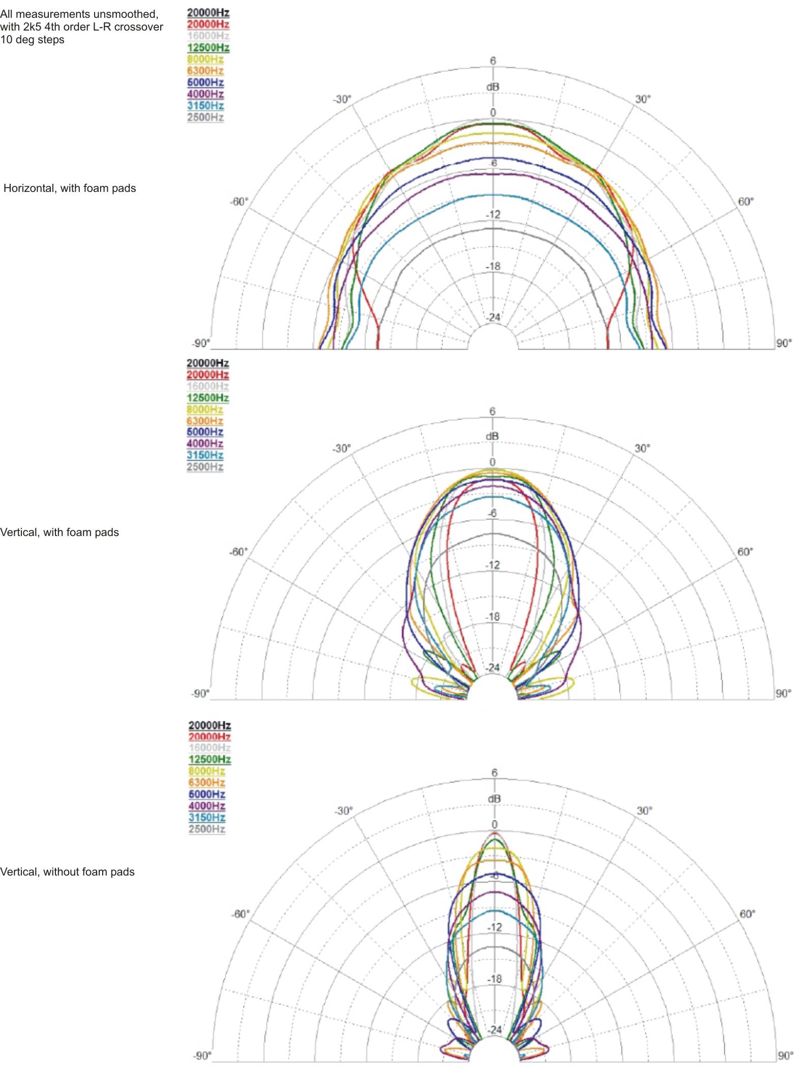

First, in horizontal plane, it's not the width of the baffle that determines it. Its the width in the diaphragm, which in this case is just 15mm, which gives us about 120 deg on 20k.
Second, in vertical plane, even though the diaphragm is a lot longer than the wavelength of 20k, the use of acoustical lens, in form of those two foam pads on the face plate, gives us about 20 deg of vertical coverage without any loss highs compared to mids and no loss of flat tone balance.
With proper baffling, the directivity pattern is almost perfect, rounded, figure-of-eight pattern in a horizontal plane, as the ribbon sprays wider that the open baffle arrangement permits, so the baffle rules that plane, governing the figure-of-eight pattern.
In vertical plane, the foam pads rule the situation, and that behaves exactly the same as closed 140-15D.
Measurements attached, but no polar plots, sorry. Too tedious to prepare for publishing but I'm sure you'll figure out the point from these plots.
I also need to say this: thinking that my designs neglect directivity and that my customers are happy with it, couldn't be further from the truth. The whole point of my designs and of my customers desires, revolves around just the opposite. That is why I felt compelled to explain you gents what's this all about.
On that note, model DIPOLE 140-15D can not be used for stacking into line array, it was designed that way, so the accuracy of a near-point source would not be impaired, as well as symmetry of the front-back radiation, which in turn, allows different usage of acoustic lens front and back, so user could fit the directivity to room acoustics in terms of back wall reflections and stereo depth imaging.
As for the prices, I know, they're expensive, but if it was possible to make them cheaper, we'd do it. If any loudspeaker company out there could make a cheaper magnetically shielded, fully front-back symmetrical, open ribbon with this directivity, efficiency and reliability, they would, trust me, and they would have a market for it. The point is that they can't speed it up more that we did. To retain the quality I aim for, it takes a company of five highly skilled people and a few outside machining services to be able to build 50 of those a month, making them only. Once you put things on paper, add shipping and distribution, that what you end up with for a retail price. I can't fight the way the world of economy works, and nobody can. At least we have a choice, and my choice is this: Hopefully, with ever-growing support of our customers that graciously buy our stuff, RAAL will eventually grow into a large company that will improve the manufacturing efficiency and bring out good new products for affordable money. Right now, we are more of an artisan's shop that does things the way any artisan's shop does.
And so on and so forth...I could talk about decisions I needed to make all day long and positively bore you to death!
I wish you a very happy New Year!
I'm off now to "enjoy" some excessive drinking with friends that won't take no for an answer!
Cheers!

Not to be a doubting Thomas as I know the RAAL tweeters are highly respected, but I'd really like to see polar plots or at least plots at every 5 degrees vertically and horizontally.
And frankly, when you are asking almost $800 per tweeter I don't think asking for vertical and horizontal polar response plots is too much.

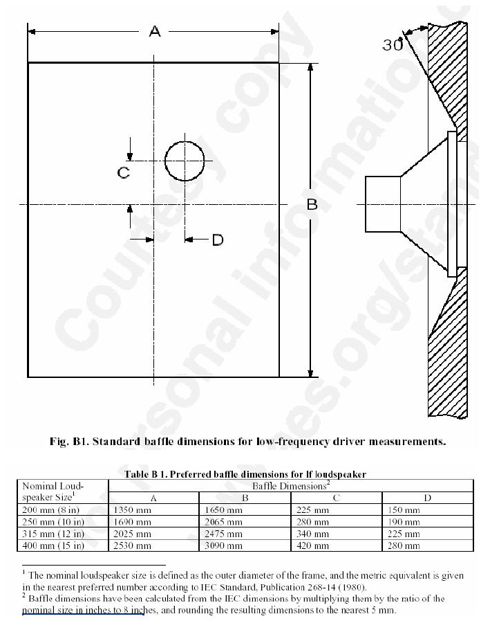

Hi Michael, John, everyone!
Measurements are done in IEC standard baffle for 8" driver, only the ribbon is flush mounted. Drawing attached for the people that aren't familiar with it.
Smoothing is 1/6th oct, brickwall. In any case, CSD plots can't be smoothed out, so they provide clues to what the manufacturer did to make other plots look nice. It will show if it was tampered with too much.
John, I couldn't agree more!
However...You know it better than I do, that polar plot will look as good as it's measurement baffle shape is, as well as driver's position on it.
We also know, that most people while browsing for a driver to buy, just have a glance at the plots and go on. What happens if they spot a big dip at 1k5? Would they contribute it to a measurement baffle size or to the driver? Will they read the fine print and a lenghty explanation why it is there? What will the polar plot look like when that edge diffraction dip start shifting around with measurement angle and even worse, multiply itself by the number of baffle edges as soon as you move the mike away from the dead center?
Naturally, I would like to present the driver at it's best, but in essence, you are actually suggesting that I should design the baffle shape solution, just like you had to do, to yield the best results with your new speaker. But then, would that shape fit the midrange that someone wants to use? Would it fit their taste in design?
Considering the above, and that I would like to make sure that the driver polar plots will not suffer from the baffle shape, the thing I should do is to measure the polar plots in IEC baffle, but then, they wouldn't really look like anything dipole, or at least, like anything that the user would get in their all-too-different baffles than than mine. Would that make me a liar? Would that situation of users getting different measurements by default than what I published, help in increasing or in decreasing the customer satisfaction in the future? Would RAAL drivers remain respectable in that case?
Whatever the thing may be, whether I'm right or wrong, my decision is that upon request, people that can read that data, will get the data acquired with IEC baffle. The success of the completed speaker itself, rests is upon them, so here it is, PDF attached.
The actual driver that has been measured is regular, closed 140-15D. I hope you will trust me on this, but the DIPOLE 140-15D spits out the same graphs in that same baffle.
I hope this helps and I hope it sheds some light on why driver manufacturers aren't jumping ahead and show all kinds of data by default. Too many misconceptions out there and the ones that possess them are the quickest to judge and tell about it.
Cheers!

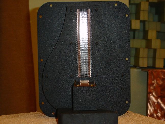

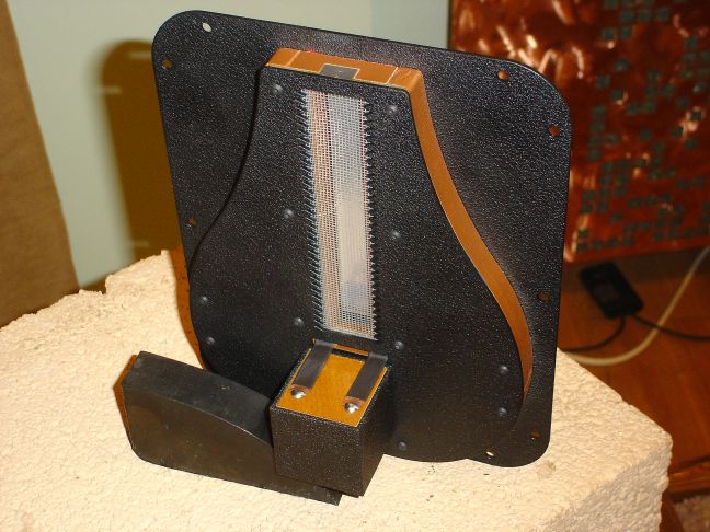

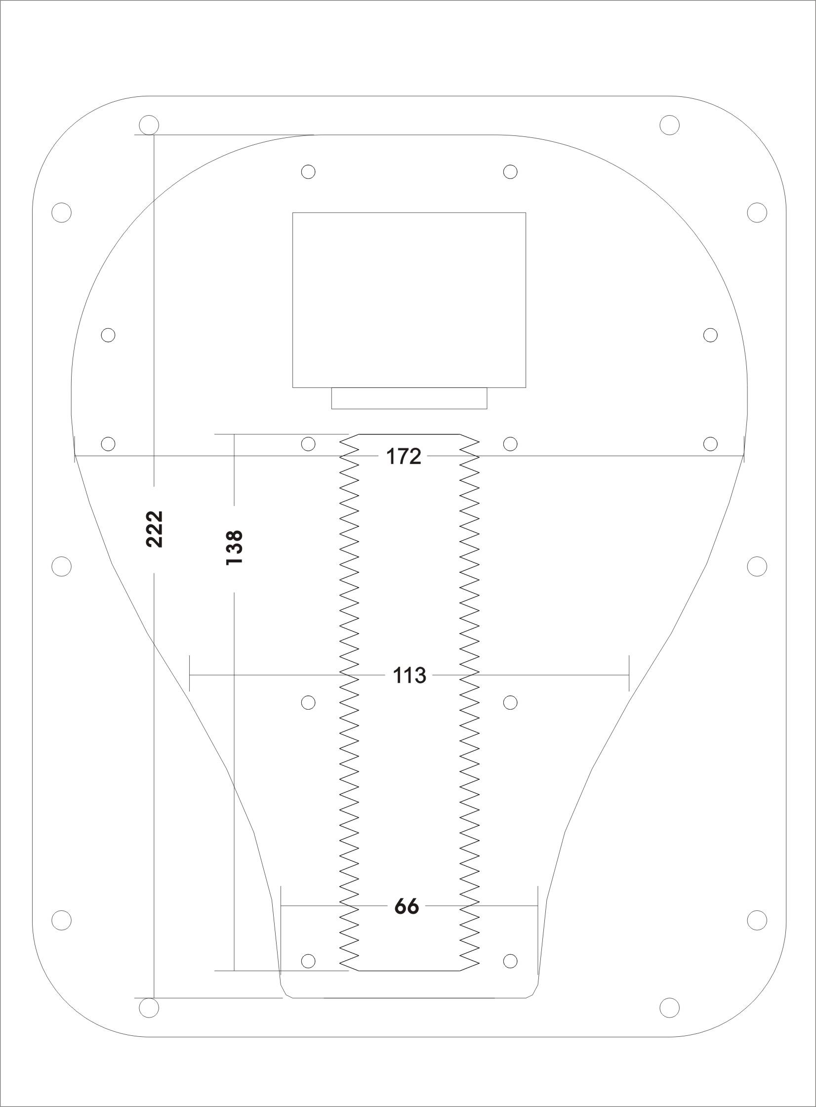

Rudolf, you're reading my mind. The design of the driver was made with having in mind the wish to use it as bare-naked as possible ( I'll tell my opinion of that a bit later). That throws us back to the question of what is the best baffle shape for linear sources like this one, and I, too, have an opinion of that. So...
In the attached pictures you can see what the driver looks like from behind.
The pear-shaped structure is the iron yoke that closes the magnetic flux. It was designed in FEM simulation and completely closes the flux with a minimal amount of iron. The iron thickness is 16mm. To that, add 2 + 2 mm of front and back plate.
The front plate is just a mounting flange and it also can be made having the same shape, or completely removed. If removed, the mounting will be a problem, but as it has always been, we make custom front plates without surcharge. If clients start asking frequently for that, I even might decide to redesign it and have it eventually offered as such.
Since this driver is not designed to be used lower than 1.6k, and the mean width of this "pear" allows for about 1k5 cut-off, the driver can be used without this rectangular front plate, without impeding it's low-end response.
That leaves us with this pear shaped yoke, which then plays the role of acoustic baffle, which I believe, is the best possible shape for linear radiators like ribbons. Also, this shape falls in line with this tendency to have double-circle figure-of-eight response extended as much as possible toward highs, but with maintaining the proper low-end (this is a contradictory demand and I'll turn to that later) and without creating too much dips and peaks in the response. It should be a tiny little bit better than naked Neo 3PDR :D.
Speaking in general now: I mean, c'mon, equidistant edge all around the active surface, are you kidding me?! Show me the naked Neo 3PDR polar plot, horizontal and vertical, please. Better yet, call BG and ask them to send you one. Gee...
later:
Now, to be honest, I never thought that developments of OB design will go towards pushing the ideal, double-circle figure-of-eight all the way up. By definition, you can't have it! Not even with naked Neo3PDR above 2k5. Well, you may get something of a sort, if the active surface size itself is large enough to start beaming, narrowing the kidney, but if it does, it will be frequency dependent and then what? Lobeing and further narrowing toward highs. Double-circle figure of eight is acheivable ONLY below the cut-off frequency of the baffle and that's that.
In short, you can't have double-circle dipole response if your baffle is wider than half of the wavelength at the frequency you are looking at.
Personally, even if it could be done the proper way, I consider it unnecessary, as RT60 times in any room can only have severe nonlinearity and prolongation below 300Hz, and in my book, figure-of-eight (OB woofers) serves as a problem solver in untreated, boomy-bass, rooms by decreasing the excitation of the room modes. I still don't see why it has to be pushed all the way up, as it will only decrease RT60 up there, too, maintaining the RT60 unbalance with low frequencies, solving nothing that OB was originally used for.
To me, whether you have a normal, wide baffle double-kidney or an ideal, double-circle, response of an OB speaker above 3k, isn't something that would make much of a difference, unless you live in one of those ultra-modern, designer apartments that I call "fish tanks" because of the way they sound, because idiots designed them, along with putting the damn kitchen wide open, right in the middle, so you could listen your cutlery rattle with bass and your microwave humming along behind you while you listen to your music waiting on your dinner. If you do live in one of those, my recommendation would be to turn to headphones and forget the high-end speakers based audio altogether, OB or not, and spend more time out of the fish tank.
In any case, you will still have a dipole response all the way up with a null on the side in wide OB's. The main thing is to have that back radiation that reflects from the back wall and gives excellent spatial cues for us to enjoy. A very good reading is Linkwitz's website, and I warmly recommend to anyone that hasn't read it, to do so. A couple of years ago, I've listened to his speaker in his home and from that experience, I can't see what's wrong with having wide baffles. It was THE best stereo imaging I've ever heard in my entire life, and luckily, managed to recreate it or exceed it in my listening room.
Anyway, that was my best shot in making a symmetrical true ribbon tweeter with the best vertical response of all ribbons of the same size out there, with 1k5 cut-off baffle with pretty good acoustical shape, with custom mounting flange when needed. I'm also preparing a small dipole driver, a version of 70-20XR that will be in free sale, not just to manufacturers, which my be better if small pear-shaped baffle ribbon would be better for those design requests mentioned earlier.

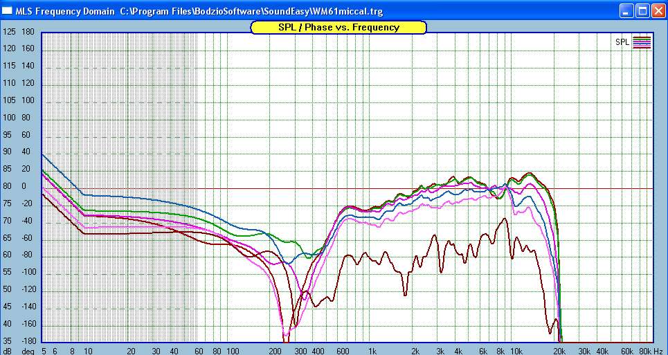

Although I've posted it elsewhere, it sounds like it might be appropriate here - the attached graph is the polar response of a neo3pdr, measured by me. The graphs are 0-15-30-45-60-90 degrees horizontally, with no baffle, and have almost an ideal dipolar response. The only blip is around 8kHz, and that can be mostly fixed by adding foam edging to the driver. JohnK has designed a waveguide that is also very successful. I've built and listened to a handful of dipole tweeters, and they've all had errors - but personally, I don't hear the 8kHz deviation. Most other dipolar tweeters have errors in the 1kHz-5kHz range, where our ears are most sensitive, and the error is very obvious. I've used the Neo3pdr crossed as low as 1700hz, LR4, and not had problems.
Aleksander, I really appreciate your thoughtful replies, and I admire the excellent construction of your tweeters. I hope you continue to be part of this discussion. I think we are all mature enough here to realize and accept each others biases, and still be part of a meaningful discussion.

Thank you, gents, I appreciate your welcome. I'll try to be useful, even though I'm coming from omnidirectional with OB woofers camp.
Of course, biased we all are, but we shouldn't forget that we're dealing with objectively measurable stuff and objectiveness will have to unleash us from of our biases once we accept the physical truth and compare it to definitions we claim to follow.
So let's talk principles and definitions we so easily throw around.
For example, cuibono, you do have a fairly nice result, but just at a first glance. It isn't anything near of what it should be.
Let's analyze those results in depth, and someone tell me if I'm wrong. I may be and/or the measurements may be wrong.
Definition: If I remember correctly, almost an ideal dipole response must have about -6 db at 45 degrees, -12 dB at 60 degrees and at least -24 at 90 degrees at all frequencies compared to dead on-axis. Correct me if this is untrue, I'm rusty in math department.
Measured result: That "almost ideal" you mentioned should read "+6 dB to the goal", which is double the energy. Doubling things, or adding 100%, is not a near miss. This happens between the crossover frequency to 6k, above which, things get rough.
Ideal dipole response does not account for such lobeing that manages to make 3dB more on 30 and 45 deg and +1dB at 60 deg. than on axis, turning a response with octave wide -6dB dip on axis into a response with 3dB peak at 60 degrees. That is about 12 to 15 dB more than the goal. That is quadrupling things, which again, can't be called a near miss.
Consequence:
The first reflection off the side wall, which is between 30 to 60 degrees, depending on the room size and speakers-listener layout within it, will on average between 6k to 10k, receive the same energy as your listening position. If anything gives spatial cues, that is this frequency band and if anything, dipole shouldn't do that.
Verdict:
Considering that below 6-7k, dipole is not nearly as fully functional, we can call it a moderate success to the goal that has been set. What we have here is a double-kidney equally obtainable with a wide baffle.
Considering that, centered at 8k, we have a cloverleaf pattern of two lobes front and two back, and depression of 3dB on axis, and that on average it has equal energy dispersion up to 45 degrees, falling off only 11 to 12 dB on average at 90 degrees, we can call it a failure.
9k is a very interesting point, as we have equal energy distribution with only 8-9dB drop at 90 degrees. I also suspect that there is a 45-ish degrees phase-shift break there that allows the 90 deg. 9k peak not to be canceled properly with back radiation. It may be due to slots resonance and/or spacing. Examination of anything that may fall into 38, 19 or 9.5 mm with driver's construction will provide a cause to problems between 6 to 10k.
If it is just edge diffraction related, it is correctable with a baffle/frame of enough width to allow for transposing the dip below the crossover frequency and framing the driver in such a way that the face plate becomes flush with frame front and back surface. If the baffle/frame does not have equidistant edges to the active driver surface (slots area), it may be possible to use the lesser width than what the crossover frequency suggests.
Considering that above 13k we have just simple beaming, but working exactly the dipole below baffle cut-off should, we can consider it a full success.
As far as the room interaction is concerned, all of the above is easily corrected with absorbers on side walls at the point of first reflection. If you don't already have them, that shouldn't be hard to do, so try it out and see what you should be aiming for. Let us know is it better. Follow the speaker-listener-room layout that Linkwitz suggested.
As for the audibility of -6dB at 8k, you certainly hear it, just don't know how to pinpoint it's attributes. A very good exercise is to use headphones and try tampering with any EQ from any media player on your computer.
