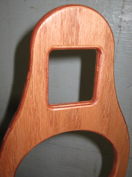

This is what my tweeter baffle looks like now. I don't have too much room on the back to try dowels, but I plan to get to that at some point.

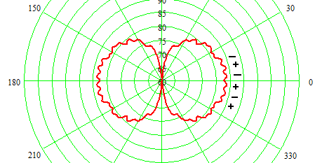

If you look at fig. 3.12 and 3.13 in conjunction with fig. 1.12, you see how the dipole pattern blooms into an increasing number of "petals" with alternating phase. When the dipole length increases, the blooming starts at lower frequencies - the dipole pattern can look like two interwoven daisy blossoms with many petals as shown below. I don't know if this is a good thing or bad.
Your toroid needs to separate the front and rear radiation of the dipole before the blossoming starts. Too early, and you get a premature beaming - too late, and you get too many side lobes. Probably you need to ask JohnK how he arrived at the right point. I guess that the waveguide can't get much deeper/wider than he did.
