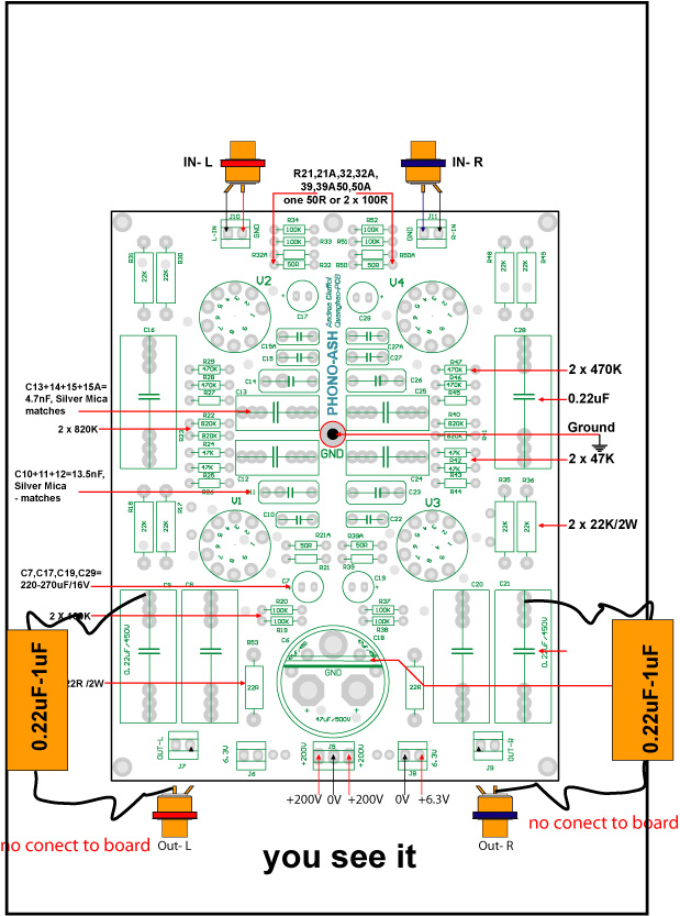

Hi, replaced the resistors in my phono but something is still not right, getting alot of background hum, and if I unplug the turntable from the input there is a very loud pulsing sound coming from the speakers, when i touch the ground of the left RCA input it cancels the pulsing but not the hum...not sure if it is coming from the sshv or the phono stage...I was hoping this was going to be an easy project, not so sure now..
i am use Mil spec components, someone suggested that I may have damaged Q4 the 2SK170, but if this was the case would i still get proper voltages on the output?
Any input is appreciated as I am still a newb here.

HI! q4 2sk170 in this case , not died , Because you still get 200v v-out!
Check all GND, and conect GND to the Turntable .
My be That phenomenon file. now lift your head out of the capacitor connected directly to the PCB and see Amplifier has been this phenomenon?
Hi Quang, Thats what I thought also about Q4, what I was wondering though is that although I am getting correct v-out could there be noise or oscillation coming from the SSHV. I donot have an occilloscope so I cannot tell if the oscillating noise is coming from SSHV or the phono stage. I donot understand what u mean about the capacitor could u please clarify, do I isolate one of the capacitors to see if the problem still exists.
Regards Jezza
Regards Jezza
Regards Jezza
You se that!
