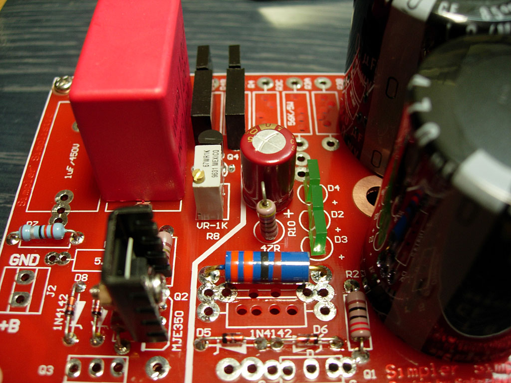

This is a shunt HV PCB Salas.
Sunday this week I will send for your pcb
quanghao
I got the pcb in perfect conditions
but I have question
The pads are not tinned or golded , so were others sources used to protect the pads against the oxidation ???
(pads are cooper coloured)
quanghao
but I have question
You probably can tin the pads yourself for extra protection.
Simple question: on the instructions of the board it looks like I am supposed to use a transformer NOT CT, but the board has three connection for transformer wire. I understood that the board include a bridge rectifier. What type of transformer should I use ? How to connect it ?

Populate only D10 and D12 and you can use a CT transformer. Leave D9 and D11 unpopulated.
If you use bridge rectifiers (for a transformer without CT), populate all D9 - D12, connect the 2 HV leads of the transformer to the 2 AC pads (the CT pad should not be connected!).

Another question: looking at the instructions, D1 is a 1N383B 150V 5A diode.
Is it correct ? I cannot find this component. Even if I google 1N383B I do not get anything.
5A ? Isn't a bit too much ?
Additionally, I am using the Solen Fastcap 1uF capacitors (630V) is this a good choice ?
Thanks,
Davide
You're welcome. In fact D1 is a 5 watt zener diode 1N5383B. It's there for protection of the IRF9610.
1n5383b
If you already have the Solen, whether it's good or not so good, there's no harm to use it. The most important thing is to make the shunt regulator work first. Try other caps afterwards to see if they work better or not.

yes you can use CT for the supply. no problem. but need 2 diode!
Thanks,
And I guess D1 is mounted off board, just between the pins of the IRF9610.
In case I cannot find 150 V, can I use two 75 V in series ?
D.
Don't put that there yet because Quanghao reported problems with it in his former layout. Let it work first without it, so you know it does OK, and if you got a spare mosfet in case it kills, put a single 150V 5A one if you find, straight underneath, short legs, with its anode on drain and cathode (stripe) towards source & Rset. If it kills for some reason, change mosfet and forget. Works in my build perfectly, works in two simulators also, but who knows in another layout or with two in series.
