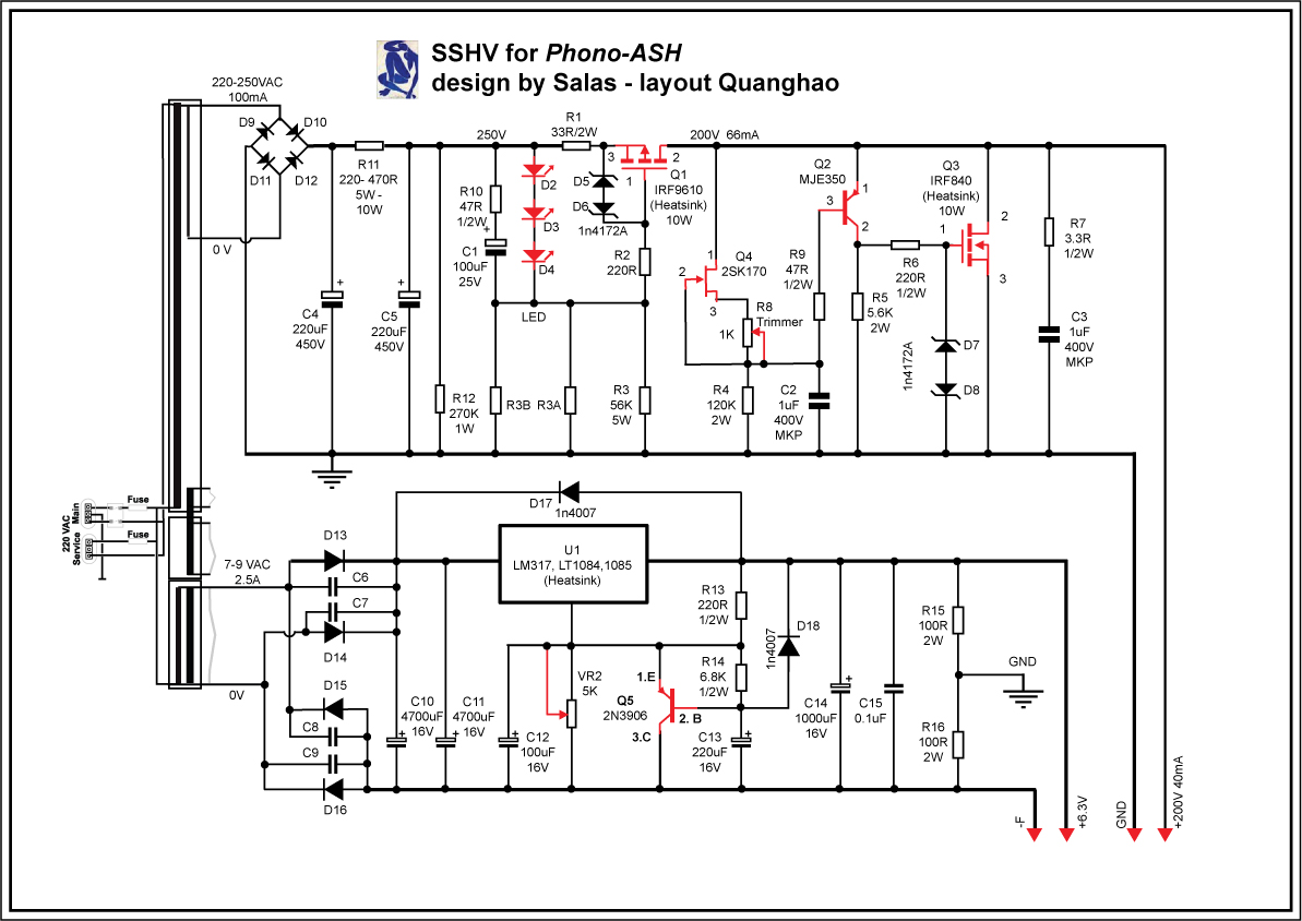

60 C , it is ok for 9610, 840R1 = 22r = 16V drop
R1 = 1k = 67V drop
R1 = 500R 20W= 35V drop = 65C
irf840 = 50C
irf9610 = 60C
I suppose i am going to
Is 60C ok for irf9610? or is it too high?
how many voltage drop Irf 9610??
And you AC = ???
yes , but my transformer is sitting at 57C due to all the wasted heat.
lm317 sitting at 75C
I am going to have to lower primary voltage or get different transformer
sigh
230V ac and 9v AC is WAY to high for this circuit.....
yes! 230vAC~290VDC, so R1= 50V, and 9610 = 40V drop, i calculate max for it!
and now i use that! You can down VAC min = 200V, so down R1, it is low

For heater you need min 7V since it is 9.87VDC-1.5V drop for diodes so you get 8.3. So then you will have minimum required drop for LM317 that is 2V.

200V Ac will give 282V dc That is still a 82V drop.
I think you can safely drop the 200Vac to 180Vac(254Vdc)
With 9Vac my lm317 is sitting at 75C which is too high. Using a 6.7c/w heatsink.
Long story short I will need to get a different transformer......
170Vac and 7Vac should do nicely
For now I am going to experiment with a 10ohm 50W resistor on the primary of the transformer to drop input and output voltages

Last night I experimented with putting a 60W light bulb in series with my transformer primary to drop the secondary voltages on both my 230V and 9V secondaries.
Even on 7.6V ac the 6.3V lm317 circuit did not work. I was only able to get out about 4.5V DC max.
I am going to do some more experimenting but it seems that it might need 8V AC minimum to be able to function. And with 9V the lm317 was hitting 75C in temp so I don't know?
What is the total current is drawn by the 4 heaters?
I will let you guys know as soon as I finish my testing today.
every tube heater current is about 320mA, tl. +/- 1,3A
I got mine running!
I dropped my input voltage a bit with a 150ohm resistor on the primarty of the transformer.
measurements:
AC input to powersupply
220V ac
8.5V ac
DC Voltage measurement over first 220uF 400V cap 265Vdc
i put my 220R 5W resistor back
DC voltage measurement over second 220uF 400V cap 249Vdc
voltage measurement over 2 x 4700uF 16V capacitors 8.5V dc ,the 8.5V seems a bit low. not entirely shure why this is ,but i will have to measure this with an oscilloscope to see how it varies.
6.3V is steady.
200V output is steady
all temperatures are in die low 40C
