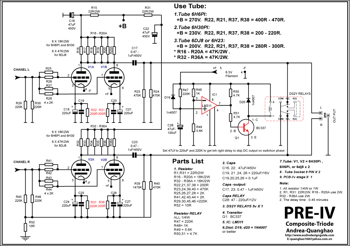

PM: And I use Salas Shunt HV for IV, the sound is excellent,
One test with 6h30pI or 6h6, I show the sound is very very natural. sound more realistic and very detailed. I think it fits the sound quality of the AD 1865. I can say I love 6h30.
Best regard!
Thank you!
Quanghao
Hi quanghao,
Is 6h30pi a direct replacement of 5687 or it needs some modification to the circuit? Thanks.
Hi quanghao,
No change direct it! you can use convert pin , form 5687 to 6h30
This is cricuit, Can use 6dj8 or 6h6, 6h30...

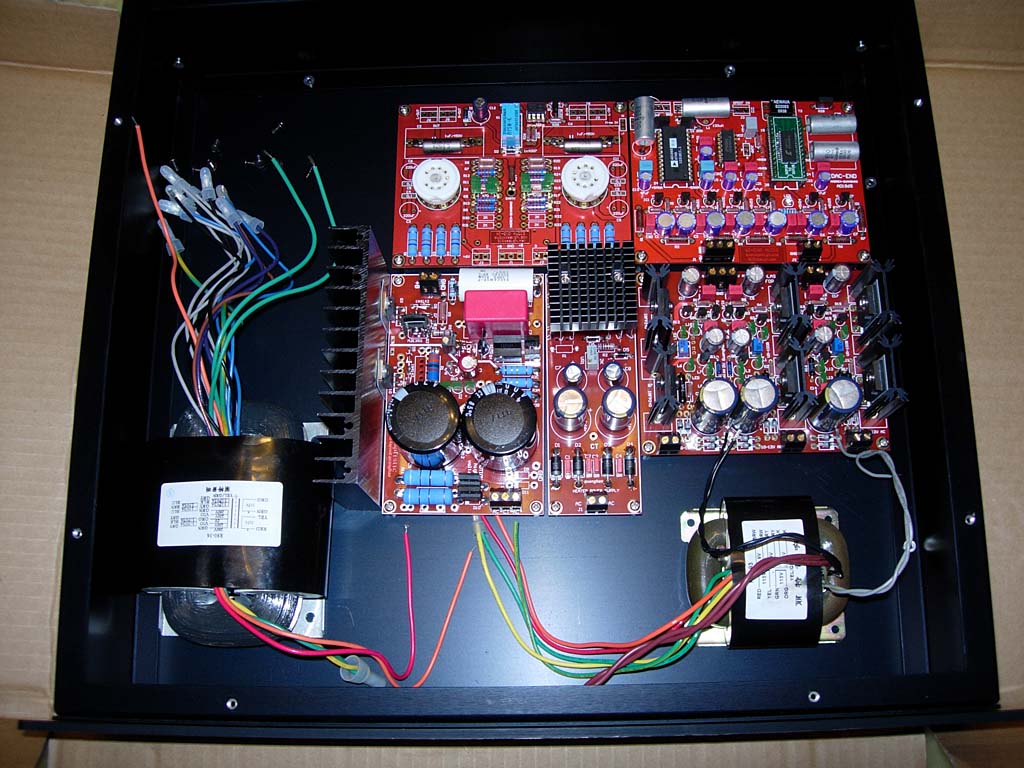

That's what I thought too, but I'm still getting 280Vac even with the load.
I finally fixed the problem with the LED not turning off when plug in to a CD. It was a cold solder on the CS8414 pins. I retouch the soldering and now I'm listening to music. Very cool! very nice Dac. I like the sound, as what everybody says. The only disadvantage is, it's HOT. My next plan is to incorporate a USB to SPDIF converter board so I can connect it to my laptop or desktop computer.
How about you Housing, is your Dac done?
Hi Fredlock,
Not yet. But the DAC, LV and HV shunt supply portions have been checked working in order.
This is the picture of my project completed so far. Just bought a chassis and it just fits.
Smells like this one will sound nice. Is that a Riken for Vref? Not best choice carbon. Enough ppm and self noise. Or is it a gate stopper?
Thanks Salas.
The 2W Riken is only used in the CCS, as circled in blue in the new photo. Is this OK or should I change it, for say, some Holco 1W in parallel?
The Vref resistors are circled in orange, 2 Vishay s104K 200K and 2 s102k 70K in parallel/series, with a resultant resistance of 135K. The temperature coefficient is only 5 ppm if I remember correctly.
The Vishays are an excellent choice in Vref. What the Riken does? Is it from LEDS to ground? Or is it a gate stopper? Or Iset?
Iset=33R, old used part in the bin box.
