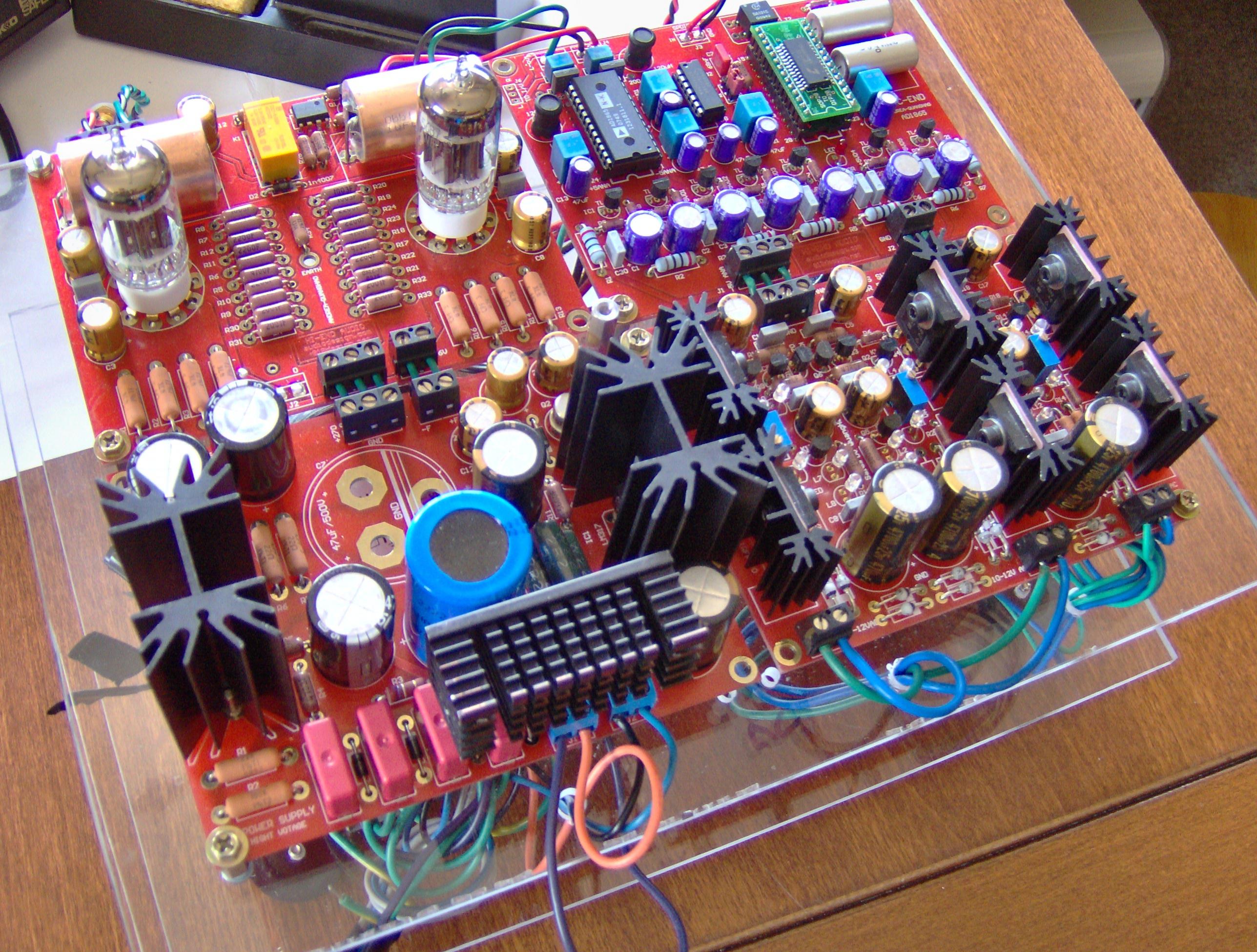

I thought I should post some pictures of my build.
I did as Adamus recomended and removed the inductors and added the "led-mod". I listened to the DAC standard and to me these mods made it suit my ears better.
I tried both E182CC and 5687 and prefer the E182CC. Also use Sprauge Hyrel Q 1µf output caps.
To me this DAC easily beat my old parallell tda1543 dac.
Thanks Quang hao, Andrea and Salas. Also thanks to everyone who contributed in this thread!

Here's the picture of my build. It's not singing yet because of a bad CS8414. I have to wait another week or so till I get the chip replacement. The transformers were located underneath.
