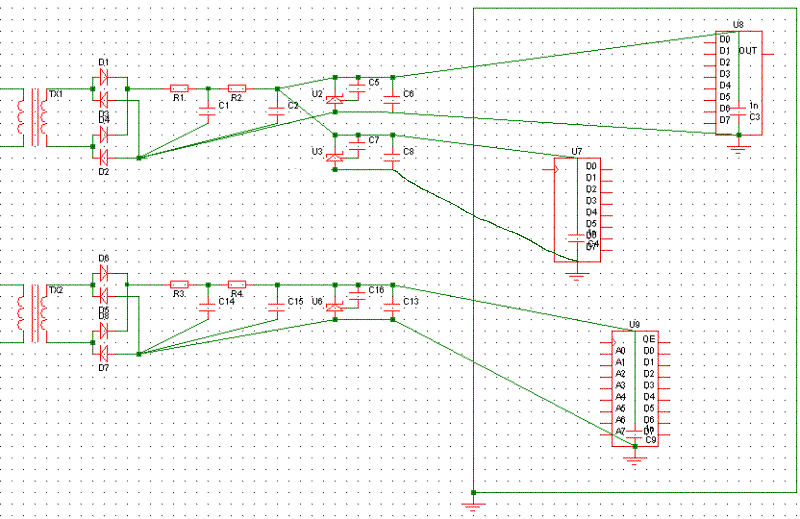

Here's another drawing.
Is this the correct layout? (of course, the prereg is missing)
The shunts will be placed close to the ICs; but still on a small separate board (since the main PCB isn't designed to house them)
When the prereg will be added, where will his ground go? To the most critics IC's ground, or to the gridge's ground?
Konnichiwa,
Pretty much so, with your added qualifications.
The answer of course is neither.
Remember, ask yourself where the current flows, the complete loop, the whole loop and nothing but....
For the whole powersupply in effect a "BUS" wire system applies up to the point where it feeds the actual circuit. I would retain a local star ground around the pre-regulator for the adj pin resistor and capacitor plus the output load and input bypass capacitor (if used), as this defines the local AC loops for the regulators.

Bricolo said:Here's another drawing.
Bricolo said:When the prereg will be added, where will his ground go? To the most critics IC's ground, or to the gridge's ground?
