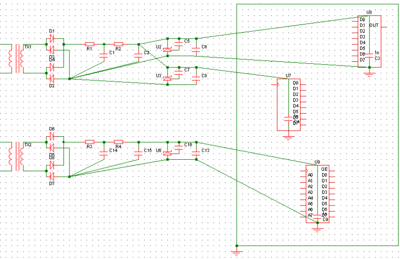

More on the power supplies.
Hi Thorsten
Please see Post #96 of this thread, if you have time.
I have tried to digest your power supply recommendations and adapt them to my application, and the parts I already have.
It would be great if you could have a quick look at my understanding of how to implement them.
I am unsure about the arrangement of the components and what to use as a final regulator.
1: Analogue output stage:- one dual opamp.
Use one 2*22Vac 25VA PCB torroidal TF. Use Schottky diodes to build recifiier bridge. This produces +/- 31Vdc. Pass this through 3R3 - 470uF - LM317/337 pre-reg - 10R - 4700uF - ????? final reg???
Use capacitors like Rubycon ZA/ZL throughout this supply.
Would Panasonic FC or Rubycon YXF be OK here for the higher values?
Use Audio Grade capacitors (Elna Silmic or Starget) at the output of the reg ie. the 4700uF cap??
Is Nichicon Muse KS also good for this?

Re: More on the power supplies.
Konnichiwa,
Nope, I'd go rectifier - 3R3 470uF 10R 4,700uF - Reg
Sure.
Large values on the output of LM317/1085 do not bring that much improvement, try 100uF each on adj to negative and on the output.
Maybe, never really worked with it. I like Elna Silmic best among "Audio" electrolytics and they are neither expensive nore hard to get.
Same as above. Stick to RCRC filtering and one Reg. Also, not so much voltage. Keep around 3 - 5V headroom, no more. So no more than 10V DC for the 5V supplies. All else equally applies.
See two previous posts, use Sanyo Os-Con in the Local decoupling and around the regulators.
I would omit any resistors, just rectifier and maybe 0.33R, then a big Cap (10,000uF ballpark), 1A (or better 3A) fixed voltage regulators and a large value cap on the output of the regulator.
Sure.
Never tried it, I think it's mostly important to have a high current supply separated from the rest of the circuitry.
Leave the original supply as is, large cap's only increase peak currents and reduce conduatcion angle and to only drive "administrative" functions of a CDP there is no benefit.
No, change in Philosophy.... ;-)
Sayonara
Thanks again Thorsten
OK - For the analogue stage (opamp) I'll use:
3R3(Carbon Film) - 470uF (Pana FC) - 10R(Carbon Film) - 4,700uF(Pana FC) - LM317/337 - 100uF(Silmic*2). Should I forget about the Pre-Reg/Final Reg arrangement?
LM6172/OPA2604/OPA2134 - Decoupled with 100uF(Silmic) - 100uF DC Blocking/Coupling(Nichicon Muse ES Bi-Polar). Are Silmics good for DC blocking as well?
Any other comments?
OK - For the analogue side of the dac I'll use:
Same RCRC as above and one Reg. Does "one Reg" mean:- one reg for all four analogue supplies to the dac; or:- forget about Pre-Regs and still consider one reg per suppliy pin on the dac?
The reason I went for the higher voltage tf is to allow for Pre Regs - but I gather you don't like that idea???
Should I use something like Elna Silmics for decoupling on the analogue side of the dac?

First, I would always use pre-regulators (317/1085) with LM/TL431 Shunt Regs.
Secondly, the shuntreg and bypass capacitors for each IC should combine at a local star, the ground pin of the IC.
One final "refinement", R1/R2 and R3/R4 can be split and distributed across the two supply lines, preferablyt using inductive wirewound resistors with added ferrite beads.
Sayonara
Bricolo said:Something like this?
Not really.
Sayonara

one pre reg per shunt, or one per secondary?
do you mean, the shunt+cap's ground should be placed at the chip's ground? so no direct connection to the bridge?
I don't understand the last one
Konnichiwa,
One per secondary.
Remember my mantra - look where current will flow....
You have your IC's, their grounds are joined via a Bus/Groundplane System. You have several pre-regulated, "clean" supplies you wish to feed to various Supply Nodes, in most cases individual per IC, meaning the negative supply to ground pin and the positive to the supply pin via a resistor/ccs, assuming the shunt regulator is locat to the Chip, where it belongs (otherwise it's > 100KHz bandwidth is wasted).
If you have several IC's to supply look at the one that pump's the most junk into the supply/ground loop and/or which requires the cleanest "ground" and attach the negative wire to the relevant chip's (hard to say which is more relevant) ground pin, then fan out individual resistors/ccs per chip to the positive supply pin's.
Allways thinbk of the circuit (chip) as posessing one positive and one negative power pin and as having one signal ground and several I/O Pin's. Sadly for us the signal ground and negative pin have usually been combined, be it in logic circuits or in Op-Amp's and single ended audio circuits.
However, you still CAN separate the supply current and signal current loops by having seperate supplies (galvanically seperate) per chip.
Clearer?

Fin said:Would it be worthwhile using the pre/post reg arrangement that you used in the CD63/67 TNT article - quoted below?
Maybe, probably not. In those days I failed to understand what really went on in supplies and hence followed the (arguably pretty reliably applicable) "bigger transformers, capacitors and more regs are good" credo. I have since learned that once you understand the goings on you can get "more with less".
Fin said:Maybe my use of the term; "banks of capacitors", was incorrect.
I understand it as using several smaller value capacitors in parallel instead of using one suitable value part of sufficient quality.
Fin said:For us "Dummies", this is between pins 4 and 8 on a dual opamp - and not from supply to ground?
You. Just try to think where the Op-Amp's ground pin is. Can't see it? It usually is the negative supply pin, but sometimes the positive supply pin. Only this current loop is essential for stability at high frequencies.
Fin said:Maybe I have used the wrong term here again! The original arrangement in the CD624 has a 100uF/16V Nichicon Muse Bi-Polar electrolytic directly in each output path from pins 1 and 7 from the NJM5532 opamp.
I need to find out more about cancelling offset.
It implies to introduce a direct current/voltage into the circuit in such a mannner that at the Audio Stages output the Output is held reliably at or close (enough) to 0V.
Fin said:I suppose what I am trying to ask here is: Which of the following two arrangements would be better, if I want to power the SAA7310 Decoder IC and the SAA7321 Bitstream DAC/Filter IC from one dual secondary transformer?
One supply for DAC digital, one for Decoder. Tap of the 5V supplies for the Analogue side of the DAC from the +/-15V supply of the Output Stage, using seperate regs directly of the raw rectified supply.
To be absolutely certain what should be consideredn analog and what digital and what pin's are noise sensitive one would have to go in detail through datasheet and apps notes, which I cannot find on the quick.
Fin said:You obviously feel that the SG (audio) Series is not necessary here?
Or apropriate.
Fin said:So - for decoupling around the DAC - I should remove the existing 33uF/16V electrolytics and the 100 nF SMD's. These should be replaced with Os-Cons (around 22uF - whatever fits neatly) and 10nF/0805 X7R and 100nF/0805 Z5U/Y5U??
If SMD's are in place, you may find they are okay to leave and to add a 10nF SMD directly at the chip Pin's (as close as you can get). Replace the existing 'lytics by Os-Con's.
Fin said:Is there any point in changing any of the opamps (NJM4560) in the servos?
Maybe, but doubtful. One would have to see the full schematic and details on the other integrated circuits to be certain.
Fin said:If the CD624 falls into this category - then I'm happy as I don't fancy messing with this.
I think yous has the old swingarm mechanism, a very nice drive but rather aged and yes, these do tend to require adjustment eventually, as not yet all adjustments where on-chip dynamically.
BTW, a final warning. What you are trying to do should IMHO really only be done by people with both substantial theoretical grounding in electronics and substantial practical experience. If you are in doubt about something - don't do it. Any of my comments and suggesting are basically aimed at qualified and experienced EE's, as I cannot see how people without this can truely understand what they are doing. If this limits the extend of your modifications, tough luck.
Sayonara
Thanks again, Thorsten, for the good advice.
The "Us Dummies" comment was only referring to myself and anyone else reading this thread who might find themselves on the same learning curve.
Also - I never said the op-amp had a ground pin - but thanks for the clarification.
I can send them to you if you like............................
So - where would one use Os-Con SG series?
I was hoping you would say that the existing SMD might be OK!
If the Vdd and Vss pins are not next to each other - but are on adjacent sides of the IC - what do you think of using an axial 10nF ceramic directly across the pins?
Again, I can send them to you if you like............................
Yes - it is a CDM4/19 - in mint condition - hardly used.
Thanks for the warning - I have taken note of it. Yes - it is my tough luck that I studied Chemisry instead of Electronics!
Or apropriate.
