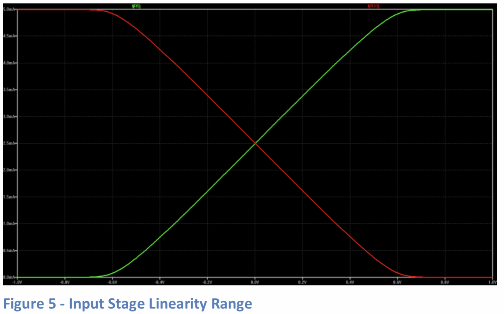

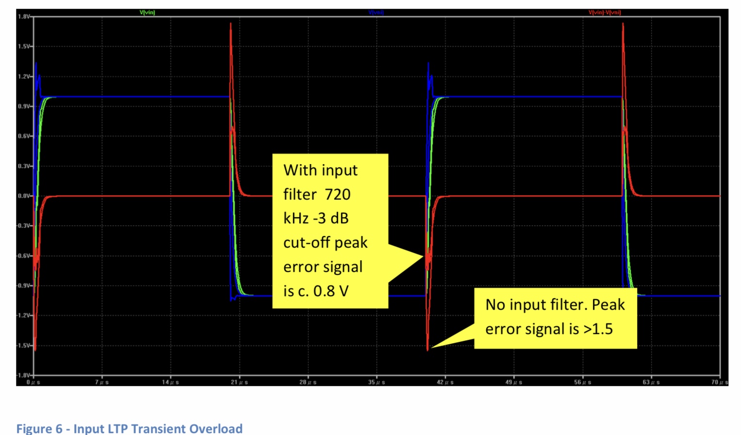

I’m surprised you think a LP filter on an amplifier input is cheating Hans!
I’d argue it’s a critical part of amplifier compensation and you get the added benefit of RFI reduction.
In a VFA, it limits the input LTP max differential and when used in conjunction with emitter degen ensures that the input stage remains operating in its linear region. For CFA power amps, you can also get the input stage to transition to class B with a very fast rise time signal. The input filter prevents that. You can’t use phase lead comp in a CFA (the zero at HF causes instability problems - but you know that anyway).
It is cheating. The LP filter does nothing to fix an improperly compensated amplifier. The input LP filter is there for a different purpose, to filter out RF ingress that may saturate the input stage.
Amplifier stability is a feedback loop property, the input LP filter is not in the feedback loop. It is true that some stability problems can be triggered by a fast input signal (a classic example would be phase inversion in very old op amps, which would, as a result, latch up toward a rail) but otherwise the input LP filter has no bearing with the amplifier intrinsic stability. If for example the amplifier becomes unstable when the output approaches the rails, then no input filter will help.

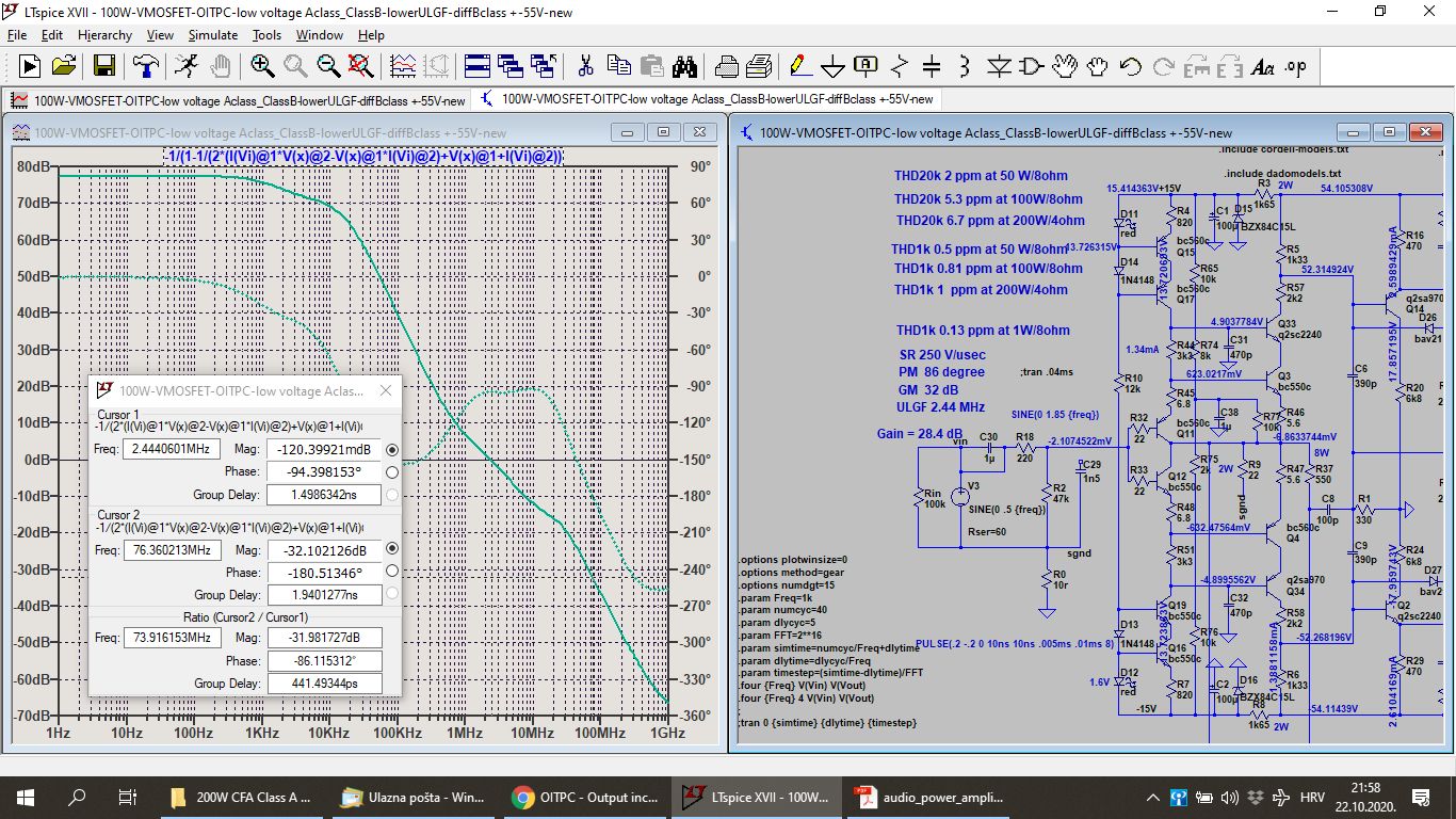

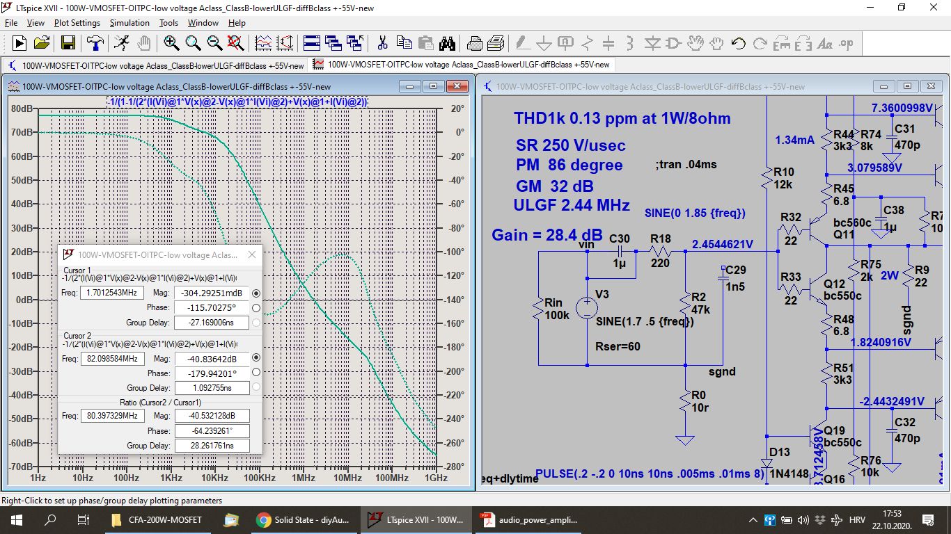

That is where OITPC shine. Attached LG plot with input filter disconnected and with DC offset of 1.7V(close to clipping) at the input.
And to my limited understanding, if you have a single pole the slope often starts in the audio band, and you have the 90deg in the audio band too. By implementing two (or more) poles, the slope can be moved higher, and there is less (or no) phase shift in the audio band?
The situation is like a balloon. Poke it one way and it will bulge in another. Compensation schemes are for achieving/improving stability. Better stability can be achieved but with often worse phase rotation within the audio band. Open loop bandwidth is really what determines phase performance. Then the trade off becomes gain vs phase shift. People chase fast input stages because subsequent stages must have lower speed in order to meet stability criteria.
Oh, that is surprise, correctly compensated , and did not accepted high ULGF and "Cherry" capacitor as stable amp until now.
I see 1.7MHz ULGF, which is still high, but not absurd, and a 2 pole shaped phase (which is not even conditional stable). I can not evaluate all the feedback loop in OITPC, and the results as shown do not characterize the overall stability. Otherwise said, my estimate is a "black box" estimate that is agnostic of the compensation method.
I never said OITPC is wrong, only that a) doesn't seem to have any advantage over any other 2 pole compensation ref. loop gain and phase margin, in an apple to apple comparison and b) the stability is not proven, considering only the stability of the major loop(s) is not even close to proof.
In general, I reject any results based on simulation, without a satisfactory detailed explanation on how this compensation works, the design backgrounds and the design rules to extrapolate it to other amplifier topologies. Otherwise, look at your own THD results above, 0.13ppm @1W/8ohm, you must be joking aren't you? You are showing 70 something dB loop gain @ 2KHz and 3KHz, meaning your simulated open loop amp has not more than 0.05% open loop distortions (2nd and 3rd harmonic) who are you trying to fool with this result?
I am sure you measured yourself this amp and confirmed the simulation results. Please don't quote Richard's measurements, I trust those less than a simulation.
If you are hoping for my endorsement for OITPC, please don't waste your time. You have a lot of work to make OITPC a serious solution (if at all) for compensanting an amplifier.

Who said anything about the amplifier becoming unstable at the rails? Or latch-up? Or that the filter fixes an improperly comp’d amp?
An amp gets comp’d to handle a certain BW and the filter is part of ensuring that.
