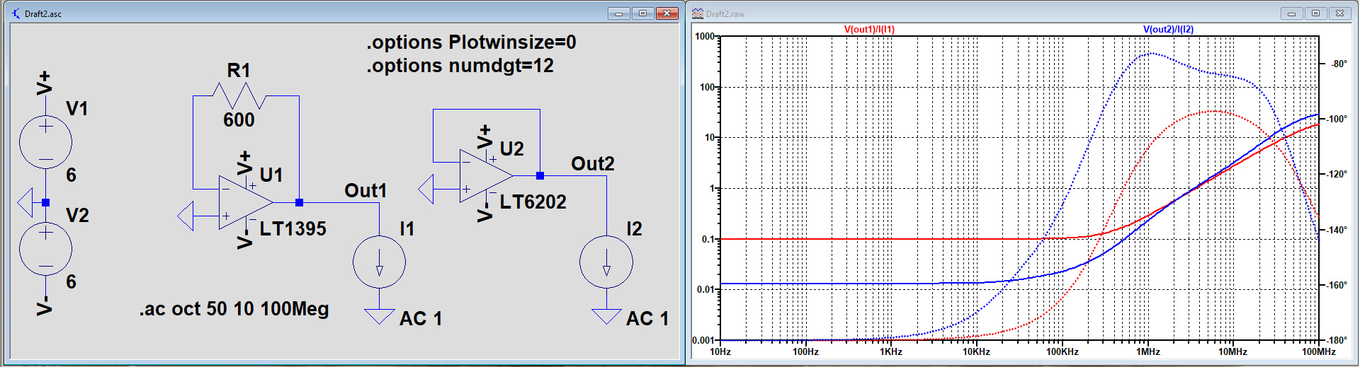

I tried a number of things around the LT1395 buffer.
Placing a VDVS in front of In+ to eliminate the source impedance made no difference to the earlier shown weird phase results.
But using a VDVS behind the LT1395's output resulted all at the sudden in a correct open loop phase behaviour.
Adding additional load from 10R up to 10Gig to the output of the LT1395 made no difference at all.
See both versions without and with load in the image below including the VDVS, both now with correct phase behaviour.
Source impedance of the buffer's input seems to play no role and loading it's output neither.
Here is some magic at work that I can't explain.
Either there is something very weird with the LT1395 model, or LTspice get's confused by whatever reason.

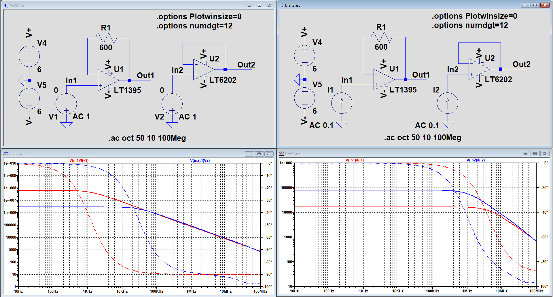

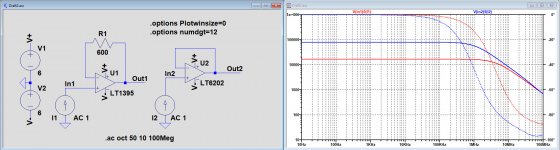

Can you please simulate a stand alone LT1395 buffer non inverting input and output impedances vs. frequency? Use the definition, in an AC analysis inject a current and read the voltage across. Sorry, I am not a LTSpice user.
Here they are, the output impedances for the LT1395 and for the LT6202 that where both used in my previous examples.
Hans

I don't understand your question, but when you ask for the LT1395 Netlist, I must disappoint you because that's hidden deep inside LTspice.

The input impedances look a little odd, 18k at LF is rather low even for a CFA. It is also rather odd that this actually works in the simulator, these are both bipolar devices and the input bias current has no path, it is quite large (10uA for the LT1395, 1.5uA for the LT6202) according to the data sheet, do these amplifiers bias correctly when determining the input impedance?

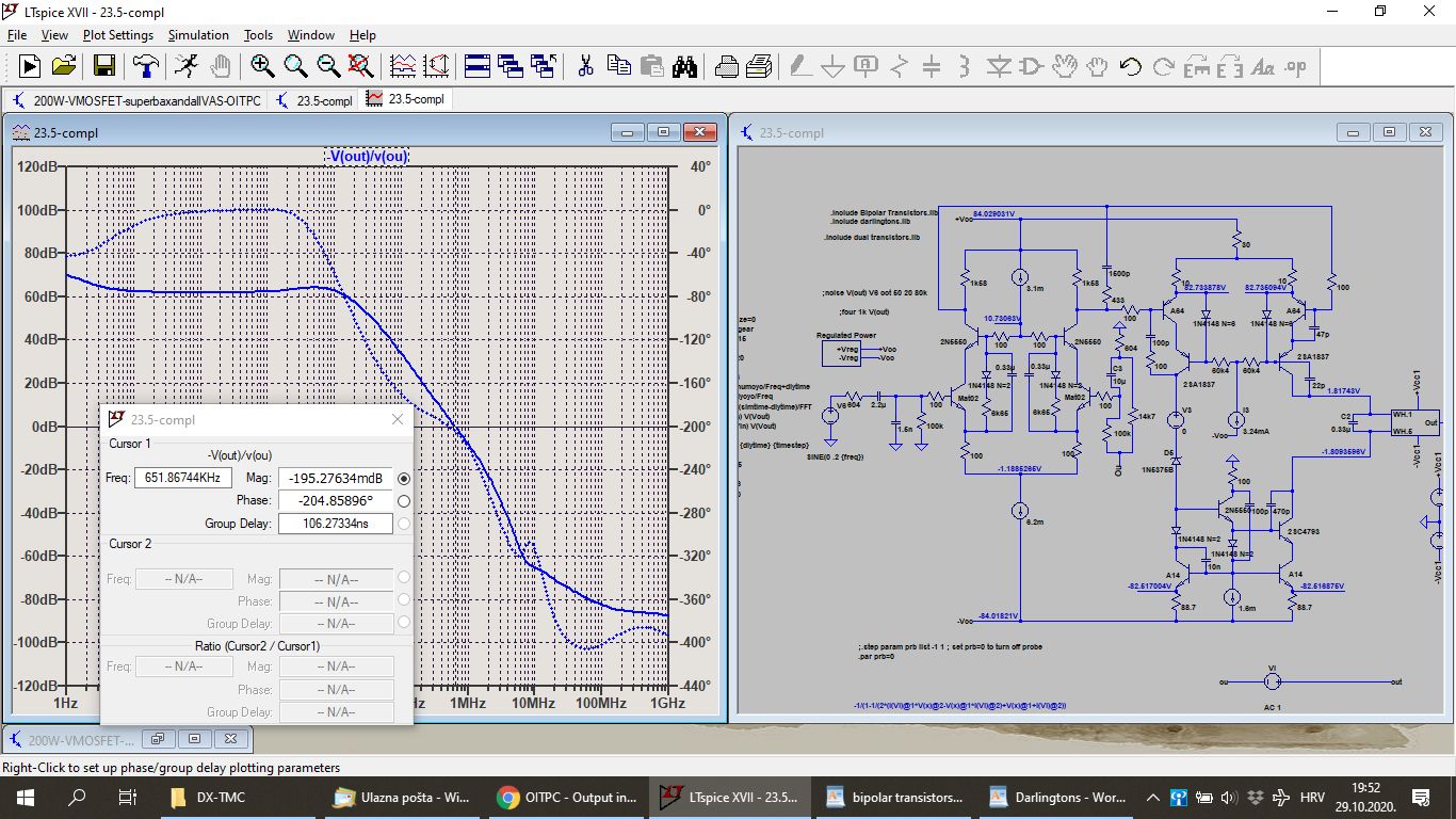

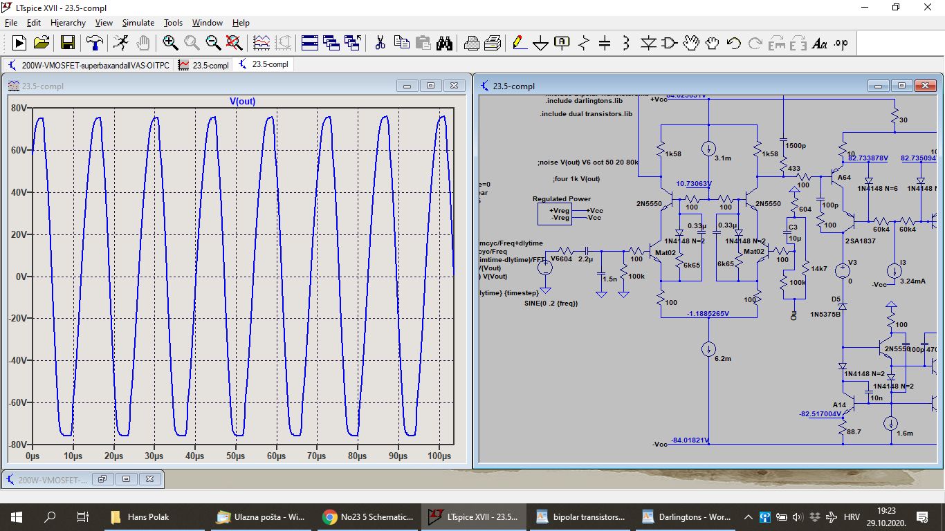

Hi Hans,
I spent some time with your .asc files
First I tried Loop Gain simulation using Tian probe and changing some transistors models for Corddel models in few steps and got similar result to yours, instability.
Then I simulated Close Loop Gain and tran, attached the plots.
There is something very strange with your sim schematic, I don't think it's LTspice problem.
CLG shows 26dB gain, but tran simulation with 0.2 Vp gives 76Vp at the output????
Damir

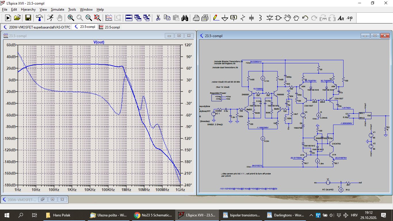

Assuming they somehow bias correctly, now a tougher one. In the original schematic, remove the Tian probe and try to reproduce the jumping loop gain phase using a less precise method (but which is good enough for 99% of cases). You probably know the trick, insert the AC voltage source in the feedback loop and calculate the magnitude and phase of the ratio between the output voltage (right end of the AC source) and the feedback loop input voltage (left end of the AC source). This method ignores the contribution of the current gains to the loop gain, which is again, acceptable in 99% of the amplifiers we deal with.
If the phase still looks incorrect without the VCVS (compare with the Tian probe result), then this is likely a device model issue (which I believe it is the case here). If the phase is now correct in both cases, then it is likely a LTSpice problem.
Attached, the same as with Tian probe.

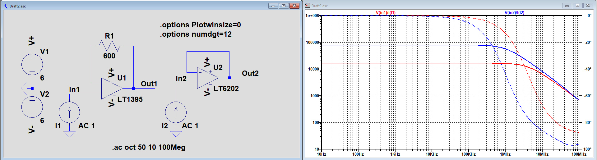

I think I'm getting mad.
Bias current is resp 3uA and 10uA for both amps, that seems reasonable.
BUT, I measured the input impedance now two times, one with Voltage sources and the other with Current sources.
Outcome should be the exactly same when measuring the input voltage and dividing it by the input current, right ?
Well they are not by a large margin.
See image below.
Hans

Hi Hans,
Damir
Hi Damir,
Thank you for taking the trouble to spend some time with the model.
Why do you think it's not an LTspice problem ?
It is to the slightest detail exactly the Mark Levinson 23.5, did you check the original PDF documentation ?
And when you put a 100pF cap to the upper Vas side and remove the lower 470pF, you have a perfectly working amp in LTspice, see again posting #183
OITPC - Output inclusive TPC (not TMC)
As mentioned in that posting I have tried this 100pF change on the real amp too, and it behaved almost exactly like the original version with the lower 470pF in THD, bandwidth and square wave response.
So for me it's an obvious direct or indirect LTspice problem for whatever reason.
Hans.

Originally Posted by syn08
Now a tougher one. In the original schematic, remove the Tian probe and try to reproduce the jumping loop gain phase using a less precise method (but which is good enough for 99% of cases). You probably know the trick, insert the AC voltage source in the feedback loop and calculate the magnitude and phase of the ratio between the output voltage (right end of the AC source) and the feedback loop input voltage (left end of the AC source). This method ignores the contribution of the current gains to the loop gain, which is again, acceptable in 99% of the amplifiers we deal with.

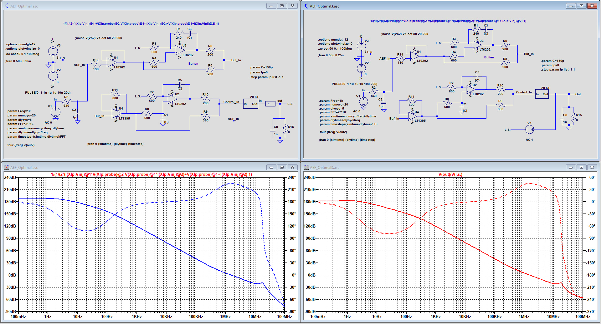

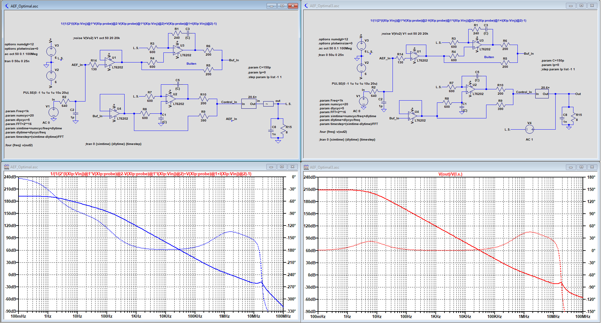

Here are the two different sims, to the left with Tian and to the right with a voltage source in the feedback loop.
Shape of the phase is exactly the same between both methods, but 180 degrees shifted.
I have also applied both loop gain methods to the version with the LT6202, and also here a 180 degrees phase shift but now with a different phase shape.
Hans
An 180 degrees phase shift is fine, after all the phase origin is not well defined, you always eventually have to normalize it.
The LT6202 results are definitely wrong, what LTSpice says is a physical impossibility.
Bottom line, crap models. You got what you payed for :D.
P.S. I fail to understand the unconditional trust in the Cordell models; as far as I can tell, they are pretty much stock models, without any extra advanced features, only corrected here and there for the obvious stupid parameters values, like Beta=8215, or VAF=2314V as sometimes included in the Mextram parameter extraction BS. In probably 99.9% of cases, if you get crap results with the original models, you will get the same with the Cordell models. At least when it comes to transient simulation, since little to nothing of the second order effects are modeled (quasi-saturation, etc...) not much (if any) results (like THD, clipping behavior, etc...) accuracy improvements should be expected by using the Cordell models.
