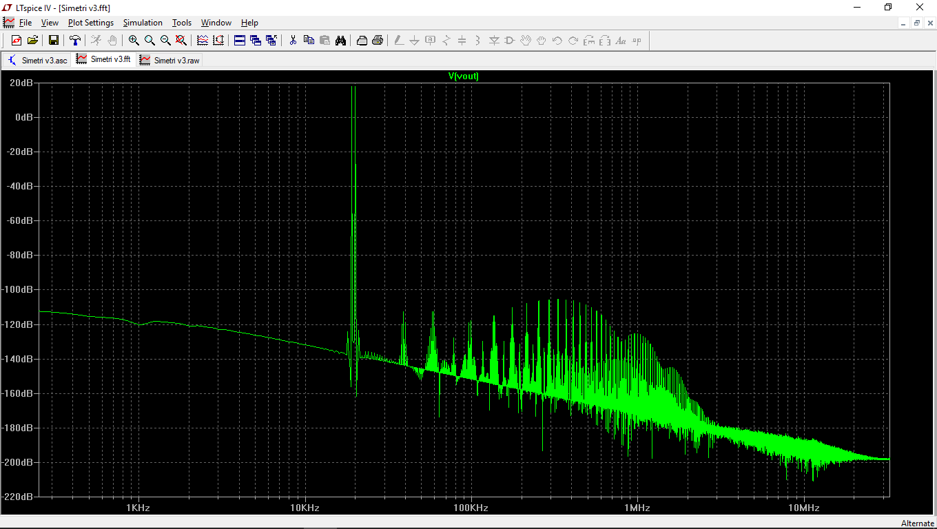

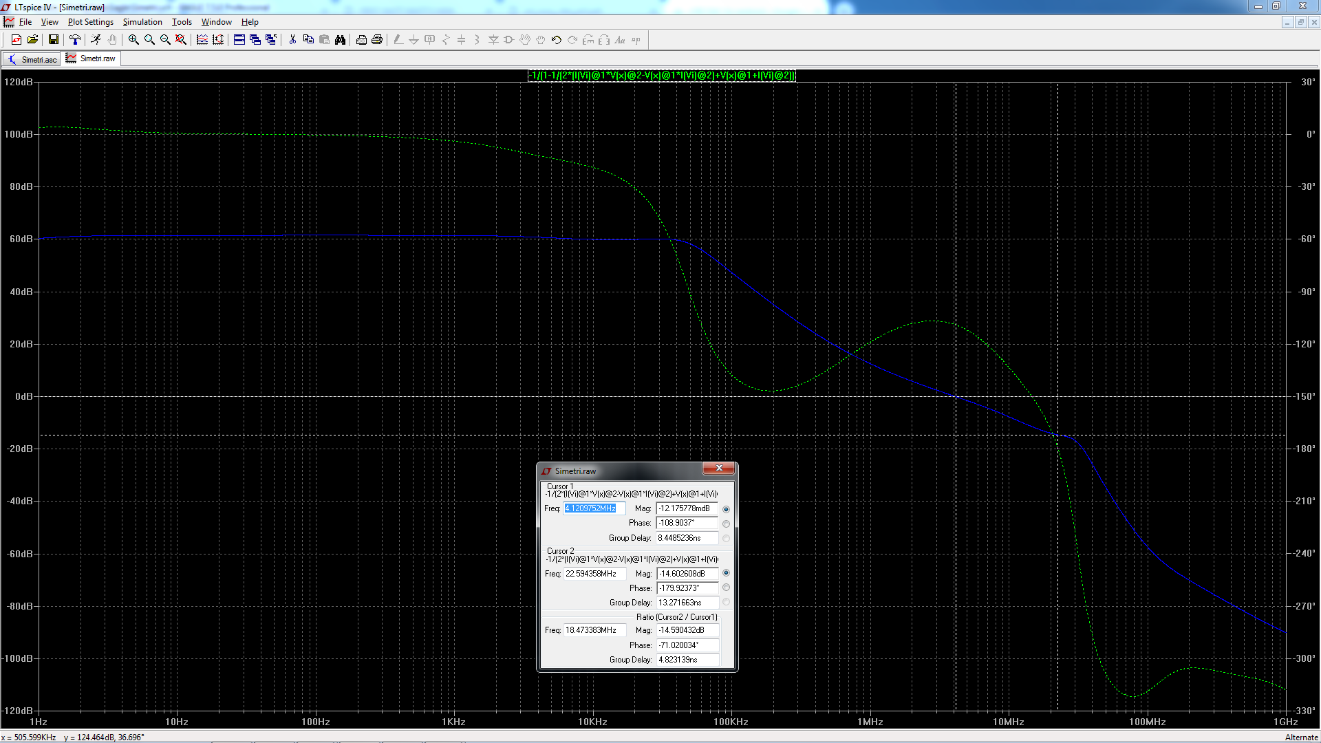

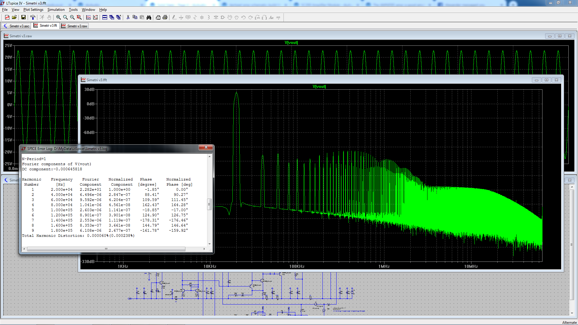

I sim symmetry topology using OITPC compensation. This is the loop gain. Are PM dan GM enough?
Using Miller compensation and lead compensation (Input Inclusive aka Douglas Self):
PM 71 GM 18
THD: 32W/8Ohm, 20kHz -> 0.001720%
THD: 8W/8Ohm, 20kHz -> 0.001887%
THD: 1W/8Ohm, 20kHz -> 0.003326%
SR 40
Using OITPC:
PM 71 GM 14
THD: 32W/8Ohm, 20kHz -> 0.002150%
THD: 8W/8Ohm, 20kHz -> 0.000783%
THD: 1W/8Ohm, 20kHz -> 0.000340%
SR 54

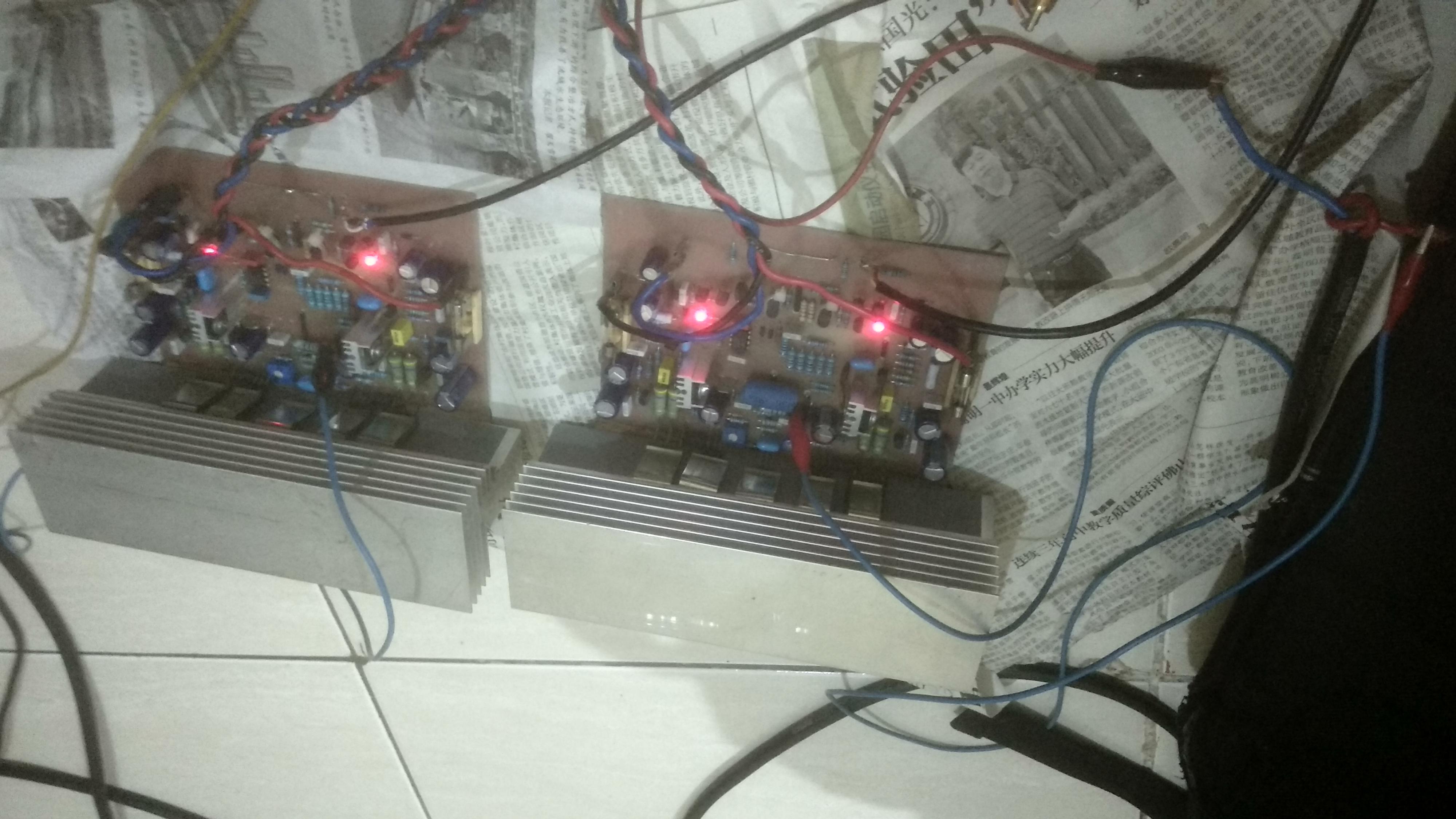

This is my CFA with OITPC which built by my friend. It use cheap components.
My listening impression compared with my amplifier using blameless topology with TMC compensation that use much more expensive components:
This CFA amplifier maybe the best amplifier that I ever heard when produce instruments attack time. Like live. Bass more punch but not deep. The high frequency less airy, with decay time less short.
Bias current for vertical mosfet is set to 150mA. Maybe next time we try higher bias current.
I made simple CFA base on Lazy Cat's VSSA but I added buffer before Lateral mosfet. It more airy than this CFA with OITPC.
I think this amplifier have great potential.

Bimo, in my opinion you described exactly what I noticed too with my OITPC amps (CFA or VFA). I think that is because of the open loop bandwidth goes up to 20 kHz or higher.
