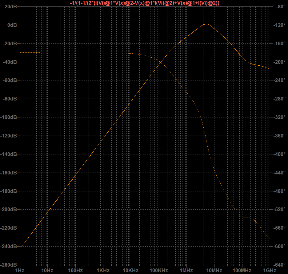

Here is the Tian probe in the C8 capacitor line.
Circuit is the same as Damir's pic. 3 from the first post (1k TPC resistor).
I still don't really understand this, in particular how LTspice calculates the phase.
I have seen this before but always skipped over it, this time I would like to sort it out.
Since the phase is hard to determine I am not even sure if the feedback is +ve or -ve for this loop.
Damir, Toni, Matthias, or anyone have any ideas?
Best wishes
David
Maybe this helps?
HarryDymond answered me a maybe similar probe problem here:
Yes, the position of the probe is correct, but it does not give the loop gain of the inner loop, if the outer loop is active. How can a feedback loop with a capacitor (of order pF) as the feedback element have almost 90 dB of gain at 1 Hz?
See this link:
2stageEF high performance class AB power amp / 200W8R / 400W4R
BR, Toni

I will reread that and think more
David, you know my opinion, outer loop gain will show if there is a problem...
Yes, we are in accord, your compensation looks fine.

I study the compensation. It seems much easier when use mosfet as output (may be high capacitance of the gate?). Sometime add resistor series with "cherry" capacitor make it look good in Bode diagram (PM and GM).
